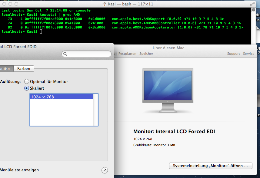

Kasi99 Posted September 30, 2012 Author Share Posted September 30, 2012 my data! DisplayProductID" = 0x717 DisplayVendorID" = 0x756e6b6e DisplayProductID dec 1815 DisplayVendorID dec 1970170734 Edid 00FFFFFF FFFFFF00 00001707 00000000 0A0A0101 0C1E17BE E82DC9A0 57479827 12484C00 00000101 01010101 01010101 01010101 01010000 00FE0053 52584661 6B654544 49440A20 01010101 01010101 01010101 01010101 01010101 01010101 01010101 01010101 01010101 01010101 01010101 01010101 01010101 0101005A my config <?xml version="1.0" encoding="UTF-8"?> <!DOCTYPE plist PUBLIC "-//Apple//DTD PLIST 1.0//EN" "http://www.apple.com/DTDs/PropertyList-1.0.dtd"> <plist version="1.0"> <dict> <key>DisplayProductID</key> <integer>1815</integer> <key>DisplayProductName</key> <string>Color LCD</string> <key>DisplayVendorID</key> <integer>1970170734</integer> <key>IODisplayEDID</key> <data> AP///////wAAABcHAAAAAAoKAQEMHhe+6C3JoFdHmCcSSEwAAAABAQEBAQEBAQEBAQEB AQEBAAAA/gBTUlhGYWtlRURJRAogAQEBAQEBAQEBAQEBAQEBAQEBAQEBAQEBAQEBAQEB AQEBAQEBAQEBAQEBAQEBAQEBAQEBAQEBAFo= </data> </dict> </plist> not work....graphicsEnabler=yes Blackscreen of internal display:( Link to comment https://www.insanelymac.com/forum/topic/283059-problemati-5430-no-resolution-qeci-108-hp-g72/page/2/#findComment-1856983 Share on other sites More sharing options...

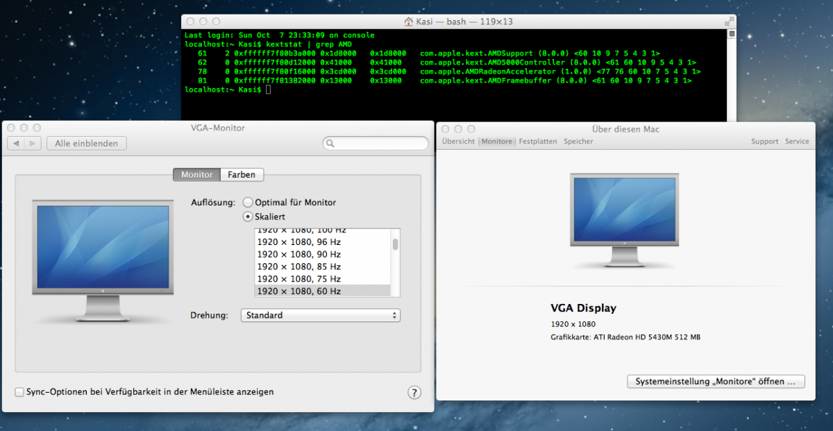

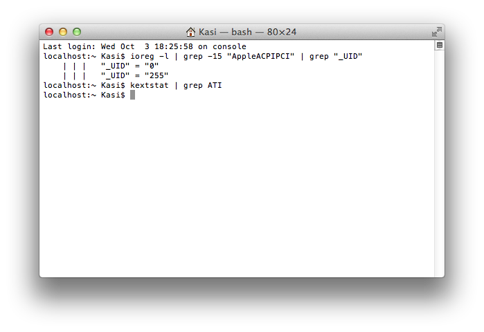

bocchama Posted October 3, 2012 Share Posted October 3, 2012 Hi Kasi99, This is the same thing that happened to me after I successfully installed Lion & Mountain Lion. with the vga port by using a external monitor everything is allright ! high resolution and QE/CI, it works well. only the intern display won't work!! I saw that you posted the same details on this topic http://www.insanelymac.com/forum/topic/208410-fixing-scrambledstretched-or-wrong-resolution-laptop-display-problems/ and you are on the right track. Basically, you need to perform a Force EDID so the display will come out from the Internal LCD screen. Read the details and you should be able to fix it. Below is the screenshot of my hackintosh Link to comment https://www.insanelymac.com/forum/topic/283059-problemati-5430-no-resolution-qeci-108-hp-g72/page/2/#findComment-1857757 Share on other sites More sharing options...

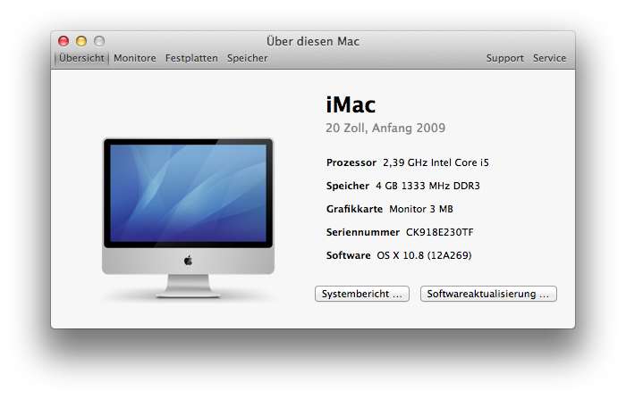

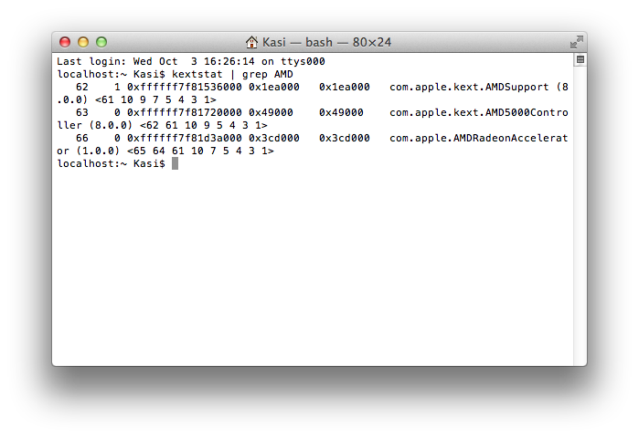

Kasi99 Posted October 3, 2012 Author Share Posted October 3, 2012 hello bochama !! thank you verry much for your support!! i have also done some screenshots and matched that with yours and what i`m seeing is, that on your screenshot is no ati kext loaded.!! when i installed the atiradeonx3000 in the S/L/E than im getting a bootloop. i integrated my Foce Edid in the DisplayProductID-717 and i read out my raw Data by using monilnfo under windows. I´m confused now, cause another user means the problem is still an other way !! but anybody answered my questions as yet and you are my last chance now !!!!! maybe yu can help me from the beginning and then step by step ! wich ati/amd kext should i install and wich of them can i erase ?? These are all of my kext under S/L/E: AMDRadeonAccelerator AMDRadeonVADriver AMDRadeonX3000GLDriver ATI2400Controller ATI2600Controller ATI3800Controller ATI4600Controller ATI4800Controller ATI5000Controller ATI6000Controller ATIFramebuffer ATIRadeonX2000 ATIRadeonX2000GA ATIRadeonX2000GLDriver ATIRadeonX2000VADriver ATISupport my english is not soo well, i hope you are patient to me !!! thankful greetings from kasi !! Link to comment https://www.insanelymac.com/forum/topic/283059-problemati-5430-no-resolution-qeci-108-hp-g72/page/2/#findComment-1857908 Share on other sites More sharing options...
meknb Posted October 3, 2012 Share Posted October 3, 2012 Hi Kasi The AtiSupport/Radeon ect are Used for Lion not Mountain lion. Mountain Lion uses AMDSupport ect Your edid you uploaded looks right but it looks like your AMDFramebuffer isn't loading. My kext's loaded are 76 2 0xffffff7f80d32000 0x1d8000 0x1d8000 com.apple.kext.AMDSupport (8.0.0) 77 0 0xffffff7f80f0a000 0x41000 0x41000 com.apple.kext.AMD5000Controller (8.0.0) 96 0 0xffffff7f81054000 0x3cd000 0x3cd000 com.apple.AMDRadeonAccelerator (1.0.0) 104 0 0xffffff7f81589000 0x13000 0x13000 com.apple.kext.AMDFramebuffer (8.0.0) So it looks like your frameBuffer is the problem.Not sure why ?? Sorry i couldn't be more help. Link to comment https://www.insanelymac.com/forum/topic/283059-problemati-5430-no-resolution-qeci-108-hp-g72/page/2/#findComment-1857989 Share on other sites More sharing options...

Kasi99 Posted October 4, 2012 Author Share Posted October 4, 2012 he name is ATIFramebuffer in S/L/E is but AMDFramebuffer! open the infoplist of the ATIFramebuffer, in the infoplist is name AMDFramebuffer hi roberx! i have all bootflags tried...not work! ( with GraphicsEnabler and no) ati config Eulemur, hoolock etc.! i have blackscreen with GraphicsEnabler! my Framebuffer is not loading! more ideas please? Link to comment https://www.insanelymac.com/forum/topic/283059-problemati-5430-no-resolution-qeci-108-hp-g72/page/2/#findComment-1858213 Share on other sites More sharing options...

Kasi99 Posted October 7, 2012 Author Share Posted October 7, 2012 Hi Meknb, i have not ideas more! with VGA high resolution and QE/CI! GraphicsEnabler=Yes! (without Framebuffer Settings in the boot.plist) Work!!! with Internal LCD of Notebook not works! with GraphicsEnabler=Yes Blackscreen! despite edid insert! i have RegistryDump uploaded! possibly find someone the error! look my screenshorts! Internal LCD max resolution 1024! greeting by Kasi RegistryDump.rar Link to comment https://www.insanelymac.com/forum/topic/283059-problemati-5430-no-resolution-qeci-108-hp-g72/page/2/#findComment-1859014 Share on other sites More sharing options...
meknb Posted October 8, 2012 Share Posted October 8, 2012 I think you may have to hex edit your AMDFrameBuffer to boot with internal screen is it ldvs?? Your connector type's are your problem i think the ones showing in your ioreg are 0x4 dvi ?? 0x10 vga 0x800 hdmi Have a look here http://www.insanelymac.com/forum/topic/252061-mobility-radeon-hd-4650full-resolution-with-qe-ci-working-on-internal-lvds-screen/ to dump your rom and get your connected displays. Also search around for redsock_bios_decoder. Hope this helps, good luck. Link to comment https://www.insanelymac.com/forum/topic/283059-problemati-5430-no-resolution-qeci-108-hp-g72/page/2/#findComment-1859262 Share on other sites More sharing options...
