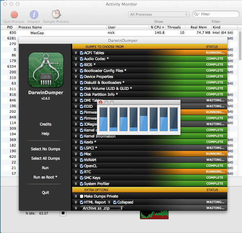

friscos Posted February 23, 2013 Share Posted February 23, 2013 I have a problem This program, which at times seems to work by releasing a regular html report, in most cases sends the block pc disproportionately overloading the CPU. Doing various tests, I found that starts the process of sysctl system with a cpu usage of 100% up to speed. The thing itself could also be resolved with a forced shutdown by monitoring resources, but alas it is unstoppable. The CPU load becomes unsustainable, then the inevitable reset the system. I also tried to start the process sysctl-a from the terminal as well as once you enter them if they do not quit. Someone else has the same problem? Does anyone have a logical explanation? In the web there is nothing about, or rather of sysctl is full of pages but nothing that refers to the crash Link to comment https://www.insanelymac.com/forum/topic/282794-darwindumper/page/4/#findComment-1891367 Share on other sites More sharing options...
blackosx Posted February 23, 2013 Author Share Posted February 23, 2013 Hi friscos DarwinDumper initiates the dumps in three stages of child processes, with each stage completing before the next stage is started, in an attempt not to completely render a system inoperable. When performing all dumps, I tried many different permutations to find which to run at the same time and which to run separately from another. If choosing to run a complete dump then yes, the system takes a big hit in performance but it should not cause a reset as OS X should manage the processes. Can you confirm your machine reset from running DarwinDumper or did you reset it yourself? Here's a screenshot of when it's running here. You can see the UI (aka MacGap) itself has a high CPU load. If you run a full set of dumps and leave it, does the process complete? For reference though, If you do ever have trouble and a DarwinDumper process appears to be hung, you can run top in Terminal while DarwinDumper is running you will see the individual processes running - they'll be from the COMMAND sh. If you want to kill any of these they you can look up the PID of the process and run the kill command followed by that PID. But be sure it's the correct PID otherwise you could kill another process. Link to comment https://www.insanelymac.com/forum/topic/282794-darwindumper/page/4/#findComment-1891460 Share on other sites More sharing options...
friscos Posted February 23, 2013 Share Posted February 23, 2013 this is the image after you close and reopen DarwinDumper 3 times with a single dump execute bit.....The fact is that the program does not end the procedure and remains locked impossible to stop the process sysctl also forcefully Link to comment https://www.insanelymac.com/forum/topic/282794-darwindumper/page/4/#findComment-1891469 Share on other sites More sharing options...
blackosx Posted February 23, 2013 Author Share Posted February 23, 2013 I missed this from your earlier post. So is your problem with sysctl? I also tried to start the process sysctl-a from the terminal as well as once you enter them if they do not quit. Someone else has the same problem? Does anyone have a logical explanation? If that does not complete then I guess you have a problem with your system somehow. Have you tried repairing disk permissions from within Disk Utility? As for DarwinDumper, the only time sysctl is run is to perform the Kernel Information dump when it runs: sysctl -a | grep cpu sysctl -a | grep hw Can you try a test for me please? Launch DarwinDumper, untick Kernel Information and then click run. Do the scripts and process complete now? Link to comment https://www.insanelymac.com/forum/topic/282794-darwindumper/page/4/#findComment-1891482 Share on other sites More sharing options...

friscos Posted February 23, 2013 Share Posted February 23, 2013 If that does not complete then I guess you have a problem with your system somehow. Have you tried repairing disk permissions from within Disk Utility? As for DarwinDumper, the only time sysctl is run is to perform the Kernel Information dump when it runs: sysctl -a | grep cpu sysctl -a | grep hw Can you try a test for me please? Launch DarwinDumper, untick Kernel Information and then click run. Do the scripts and process complete now? now works I think the problem is the port configuration usb3 in bios, thanks for your interest sysctl -a | grep cpu Last login: Sat Feb 23 21:58:07 on ttys001 localhost:~ asu$ sysctl -a | grep cpu hw.ncpu = 4 hw.cpufrequency = 3309000000 hw.availcpu = 4 kern.setthread_cpupercent: 0 hw.ncpu: 4 hw.activecpu: 4 hw.physicalcpu: 2 hw.physicalcpu_max: 2 hw.logicalcpu: 4 hw.logicalcpu_max: 4 hw.cputype: 7 hw.cpusubtype: 4 hw.cpu64bit_capable: 1 hw.cpufamily: 526772277 hw.cpufrequency: 3309000000 hw.cpufrequency_min: 3309000000 hw.cpufrequency_max: 3309000000 hw.cputhreadtype: 1 machdep.cpu.max_basic: 13 machdep.cpu.max_ext: 2147483656 machdep.cpu.vendor: GenuineIntel machdep.cpu.brand_string: Intel® Core™ i3-3220 CPU @ 3.30GHz machdep.cpu.family: 6 machdep.cpu.model: 58 machdep.cpu.extmodel: 3 machdep.cpu.extfamily: 0 machdep.cpu.stepping: 9 machdep.cpu.feature_bits: 3219913727 1033561023 machdep.cpu.leaf7_feature_bits: 641 machdep.cpu.extfeature_bits: 672139520 1 machdep.cpu.signature: 198313 machdep.cpu.brand: 0 machdep.cpu.features: FPU VME DE PSE TSC MSR PAE MCE CX8 APIC SEP MTRR PGE MCA CMOV PAT PSE36 CLFSH DS ACPI MMX FXSR SSE SSE2 SS HTT TM PBE SSE3 PCLMULQDQ DTES64 MON DSCPL VMX EST TM2 SSSE3 CX16 TPR PDCM SSE4.1 SSE4.2 POPCNT PCID XSAVE OSXSAVE TSCTMR AVX1.0 F16C machdep.cpu.leaf7_features: RDWRFSGS SMEP ENFSTRG machdep.cpu.extfeatures: SYSCALL XD EM64T LAHF RDTSCP TSCI machdep.cpu.logical_per_package: 16 machdep.cpu.cores_per_package: 8 machdep.cpu.microcode_version: 22 machdep.cpu.processor_flag: 1 machdep.cpu.mwait.linesize_min: 64 machdep.cpu.mwait.linesize_max: 64 machdep.cpu.mwait.extensions: 3 machdep.cpu.mwait.sub_Cstates: 4384 machdep.cpu.thermal.sensor: 1 machdep.cpu.thermal.dynamic_acceleration: 0 machdep.cpu.thermal.invariant_APIC_timer: 1 machdep.cpu.thermal.thresholds: 2 machdep.cpu.thermal.ACNT_MCNT: 1 machdep.cpu.thermal.core_power_limits: 0 machdep.cpu.thermal.fine_grain_clock_mod: 1 machdep.cpu.thermal.package_thermal_intr: 1 machdep.cpu.thermal.hardware_feedback: 0 machdep.cpu.thermal.energy_policy: 0 machdep.cpu.xsave.extended_state: 7 832 832 0 machdep.cpu.arch_perf.version: 3 machdep.cpu.arch_perf.number: 4 machdep.cpu.arch_perf.width: 48 machdep.cpu.arch_perf.events_number: 7 machdep.cpu.arch_perf.events: 0 machdep.cpu.arch_perf.fixed_number: 3 machdep.cpu.arch_perf.fixed_width: 48 machdep.cpu.cache.linesize: 64 machdep.cpu.cache.L2_associativity: 8 machdep.cpu.cache.size: 256 machdep.cpu.tlb.inst.small: 64 machdep.cpu.tlb.data.small: 64 machdep.cpu.tlb.data.large: 32 machdep.cpu.tlb.shared: 512 machdep.cpu.address_bits.physical: 36 machdep.cpu.address_bits.virtual: 48 machdep.cpu.core_count: 2 machdep.cpu.thread_count: 4 localhost:~ asu$ sysctl - un | grep hw Last login: Sat Feb 23 22:00:02 on ttys000 localhost:~ asu$ sysctl -a | grep hw hw.machine = x86_64 hw.model = iMac8,1 hw.ncpu = 4 hw.byteorder = 1234 hw.physmem = 2147483648 hw.usermem = 1551183872 hw.pagesize = 4096 hw.epoch = 0 hw.vectorunit = 1 hw.busfrequency = 100000000 hw.cpufrequency = 3309000000 hw.cachelinesize = 64 hw.l1icachesize = 32768 hw.l1dcachesize = 32768 hw.l2settings = 1 hw.l2cachesize = 262144 hw.l3settings = 1 hw.l3cachesize = 3145728 hw.tbfrequency = 1000000000 hw.memsize = 8589934592 hw.availcpu = 4 net.link.ether.inet.apple_hwcksum_tx: 1 net.link.ether.inet.apple_hwcksum_rx: 1 hw.ncpu: 4 hw.byteorder: 1234 hw.memsize: 8589934592 hw.activecpu: 4 hw.physicalcpu: 2 hw.physicalcpu_max: 2 hw.logicalcpu: 4 hw.logicalcpu_max: 4 hw.cputype: 7 hw.cpusubtype: 4 hw.cpu64bit_capable: 1 hw.cpufamily: 526772277 hw.cacheconfig: 4 2 2 4 0 0 0 0 0 0 hw.cachesize: 8053063680 32768 262144 3145728 0 0 0 0 0 0 hw.pagesize: 4096 hw.busfrequency: 100000000 hw.busfrequency_min: 100000000 hw.busfrequency_max: 100000000 hw.cpufrequency: 3309000000 hw.cpufrequency_min: 3309000000 hw.cpufrequency_max: 3309000000 hw.cachelinesize: 64 hw.l1icachesize: 32768 hw.l1dcachesize: 32768 hw.l2cachesize: 262144 hw.l3cachesize: 3145728 hw.tbfrequency: 1000000000 hw.packages: 1 hw.optional.floatingpoint: 1 hw.optional.mmx: 1 hw.optional.sse: 1 hw.optional.sse2: 1 hw.optional.sse3: 1 hw.optional.supplementalsse3: 1 hw.optional.sse4_1: 1 hw.optional.sse4_2: 1 hw.optional.x86_64: 1 hw.optional.aes: 0 hw.optional.avx1_0: 1 hw.optional.rdrand: 0 hw.optional.f16c: 1 hw.optional.enfstrg: 1 hw.cputhreadtype: 1 machdep.pmap.hashwalks: 1215256 localhost:~ asu$ Kernel Boot Messages PMAP: PCID enabled PMAP: Supervisor Mode Execute Protection enabled Darwin Kernel Version 12.2.0: Sat Aug 25 00:48:52 PDT 2012; root:xnu-2050.18.24~1/RELEASE_X86_64 vm_page_bootstrap: 1887334 free pages and 62362 wired pages kext submap [0xffffff7f80741000 - 0xffffff8000000000], kernel text [0xffffff8000200000 - 0xffffff8000741000] zone leak detection enabled standard timeslicing quantum is 10000 us standard background quantum is 2500 us mig_table_max_displ = 74 TSC Deadline Timer supported and enabled Refusing new kext com.apple.driver.AppleRTC, v1.5: already have prelinked v1111.0. corecrypto kext started! Running kernel space in FIPS MODE Plist hmac value is 735d392b68241ef173d81097b1c8ce9ba283521626d1c973ac376838c466757d Computed hmac value is 735d392b68241ef173d81097b1c8ce9ba283521626d1c973ac376838c466757d corecrypto.kext FIPS integrity POST test passed! corecrypto.kext FIPS AES CBC POST test passed! corecrypto.kext FIPS TDES CBC POST test passed! corecrypto.kext FIPS SHA POST test passed! corecrypto.kext FIPS HMAC POST test passed! corecrypto.kext FIPS ECDSA POST test passed! corecrypto.kext FIPS DRBG POST test passed! corecrypto.kext FIPS POST passed! NullCPUPowerManagement::init: properties=0xffffff8010334a40 IntelCPUMonitor: Based on code by mercurysquad, superhai ©2008 User defined TjMax=0 NullCPUPowerManagement::start AppleACPICPU: ProcessorId=1 LocalApicId=0 Enabled AppleACPICPU: ProcessorId=2 LocalApicId=2 Enabled AppleACPICPU: ProcessorId=3 LocalApicId=1 Enabled AppleACPICPU: ProcessorId=4 LocalApicId=3 Enabled calling mpo_policy_init for TMSafetyNet Security policy loaded: Safety net for Time Machine (TMSafetyNet) calling mpo_policy_init for Sandbox Security policy loaded: Seatbelt sandbox policy (Sandbox) calling mpo_policy_init for Quarantine Security policy loaded: Quarantine policy (Quarantine) Copyright © 1982, 1986, 1989, 1991, 1993 The Regents of the University of California. All rights reserved. MAC Framework successfully initialized using 16384 buffer headers and 10240 cluster IO buffer headers IOAPIC: Version 0x20 Vectors 64:87 ACPI: System State [s0 S3 S4 S5] PFM64 (36 cpu) 0xf80000000, 0x80000000 [ PCI configuration begin ] IntelCPUMonitor: CPU family 0x6, model 0x3a, stepping 0x9, cores 2, threads 4 IntelCPUMonitor: Using efi IntelCPUMonitor: BusClock=100MHz FSB=401MHz IntelCPUMonitor: Platform string k62 IntelCPUMonitor: CPU0 Tjmax 105 IntelCPUMonitor: CPU1 Tjmax 105 console relocated to 0xf80000000 PCI configuration changed (bridge=2 device=2 cardbus=0) [ PCI configuration end, bridges 6 devices 10 ] mbinit: done [64 MB total pool size, (42/21) split] Pthread support ABORTS when sync kernel primitives misused rooting via boot-uuid from /chosen: E86D55E9-1F82-3014-81DF-02C191E72E99 Waiting on IOProviderClassIOResourcesIOResourceMatchboot-uuid-media com.apple.AppleFSCompressionTypeZlib kmod start com.apple.AppleFSCompressionTypeDataless kmod start com.apple.AppleFSCompressionTypeZlib load succeeded com.apple.AppleFSCompressionTypeDataless load succeeded identified as RTL8168F/8111F Got boot device = IOService:/AppleACPIPlatformExpert/PCI0@0/AppleACPIPCI/SAT0@1F,2/AppleAHCI/SPT0@0/IOAHCIDevice@0/AppleAHCIDiskDriver/IOAHCIBlockStorageDevice/IOBlockStorageDriver/ST3500413AS Media/IOFDiskPartitionScheme/Untitled 2@2 BSD root: disk0s2, major 1, minor 2 Kernel is LP64 USBMSC Identifier (non-unique): AA00000000002054 0x90c 0x1000 0x1100 USBMSC Identifier (non-unique): 001CC0C61190BCC0632C0094 0x951 0x1693 0x110 USBMSC Identifier (non-unique): 0x5e3 0x702 0x33 Controller: Intel (Unknown) (vendor ID: 8086, device ID: 1e20) [iOBluetoothHCIController][start] -- completed Previous Shutdown Cause: 3 Natit: Starting. Natit: Found device with ID=0x0152 DSMOS has arrived VoodooPS2SynapticsTouchPad loaded No interval found for . Using 8000000 ApplePS2Trackpad: ALPS GlidePoint v0.0 macx_swapon SUCCESS ACPI_SMC_PlatformPlugin::start - waitForService(resourceMatching(AppleIntelCPUPowerManagement) timed out WARNING: IOPlatformPluginUtil : getCPUIDInfo: this is an unknown CPU model 0x3a -- power management may be incomplete or unsupported NTFS driver 3.10 [Flags: R/W]. NTFS volume name Win7, version 3.1. NTFS-fs warning (device /dev/disk0s1, pid 42): ntfs_system_inodes_get(): Windows is hibernated. Will not be able to remount read-write. Run chkdsk. NTFS volume name Dati, version 3.1. com_chucko_RealtekR1000: Ethernet address 50:46:5d:b2:d6:96 NVDA,Display-B: Not usable ApplePS2ALPSGlidePoint: Dictionary Object: HIDDefaultParameters Value: ?? ApplePS2ALPSGlidePoint: Dictionary Object: HIDClickTime Value: 500000000 ApplePS2ALPSGlidePoint: Dictionary Object: HIDClickSpace Value: ?? ApplePS2ALPSGlidePoint: Dictionary Object: HIDKeyRepeat Value: 83333333 ApplePS2ALPSGlidePoint: Dictionary Object: HIDInitialKeyRepeat Value: 500000000 ApplePS2ALPSGlidePoint: Dictionary Object: HIDScrollAcceleration Value: 20480 ApplePS2ALPSGlidePoint: Dictionary Object: HIDPointerButtonMode Value: 2 ApplePS2ALPSGlidePoint: Dictionary Object: HIDF12EjectDelay Value: 250 ApplePS2ALPSGlidePoint: Dictionary Object: EjectDelay Value: 100 ApplePS2ALPSGlidePoint: Dictionary Object: HIDSlowKeysDelay Value: 0 ApplePS2ALPSGlidePoint: Dictionary Object: HIDStickyKeysDisabled Value: 0 ApplePS2ALPSGlidePoint: Dictionary Object: HIDStickyKeysOn Value: 0 ApplePS2ALPSGlidePoint: Dictionary Object: HIDStickyKeysShiftToggles Value: 0 ApplePS2ALPSGlidePoint: Dictionary Object: HIDMouseKeysOptionToggles Value: 0 ApplePS2ALPSGlidePoint: Dictionary Object: HIDFKeyMode Value: 0 ApplePS2ALPSGlidePoint: Dictionary Object: HIDMouseAcceleration Value: 45056 ApplePS2ALPSGlidePoint: Dictionary Object: HIDMouseScrollAcceleration Value: 20480 ApplePS2ALPSGlidePoint: Dictionary Object: HIDClickSpace Value: ?? ApplePS2ALPSGlidePoint: Dictionary Object: HIDClickTime Value: 500000000 ApplePS2ALPSGlidePoint: Dictionary Object: HIDDefaultParameters Value: ?? ApplePS2ALPSGlidePoint: Dictionary Object: HIDStickyKeysOn Value: 0 ApplePS2ALPSGlidePoint: Dictionary Object: HIDDefaultParameters Value: ?? ApplePS2ALPSGlidePoint: Dictionary Object: HIDStickyKeysShiftToggles Value: 0 ApplePS2ALPSGlidePoint: Dictionary Object: HIDDefaultParameters Value: ?? ApplePS2ALPSGlidePoint: Dictionary Object: HIDSlowKeysDelay Value: 0 ApplePS2ALPSGlidePoint: Dictionary Object: HIDDefaultParameters Value: ?? ApplePS2ALPSGlidePoint: Dictionary Object: HIDMouseKeysOn Value: 0 ApplePS2ALPSGlidePoint: Dictionary Object: HIDDefaultParameters Value: ?? ApplePS2ALPSGlidePoint: Dictionary Object: HIDMouseKeysOptionToggles Value: 0 ApplePS2ALPSGlidePoint: Dictionary Object: HIDDefaultParameters Value: ?? ApplePS2ALPSGlidePoint: Dictionary Object: MouseKeysStopsTrackpad Value: 0 ApplePS2ALPSGlidePoint: Dictionary Object: HIDDefaultParameters Value: ?? ApplePS2ALPSGlidePoint: Dictionary Object: HIDScrollZoomModifierMask Value: 0 ApplePS2ALPSGlidePoint: Dictionary Object: HIDDefaultParameters Value: ?? ApplePS2ALPSGlidePoint: Dictionary Object: HIDKeyboardModifierMappingPairs Value: ?? ApplePS2ALPSGlidePoint: Dictionary Object: HIDDefaultParameters Value: ?? ApplePS2ALPSGlidePoint: Dictionary Object: HIDResetPointer Value: ?? ApplePS2ALPSGlidePoint: Dictionary Object: HIDDefaultParameters Value: ?? ApplePS2ALPSGlidePoint: Dictionary Object: HIDPointerButtonMode Value: 2 ApplePS2ALPSGlidePoint: Dictionary Object: HIDClickTime Value: 500000000 ApplePS2ALPSGlidePoint: Dictionary Object: HIDMouseAcceleration Value: 45056 ApplePS2ALPSGlidePoint: Dictionary Object: HIDScrollReset Value: ?? ApplePS2ALPSGlidePoint: Dictionary Object: HIDDefaultParameters Value: ?? ApplePS2ALPSGlidePoint: Dictionary Object: HIDScrollAcceleration Value: 20480 ApplePS2ALPSGlidePoint: Dictionary Object: HIDMouseScrollAcceleration Value: 20480 ApplePS2ALPSGlidePoint: Dictionary Object: HIDResetKeyboard Value: ?? ApplePS2ALPSGlidePoint: Dictionary Object: HIDDefaultParameters Value: ?? ApplePS2ALPSGlidePoint: Dictionary Object: HIDKeyRepeat Value: 83333333 ApplePS2ALPSGlidePoint: Dictionary Object: HIDInitialKeyRepeat Value: 500000000 ApplePS2ALPSGlidePoint: Dictionary Object: HIDMouseScrollAcceleration Value: 111411 ApplePS2ALPSGlidePoint: Dictionary Object: HIDDefaultParameters Value: ?? ApplePS2ALPSGlidePoint: Dictionary Object: TrackpadPinch Value: 1 ApplePS2ALPSGlidePoint: Dictionary Object: TrackpadFourFingerVertSwipeGesture Value: 2 ApplePS2ALPSGlidePoint: Dictionary Object: TrackpadRotate Value: 1 ApplePS2ALPSGlidePoint: Dictionary Object: TrackpadHorizScroll Value: 1 ApplePS2ALPSGlidePoint: Dictionary Object: TrackpadFourFingerPinchGesture Value: 2 ApplePS2ALPSGlidePoint: Dictionary Object: TrackpadTwoFingerDoubleTapGesture Value: 1 ApplePS2ALPSGlidePoint: Dictionary Object: TrackpadMomentumScroll Value: 1 ApplePS2ALPSGlidePoint: Dictionary Object: TrackpadThreeFingerTapGesture Value: 2 ApplePS2ALPSGlidePoint: Dictionary Object: TrackpadThreeFingerHorizSwipeGesture Value: 2 ApplePS2ALPSGlidePoint: Dictionary Object: Clicking Value: 0 ApplePS2ALPSGlidePoint: Dictionary Object: TrackpadScroll Value: 1 ApplePS2ALPSGlidePoint: Dictionary Object: DragLock Value: 0 ApplePS2ALPSGlidePoint: Dictionary Object: TrackpadFiveFingerPinchGesture Value: 2 ApplePS2ALPSGlidePoint: Dictionary Object: TrackpadThreeFingerVertSwipeGesture Value: 2 ApplePS2ALPSGlidePoint: Dictionary Object: TrackpadTwoFingerFromRightEdgeSwipeGesture Value: 3 ApplePS2ALPSGlidePoint: Dictionary Object: Dragging Value: 0 ApplePS2ALPSGlidePoint: Dictionary Object: TrackpadRightClick Value: 1 ApplePS2ALPSGlidePoint: Dictionary Object: TrackpadCornerSecondaryClick Value: 0 ApplePS2ALPSGlidePoint: Dictionary Object: TrackpadFourFingerHorizSwipeGesture Value: 2 ApplePS2ALPSGlidePoint: Dictionary Object: TrackpadThreeFingerDrag Value: 0 ApplePS2ALPSGlidePoint: Dictionary Object: HIDDefaultParameters Value: ?? ApplePS2ALPSGlidePoint: ABmod, Loading Clicking Settings at Boot: 0, 1, 0ApplePS2ALPSGlidePoint: Dictionary Object: JitterNoMove Value: 1 ApplePS2ALPSGlidePoint: Dictionary Object: HIDDefaultParameters Value: ?? ApplePS2ALPSGlidePoint: Dictionary Object: JitterNoClick Value: 1 ApplePS2ALPSGlidePoint: Dictionary Object: HIDDefaultParameters Value: ?? ApplePS2ALPSGlidePoint: Dictionary Object: PalmNoAction When Typing Value: 1 ApplePS2ALPSGlidePoint: Dictionary Object: HIDDefaultParameters Value: ?? ApplePS2ALPSGlidePoint: Dictionary Object: PalmNoAction Permanent Value: 1 ApplePS2ALPSGlidePoint: Dictionary Object: HIDDefaultParameters Value: ?? ApplePS2ALPSGlidePoint: Dictionary Object: TwofingerNoAction Value: 1 ApplePS2ALPSGlidePoint: Dictionary Object: HIDDefaultParameters Value: ?? ApplePS2ALPSGlidePoint: Dictionary Object: OutsidezoneNoAction When Typing Value: 1 ApplePS2ALPSGlidePoint: Dictionary Object: HIDDefaultParameters Value: ?? ApplePS2ALPSGlidePoint: Dictionary Object: Use Panther Settings for W Value: 0 ApplePS2ALPSGlidePoint: Dictionary Object: HIDDefaultParameters Value: ?? ApplePS2ALPSGlidePoint: Dictionary Object: Trackpad Jitter Milliseconds Value: 192 ApplePS2ALPSGlidePoint: Dictionary Object: HIDDefaultParameters Value: ?? ApplePS2ALPSGlidePoint: Dictionary Object: USBMouseStopsTrackpad Value: 0 ApplePS2ALPSGlidePoint: Dictionary Object: HIDDefaultParameters Value: ?? ApplePS2ALPSGlidePoint: Dictionary Object: HIDPointerButtonMode Value: 2 ApplePS2ALPSGlidePoint: Dictionary Object: HIDDefaultParameters Value: ?? ApplePS2ALPSGlidePoint: Dictionary Object: HIDStickyKeysOn Value: 0 ApplePS2ALPSGlidePoint: Dictionary Object: HIDDefaultParameters Value: ?? ApplePS2ALPSGlidePoint: Dictionary Object: HIDSlowKeysDelay Value: 0 ApplePS2ALPSGlidePoint: Dictionary Object: HIDDefaultParameters Value: ?? ApplePS2ALPSGlidePoint: Dictionary Object: HIDScrollZoomModifierMask Value: 0 ApplePS2ALPSGlidePoint: Dictionary Object: HIDDefaultParameters Value: ?? HFS: Vol: OS X Install USB Very Low Disk: freeblks: 22646, dangerlimit: 24513 CODE SIGNING: cs_invalid_page(0x1000): p=219[ksadmin] clearing CS_VALID CODE SIGNING: cs_invalid_page(0x1000): p=228[ksadmin] clearing CS_VALID CODE SIGNING: cs_invalid_page(0x1000): p=244[GoogleSoftwareUp] clearing CS_VALID Link to comment https://www.insanelymac.com/forum/topic/282794-darwindumper/page/4/#findComment-1891535 Share on other sites More sharing options...
