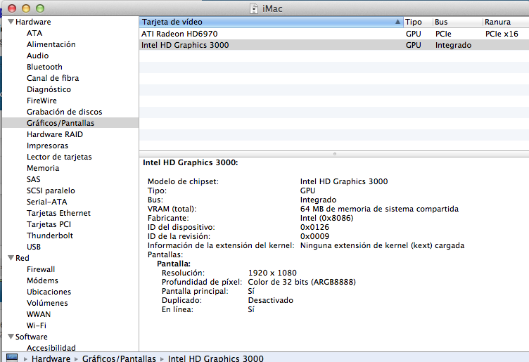

blak24 Posted August 29, 2012 Author Share Posted August 29, 2012 you id is 01268086 575] Modelo de chipset: Intel HD Graphics 3000 575] Tipo: GPU 575] Bus: Integrado 575] VRAM (total): 64 MB de memoria de sistema compartida 575] Fabricante: Intel (0x8086) 575] ID del dispositivo: 0x0126 enable the HD 3000 graphics built into Intel processors no fire... my IDs are that I told you before... also windows shows these numbers... anyway, I will try to that guide... Link to comment Share on other sites More sharing options...

blak24 Posted August 29, 2012 Author Share Posted August 29, 2012 this is taken from my files? it's strange though... windows continues showing that IDs... I will let you know... EDIT: ok, I will try editing the two kexts using this IDs... thanks Link to comment Share on other sites More sharing options...
blak24 Posted August 29, 2012 Author Share Posted August 29, 2012 fire, I think it's 0x01128086, and not that one you told me... I just reinstalled the OS, with GraphicsEnabler=No in safe mode, without installed any kext, systeminfo (the program you told me in the 3rd or 4th page) shows as Device ID 0112 and not 0126... Link to comment Share on other sites More sharing options...
iFIRE Posted August 30, 2012 Share Posted August 30, 2012 systeminfo (the program you told me in the 3rd or 4th page) shows as Device ID 0112 and not 0126... / False/ its Display Controller 8086 0126 install this kext, repairPermissions/rebuilCaches/KextWiizard/Reboot/*Now/open and run in terminal app this comand for see all pci devices ids of the your hardware: lspci -nn lspcidrv.kext.zip Link to comment Share on other sites More sharing options...

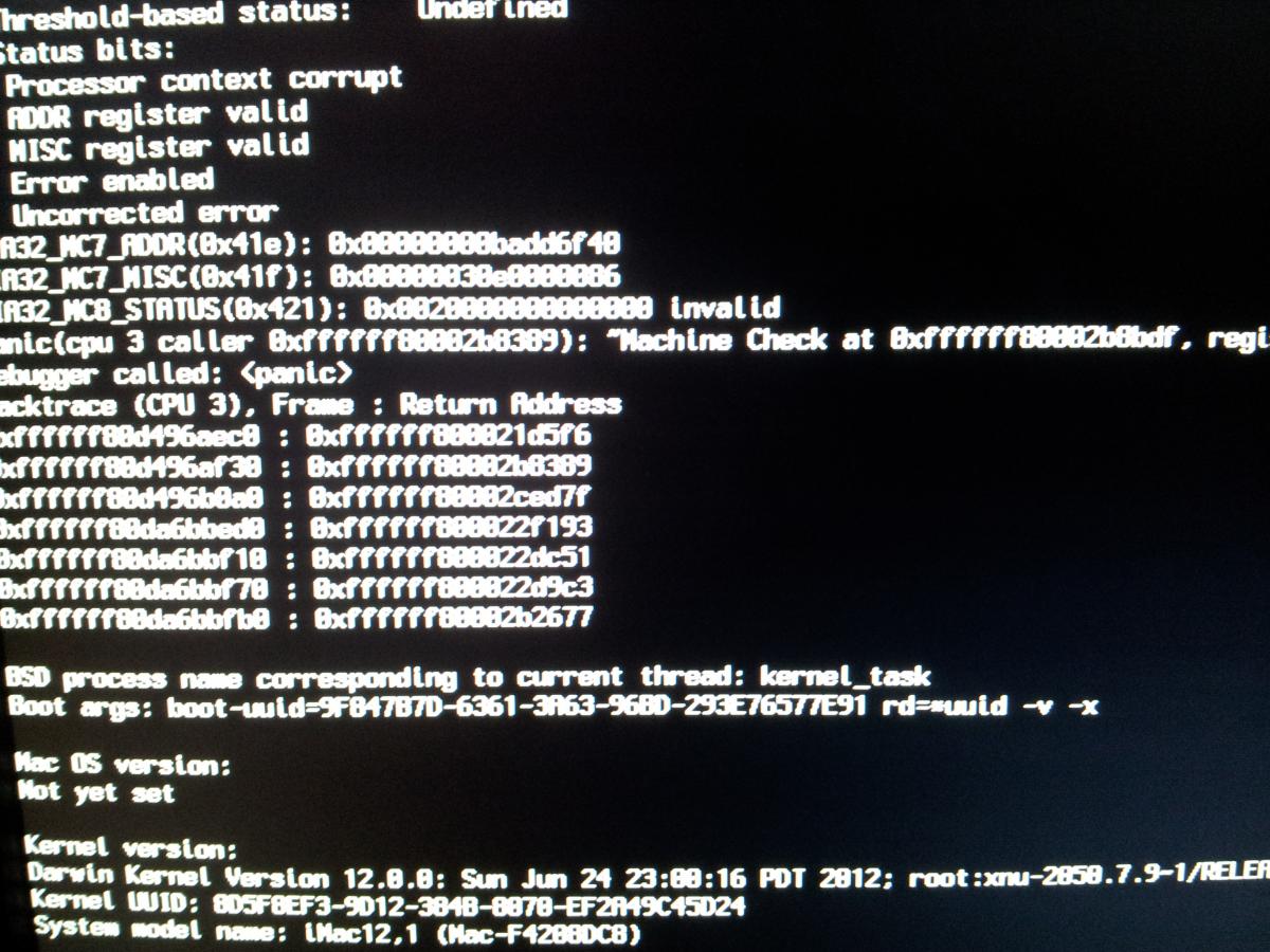

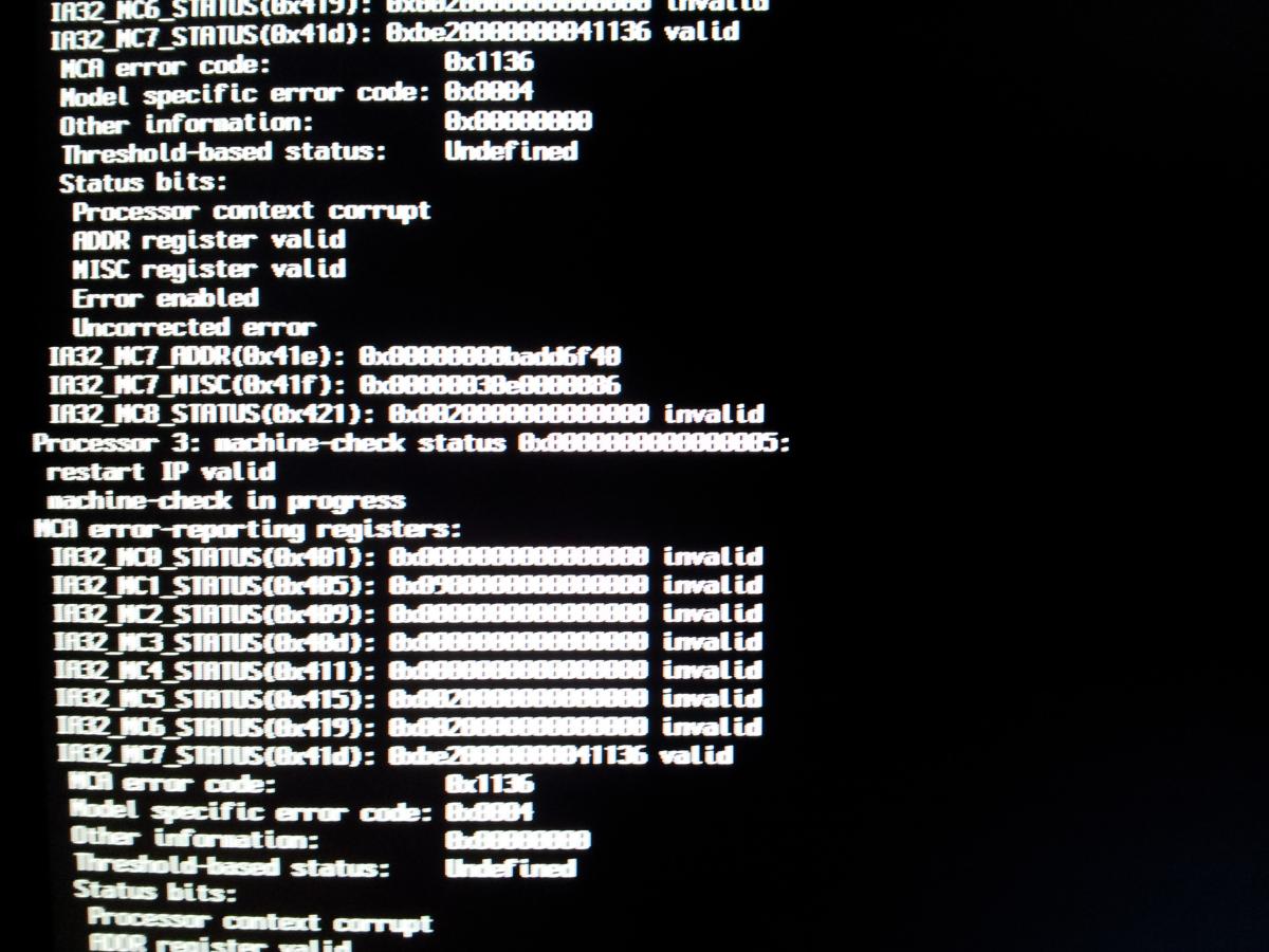

blak24 Posted August 31, 2012 Author Share Posted August 31, 2012 yes, the plist what I post, make the same in your plist and save changes, see my post 111 ok, thank you. the problem is that I got kernel panics and I can't change the .plist file. I just changed the SMBIOS to macmini and then KP... it says "machine check"... so I think it's related to the smbios... EDIT: could it be because I installed a new hard disk yersterday? maybe it can't recognized the hardware because there is something new... Link to comment Share on other sites More sharing options...

blak24 Posted August 31, 2012 Author Share Posted August 31, 2012 hello Blak24, I modified your DSDT.aml an inject method "AAPL00,DualLink", for HD 3000 Change your for this DSDT.aml. Now this work. Also check that the info.plist of AppleIntelSNBGraphicsFB.kext has DeviceID "01268086" & not "0x01268086". Also check "Extensions" in system profiler if both AppleIntelHDGraphics.kext & AppleIntelSNBGraphicsFB.kext are getting loaded. Also use SMBIOS MacMini5,1 or MAcBookPro8,1 Also not boot with -x or this flag not load yours graphics kexts Good Luck!!!! dsdtBlak24.zip HD3000.kext or HD.kext? I will let you know, thank you very much!! EDIT: I just injected the DSDT with chameleon wizard... well, it goes on kernel panic... the same KP of today, where I posted the two photos... KP machine check... from win 7 I deleted the DSDT and it booted with -x as usual... don't know why it goes on KP :S Link to comment Share on other sites More sharing options...
