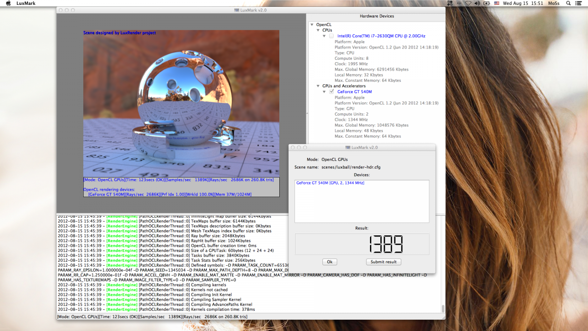

mkMoSs Posted August 15, 2012 Share Posted August 15, 2012 Nobody has any info on this? Or any kind of solution? It's really weird. It seems that the problem lies with NVIDIA GT / GTS / GTX 4xx / 5xx cards mobile or not. In my case I have noticed that if I boot ML with the HDMI plugged in (Vaio laptop with GT 540m 1GB) the display works correctly (mirror mode) and no blue screen, however if I try to change resolutions, I get the blue screen. I might be lucky here cause my external hdmi display and my laptop panel have the same resolution (1920x1080) so it doesn't change the resolution if I unplug and re-plug the hdmi later. But still if I boot ML without hdmi connected and try to connect it later, I get blue screen... I really hope that someone figures out what is wrong and maybe provide a fix. Lots of people are suffering from this apparently. My knowledge is limited I don't even know where to begin searching for what causes this problem. Edit: Just to show that everything works correctly with my card, except from this annoyance I even hex-edited the GeForceGLDriver.bundle to enable OpenCL on my card and works beautifully. I also have a patched DSDT and so my GraphicsEnabler is set to No. Link to comment https://www.insanelymac.com/forum/topic/280742-solvednvidia-gts-450-blue-screen-after-changing-resolution/page/2/#findComment-1844226 Share on other sites More sharing options...

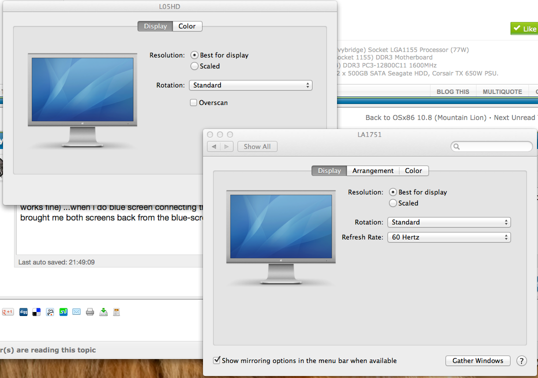

RobertX Posted September 16, 2012 Share Posted September 16, 2012 ...GT 520 here(Zotac)... dual-screen issue only seems to happen if i enable mirroring on different size screens (2 1280x1024...one crt one lcd works fine) ...when i do blue screen connecting the second monitor(hdmi)...plugging in an adapter(dvi-vga) with nothing connected to it, brought me both screens back from the blue-screen ...ioregistryexplorer shows both displays being rediscovered(and i can change resolutions without crapping out) Link to comment https://www.insanelymac.com/forum/topic/280742-solvednvidia-gts-450-blue-screen-after-changing-resolution/page/2/#findComment-1853101 Share on other sites More sharing options...

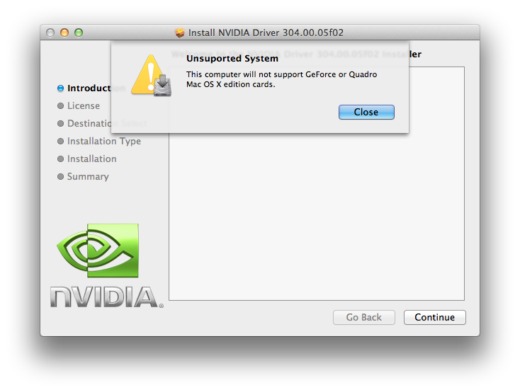

x111 Posted October 10, 2012 Share Posted October 10, 2012 I updated to 10.8.2 and installed these drivers for my GTX 560ti (just ran the installer) but it didn't have any effect on the problem whatsoever. Is there something else I should've done? I have no idea how to fix this. I wrote more about this here Turning off the secondary display produces artifacts, a blue screen and then a crash on GTX 560ti Thanks guys Link to comment https://www.insanelymac.com/forum/topic/280742-solvednvidia-gts-450-blue-screen-after-changing-resolution/page/2/#findComment-1859598 Share on other sites More sharing options...
