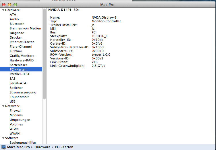

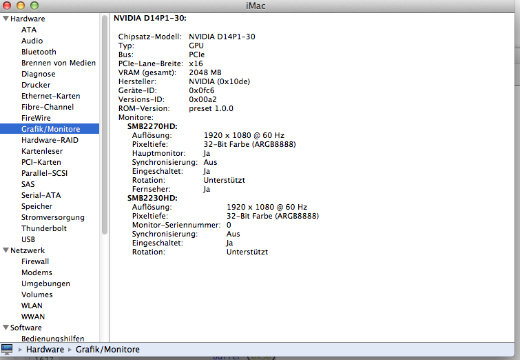

toleda Posted October 2, 2012 Share Posted October 2, 2012 Hello, thx for your ALC883 AppleHda ! working perfekt with my Asus P5K-Pro and behind edits with my Nvidia GTS450 too. But now i´ve got a GTX650 and i have to patch your Applehda again. do you know the hex value´s i have to change to get my GTX650 HDMI working (dsdt edits are done so far)? i tried to get the 10.8.2 Hda.hext working with no luck. could you please so kind and post your terminal patch vor ALC883 ? No AppleHDA.kext edits are required for Nvidia HDMI audio in 10.8. As a matter of fact, with the layout-id of 12 and the proper HDMI audio dsdt edits, Nvidia HDMI audio works with the native AppleHDA.kext. In addition, working onboard audio is not necessary for HDMI audio in ML. Your HDMI audio problem is missing dsdt/P0P2/GFX0 edits. Add GFX0 to your dsdt per the example below. For onboard audio, you will need an 883 edited 10.8 AppleHDA.kext. Device (P0P2) /** Existing Code **/ { Name (_ADR, 0x00010000) Name (_PRW, Package (0x02) /** Optional **/ { 0x09, 0x05 }) Device (GFX0) /** Add GFX0 Code **/ { Name (_ADR, Zero) Name (_SUN, One) Method (_DSM, 4, NotSerialized) { Store (Package (0x06) { "@0,connector-type", Buffer (0x04) { 0x00, 0x08, 0x00, 0x00 }, "@1,connector-type", Buffer (0x04) { 0x00, 0x08, 0x00, 0x00 }, "hda-gfx", Buffer (0x0A) { "onboard-1" } }, Local0) DTGP (Arg0, Arg1, Arg2, Arg3, RefOf (Local0)) Return (Local0) } } Device (HDAU) /** Existing Code **/ Link to comment https://www.insanelymac.com/forum/topic/280468-applehda-patching-in-mountain-lion/page/6/#findComment-1857471 Share on other sites More sharing options...
Carstiman Posted October 2, 2012 Share Posted October 2, 2012 hello, thx for reply. my Nvidia GTS450 ist working 100% without any errors with my Asus P5K-Pro, Riley Freeman´s patches ALC883 Applehda.kext and HDMI bin patch #!/bin/bash # Patch 10.6.4 AppleHDA & AppleHDAController for HDMI Audio - GeForce GTS 450 # Copyright (C) tonymacx86 LLC perl -pi -0777 -e 's|\x07\x00\xde\x10|\x11\x00\xde\x10|g' "${3}/System/Library/Extensions/AppleHDA.kext/Contents/MacOS/AppleHDA" perl -pi -0777 -e 's|\xde\x10\xe4\x0b|\xde\x10\xe9\x0b|g' "${3}/System/Library/Extensions/AppleHDA.kext/Contents/PlugIns/AppleHDAController.kext/Contents/MacOS/AppleHDAController" touch "${3}/System/Library/Extensions/" exit Link to comment https://www.insanelymac.com/forum/topic/280468-applehda-patching-in-mountain-lion/page/6/#findComment-1857549 Share on other sites More sharing options...
toleda Posted October 2, 2012 Share Posted October 2, 2012 hello, thx for reply. my Nvidia GTS450 ist working 100% without any errors with my Asus P5K-Pro, Riley Freeman´s patches ALC883 Applehda.kext and HDMI bin patch GTX650 give this error: Sound assertion in AppleHDAController at line 1294 so is find and replace de 10 e4 0b to de 10 1b 0e rigt for the AppleHDAController GTX650/10.8.2 ? i ad GFX0 to my dsdt but i´ve got some mistakes inside so it won´t recognize right. would be great if you could help Nvidia HDMI audio AppleHDA.kext patches for Snow Leopard and Lion are not necessary in Mountain Lion. Of course it worked for your GTS450 because it works without any edits. How do you know the sound assertion is related to the GTX650? At the risk of repeating myself, device_id edits in ML AppleHDA are not necessary. Regarding your dsdt/GFX0 edits, I do not know what is wrong, however, I can say it won't give you HDMI audio. You must add connector-type injection. Something else you may not know, all Nvidia Kepler graphics cards are fully enabled in ML with GE=No (no dsdt/GFX0 edits necessary). To solve your GFX0 problem, edit GFX0 as described in my previous reply to you. If there is nothing else wrong, you will have HDMI audio on your fully enabled GTX650, the easy way. Link to comment https://www.insanelymac.com/forum/topic/280468-applehda-patching-in-mountain-lion/page/6/#findComment-1857653 Share on other sites More sharing options...
Carstiman Posted October 2, 2012 Share Posted October 2, 2012 now i insert your code and it is 100 % working with the GTX650 and my dsdt.aml Thanks a lot for your time and help ! Link to comment https://www.insanelymac.com/forum/topic/280468-applehda-patching-in-mountain-lion/page/6/#findComment-1857670 Share on other sites More sharing options...
