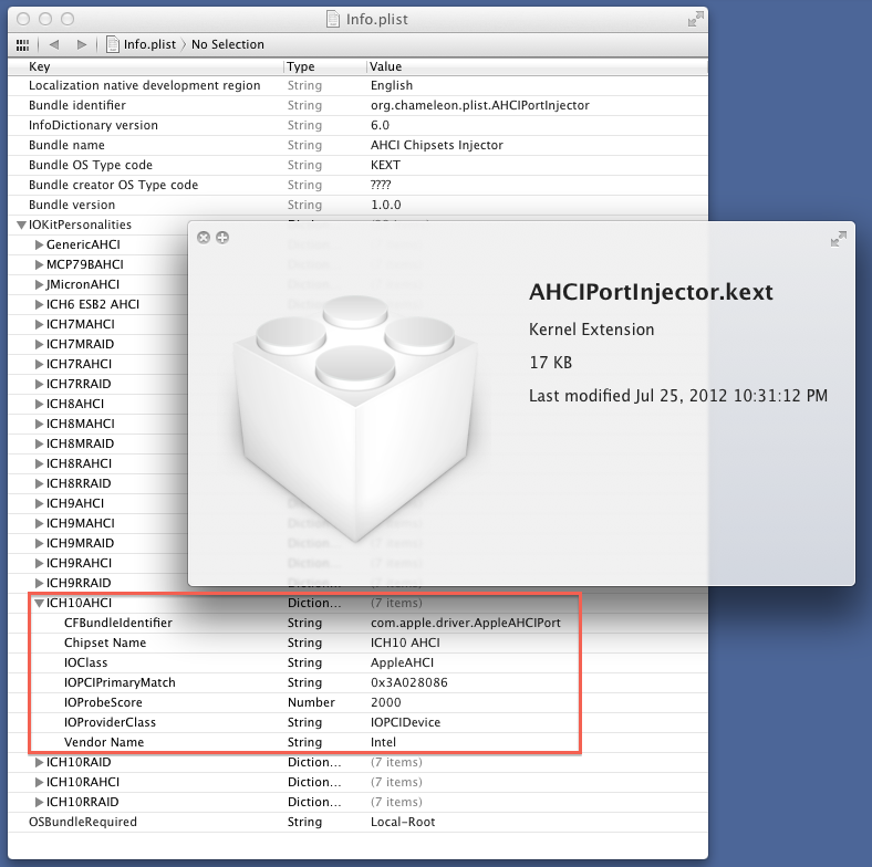

Gringo Vermelho Posted July 26, 2012 Share Posted July 26, 2012 I repeat: Make sure ICH10 is set to AHCI mode in the BIOS. Make sure AHCIPortInjector is correctly installed, here's how: Click the apple menu and while holding the option key, click "System Information". The find Serial ATA to the left. It should say "Intel ICH10 AHCI". AHCIPortInjector.kext.zip Link to comment https://www.insanelymac.com/forum/topic/279835-solved-f12-to-openclose-tray-see-page-4/page/2/#findComment-1837058 Share on other sites More sharing options...

Gringo Vermelho Posted July 26, 2012 Share Posted July 26, 2012 How can I make this more clear...does it work or not? If it works, don't edit it! I don't know why you want to edit it, so I can't give a meaningful answer to your question. I guess the answer is no, but that's just a guess. From a quick google your motherboard (Asus P6TD Deluxe) has the ICH10R, system profiler/system information should show "ICH10-R AHCI" when using AHCIPortInjector. If it doesn't (your screenshot shows ICH10, not ICH10-R), then you did something wrong, or there's a typo in the plist. ICH10 and ICH10R have different device IDs. To be absolutely sure, verify that your actual ICH10R device ID matches with the one listed at ICH10R in AHCIPortInjector's info.plist. It doesn't really make a difference though, it's just cosmetic. No difference in functionality. Link to comment https://www.insanelymac.com/forum/topic/279835-solved-f12-to-openclose-tray-see-page-4/page/2/#findComment-1837099 Share on other sites More sharing options...
