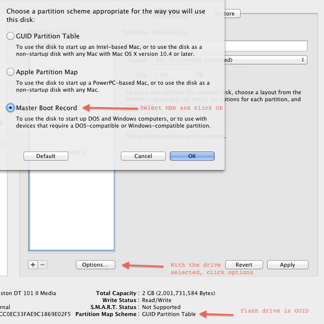

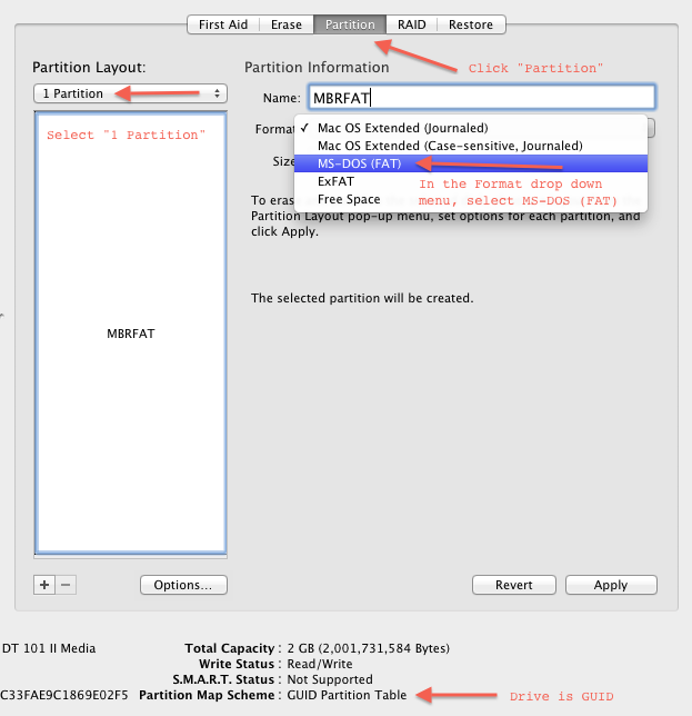

Gringo Vermelho Posted June 13, 2012 Share Posted June 13, 2012 No, you are wrong and this is why your post does not belong in the Genius bar (not sure where else to put it though):Disk Utility will let you format anything but you may have to wipe whatever partition table is on it first.Disk Utility only creates the invisible EFI partition on GUID aka GPT drives.Look at these screenshots (sorry about the mess, i didn't write the steps in order, but you get the idea): This is how you repartition and format a GUID drive with Disk Utility so that it can be used on Windows.The other stuff you said is not entirely correct either:The System Reserved partition only gets created during installation of Windows, and only when installing to a drive that is not already formatted.It does not get created when formatting a drive from within Windows. 2 Link to comment https://www.insanelymac.com/forum/topic/279727-a-200mb-efi-system-partition-stuck-on-your-usb-drive-and-cant-get-it-off-read-this/#findComment-1826436 Share on other sites More sharing options...
