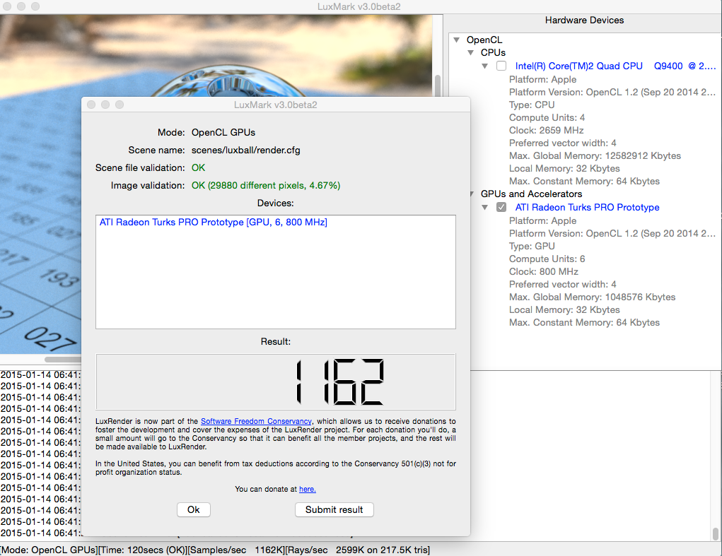

mitch_de Posted January 13, 2015 Author Share Posted January 13, 2015 v3.0beta2 available (DL link first posting) Apple OpenCL seem to have much probs with new 3.0 LM OpenCL code. At least the two bigger scenes wont run on most gpus. Same Programmcode in Win much less probs. 1 Link to comment https://www.insanelymac.com/forum/topic/274549-luxmark-v40alpha1-nov-2020-opencl-benchmark/page/6/#findComment-2102784 Share on other sites More sharing options...

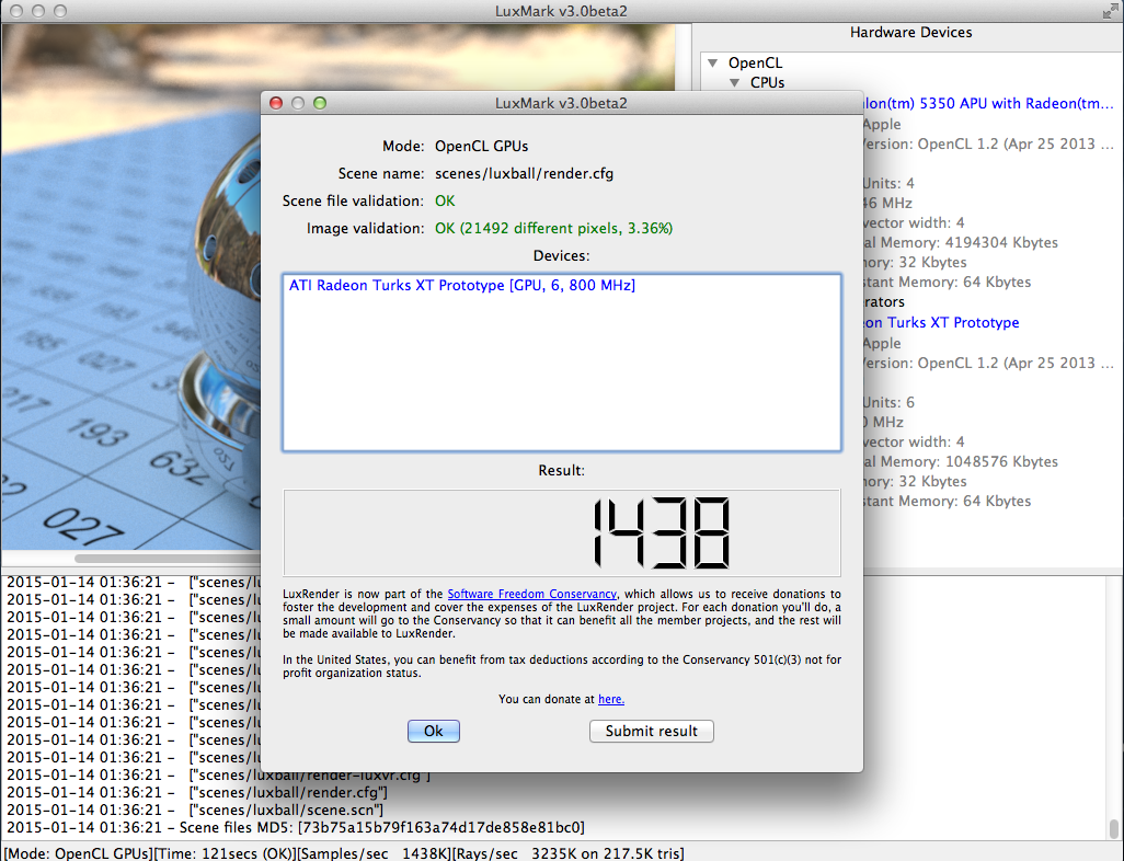

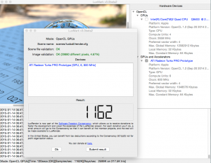

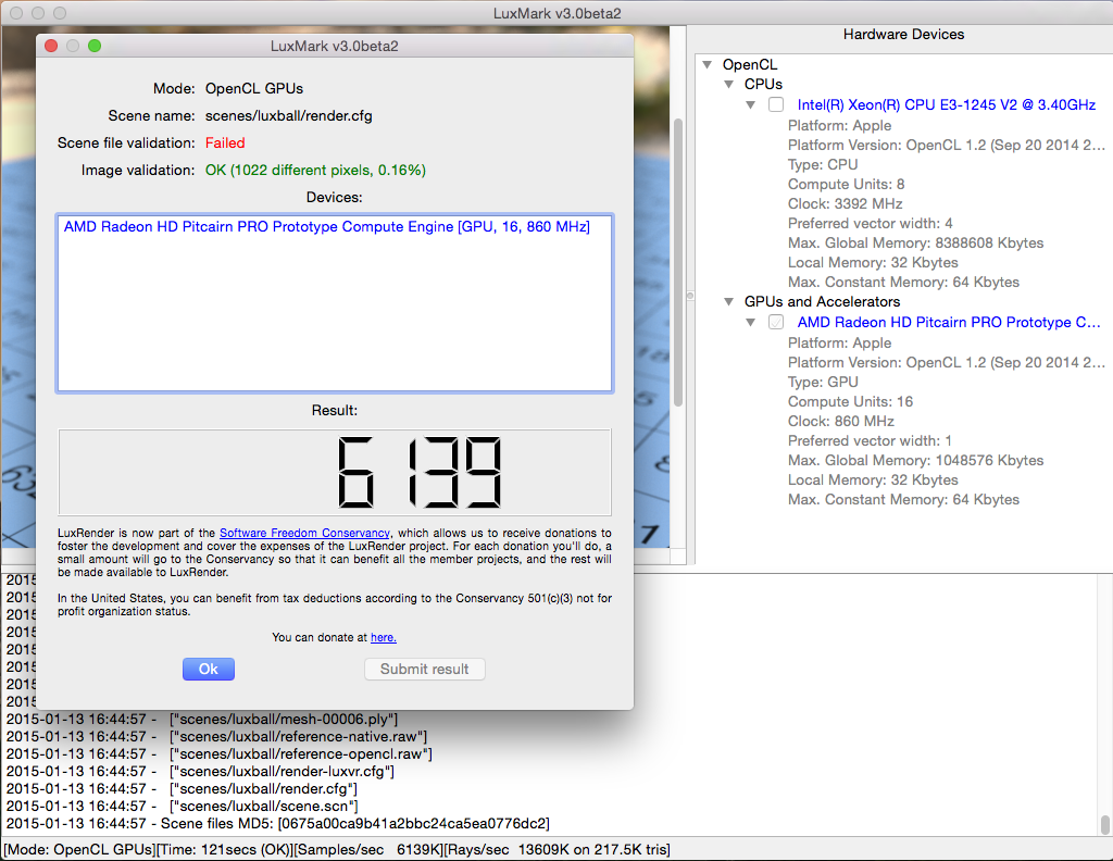

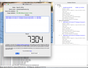

gils83 Posted January 14, 2015 Share Posted January 14, 2015 HD 6670 / APU Athlon 5350 and HD 7850/1024 Xeon E3-1245v2 Link to comment https://www.insanelymac.com/forum/topic/274549-luxmark-v40alpha1-nov-2020-opencl-benchmark/page/6/#findComment-2102797 Share on other sites More sharing options...

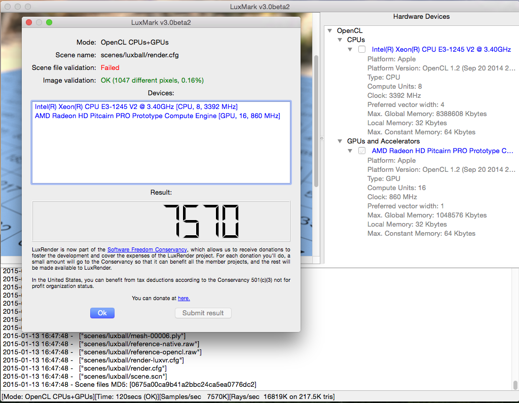

RobertX Posted January 14, 2015 Share Posted January 14, 2015 ..and mine, Link to comment https://www.insanelymac.com/forum/topic/274549-luxmark-v40alpha1-nov-2020-opencl-benchmark/page/6/#findComment-2102861 Share on other sites More sharing options...

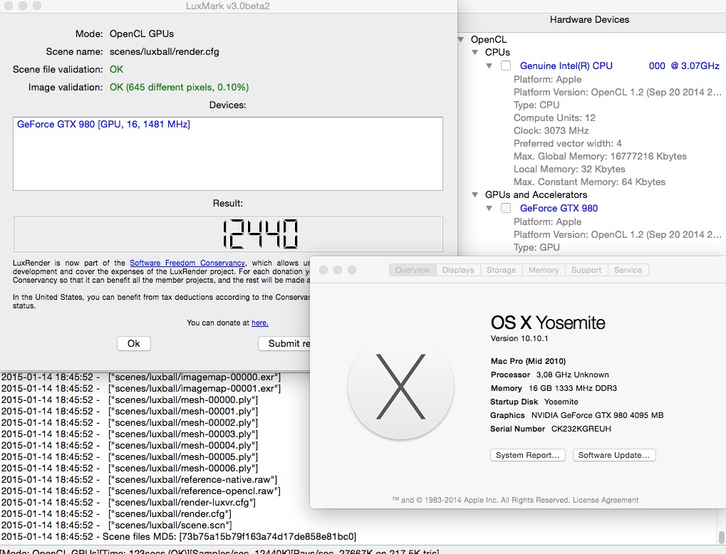

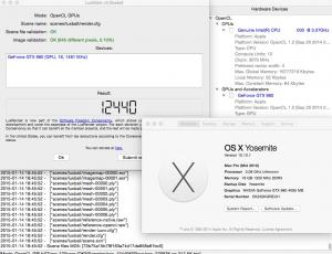

badaxe2 Posted January 14, 2015 Share Posted January 14, 2015 Yosemite 10.10.1 + GTX 980 Latest Web Drivers from Nvidia - luxmark.tiff 1 Link to comment https://www.insanelymac.com/forum/topic/274549-luxmark-v40alpha1-nov-2020-opencl-benchmark/page/6/#findComment-2102921 Share on other sites More sharing options...

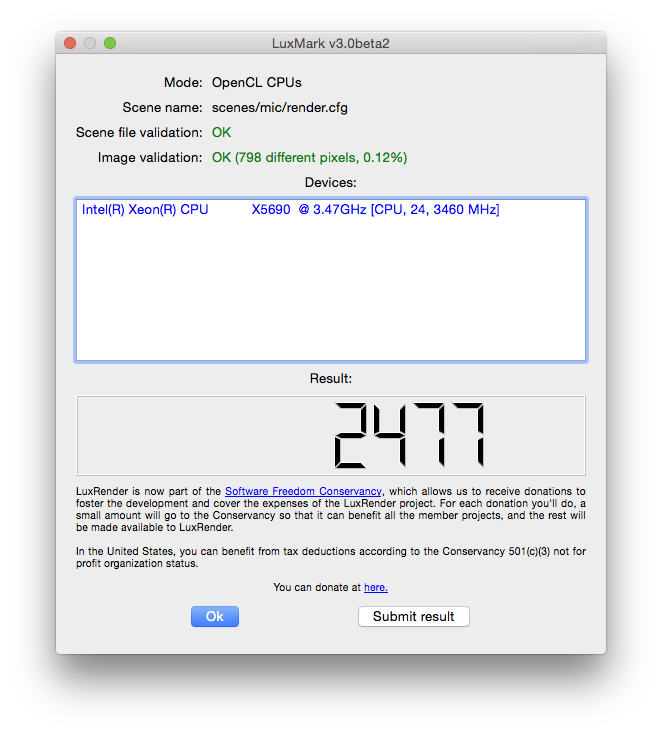

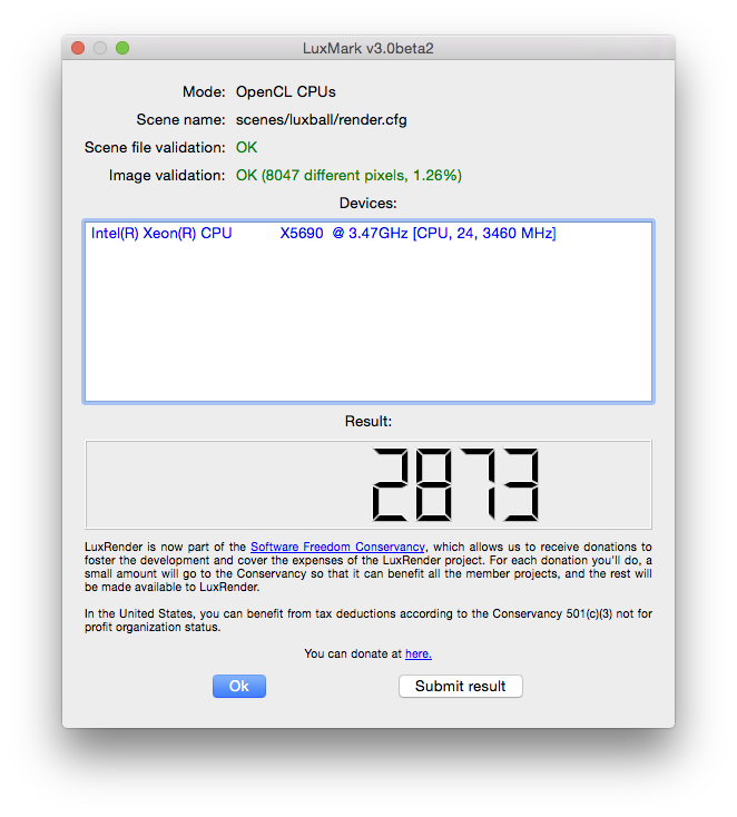

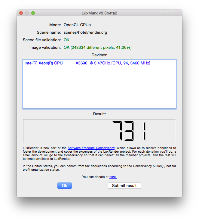

blacksheep Posted February 2, 2015 Share Posted February 2, 2015 7970 + R9 280X in a Mac Pro 5,1, internally powered, 10.9.5 Edit: Added CPU only scores. 2x X5690, 10.10.2 1 Link to comment https://www.insanelymac.com/forum/topic/274549-luxmark-v40alpha1-nov-2020-opencl-benchmark/page/6/#findComment-2108145 Share on other sites More sharing options...

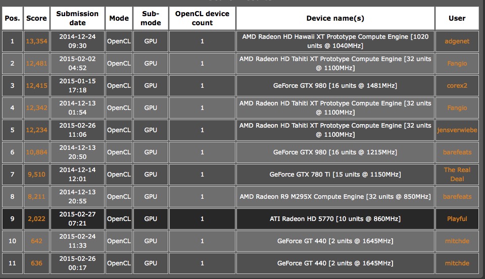

mitch_de Posted February 27, 2015 Author Share Posted February 27, 2015 updated first post / Links : V 3.0 available. Same probs as before (with betas) : on most gpus only the luxballHDR scene (small) will run on GPU, the two others will fail (OpenCL compiler error or OpenCL runtime error) because of OpenCL compiler / OpenCL driver probs in OS X / Linux. But you can run the medium und big scene in OpenCL CPU only mode or C++ (on CPU) mode (as an cpu bench ) Nvidia GT 440 (OpenCL GPU only) : 636 ( my result in database: http://www.luxmark.info/node/207 ) I am the slowest the database database (Mac, gpu only, 1 gpu results for luxball HDR (small scene) 3 Link to comment https://www.insanelymac.com/forum/topic/274549-luxmark-v40alpha1-nov-2020-opencl-benchmark/page/6/#findComment-2115610 Share on other sites More sharing options...

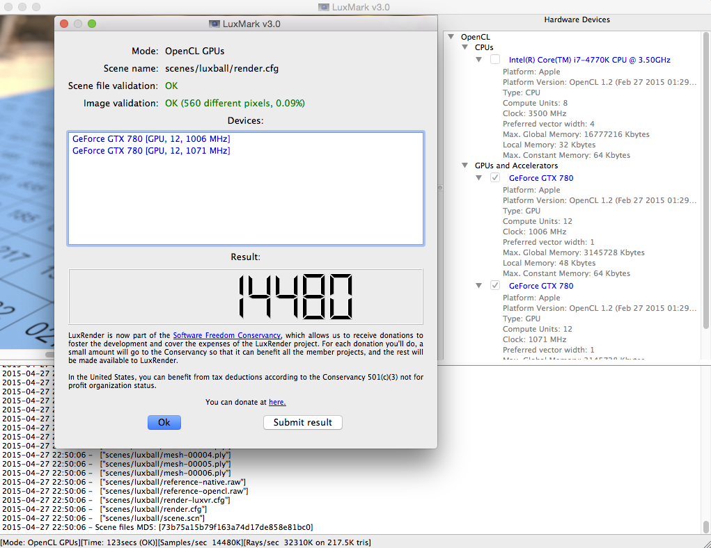

b00bl1k Posted April 27, 2015 Share Posted April 27, 2015 2x GTX780 = 14 480 Link to comment https://www.insanelymac.com/forum/topic/274549-luxmark-v40alpha1-nov-2020-opencl-benchmark/page/6/#findComment-2131516 Share on other sites More sharing options...

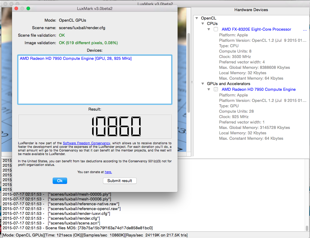

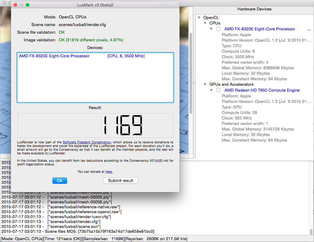

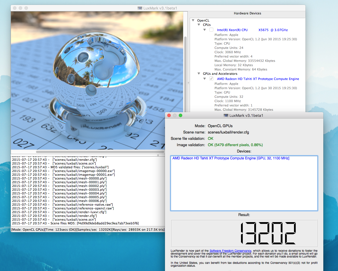

gils83 Posted July 17, 2015 Share Posted July 17, 2015 1x HD 7950 = 10860 Link to comment https://www.insanelymac.com/forum/topic/274549-luxmark-v40alpha1-nov-2020-opencl-benchmark/page/6/#findComment-2153736 Share on other sites More sharing options...

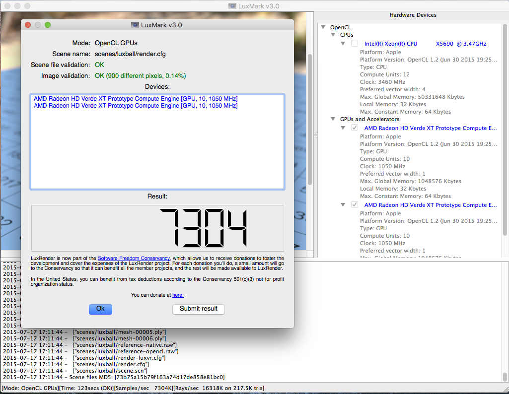

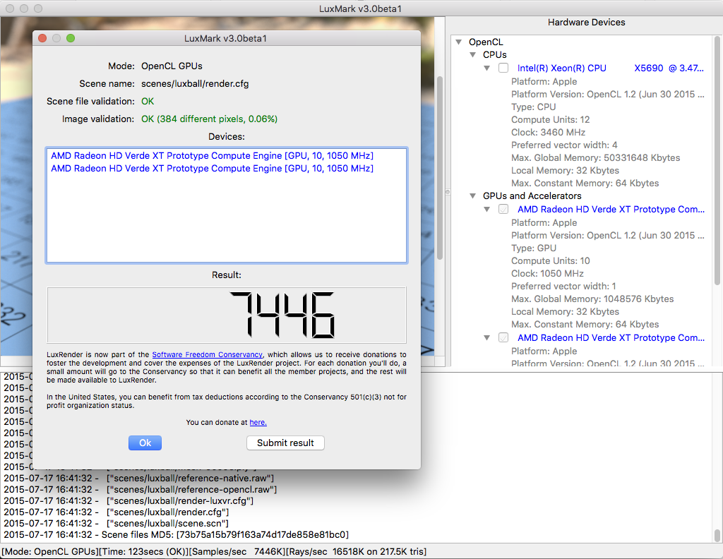

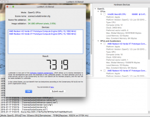

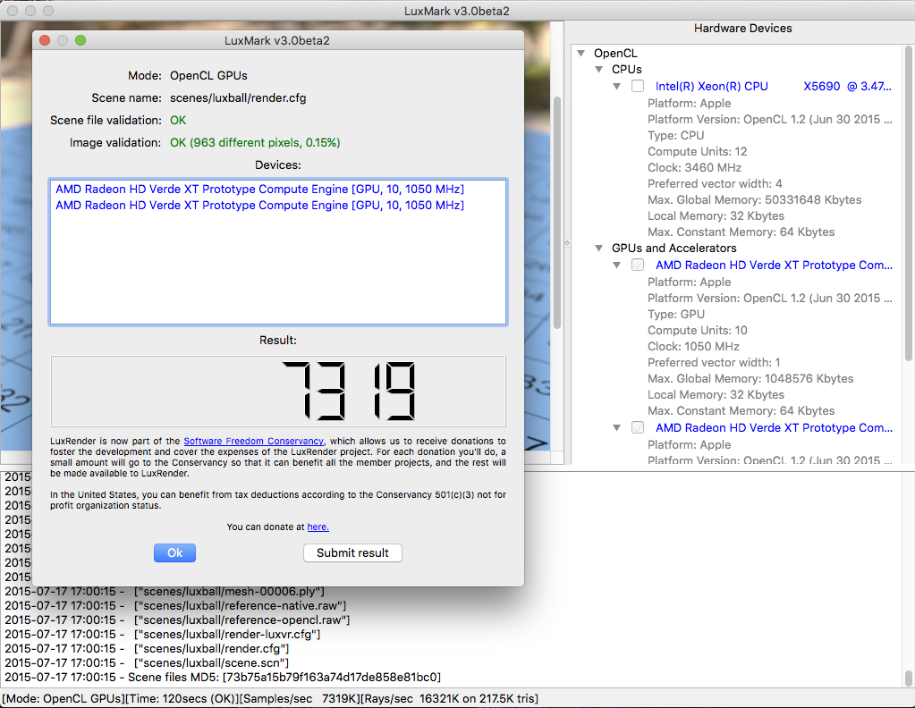

blacksheep Posted July 17, 2015 Share Posted July 17, 2015 2x HD 7770 and 3 versions of Luxmark 3.0. Beta 1 turned out to be the best performance and accuracy-wise. All on El Capitan DP3 in a Mac Pro 5,1. Link to comment https://www.insanelymac.com/forum/topic/274549-luxmark-v40alpha1-nov-2020-opencl-benchmark/page/6/#findComment-2153828 Share on other sites More sharing options...

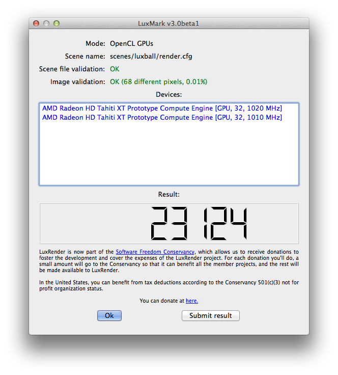

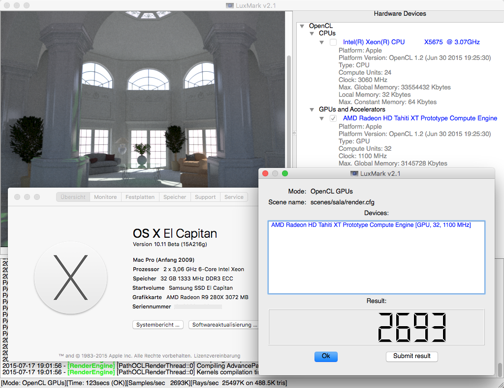

Fangio Posted July 17, 2015 Share Posted July 17, 2015 2x HD 7770 and 3 versions of Luxmark 3.0. Beta 1 turned out to be the best performance and accuracy-wise. All on El Capitan DP3 in a Mac Pro 5,1. Inspiring. Ok I've used 3.0 (was accurate enough) and 3.1 Beta 1 (less accurate yet). 280X and a cMP 5,1 as well, on El Cap DP3 So Luxmark 3.0 and 3.1 results are similar but not going to be a fair comparison, as noted by the dev here. There's another interesting result. In good old Luxmark 2.1 & sala scene, the score with the same machine and 280X in Mavericks and Yosemite has always been 2400ish, see #109 here. Now on El Capitan I'm getting close to 2700.. Link to comment https://www.insanelymac.com/forum/topic/274549-luxmark-v40alpha1-nov-2020-opencl-benchmark/page/6/#findComment-2153876 Share on other sites More sharing options...
blacksheep Posted July 18, 2015 Share Posted July 18, 2015 There's another interesting result. In good old Luxmark 2.1 & sala scene, the score with the same machine and 280X in Mavericks and Yosemite has always been 2400ish, see #109 here. Now on El Capitan I'm getting close to 2700.. Same here. In Mavs and Yos I was getting a bit above 1500 for these dual 7770s in Lux 2.1 sala, El Cap gives nearly 1900. Good direction Apple has, at least on this field. Link to comment https://www.insanelymac.com/forum/topic/274549-luxmark-v40alpha1-nov-2020-opencl-benchmark/page/6/#findComment-2153978 Share on other sites More sharing options...

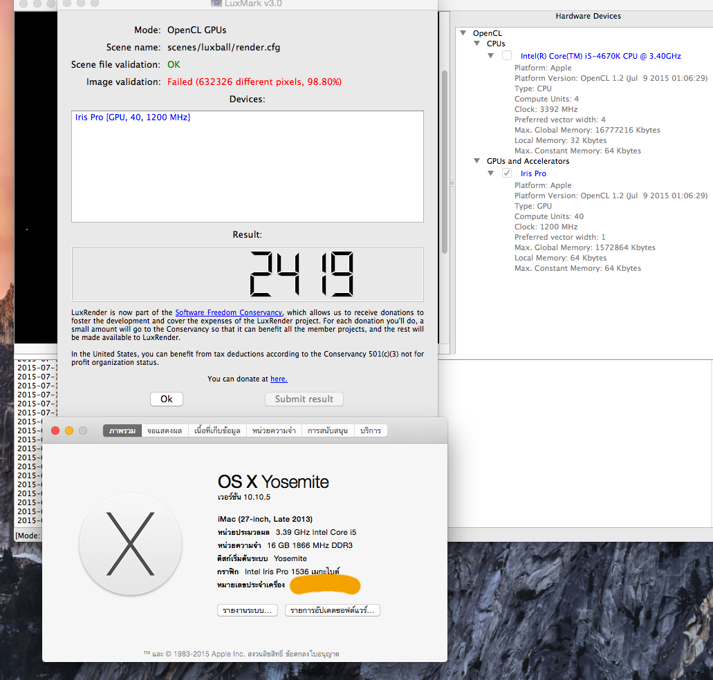

naiclub Posted July 18, 2015 Share Posted July 18, 2015 Link to comment https://www.insanelymac.com/forum/topic/274549-luxmark-v40alpha1-nov-2020-opencl-benchmark/page/6/#findComment-2154002 Share on other sites More sharing options...

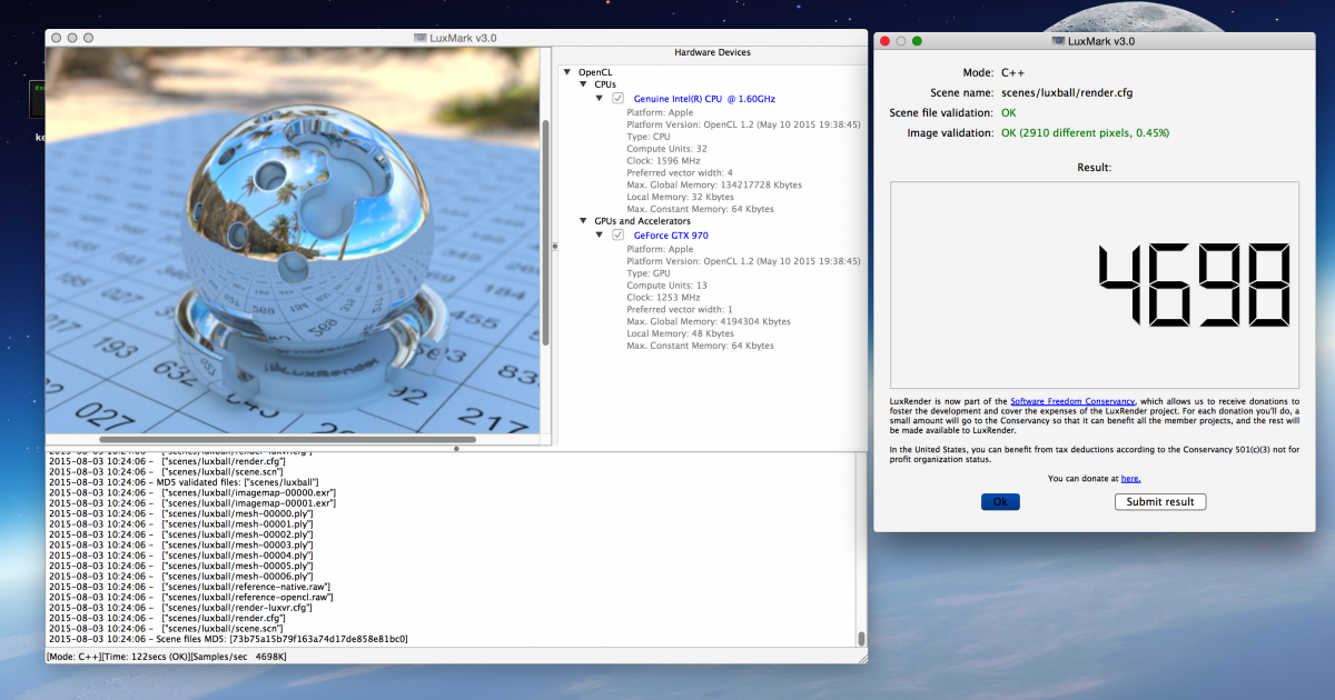

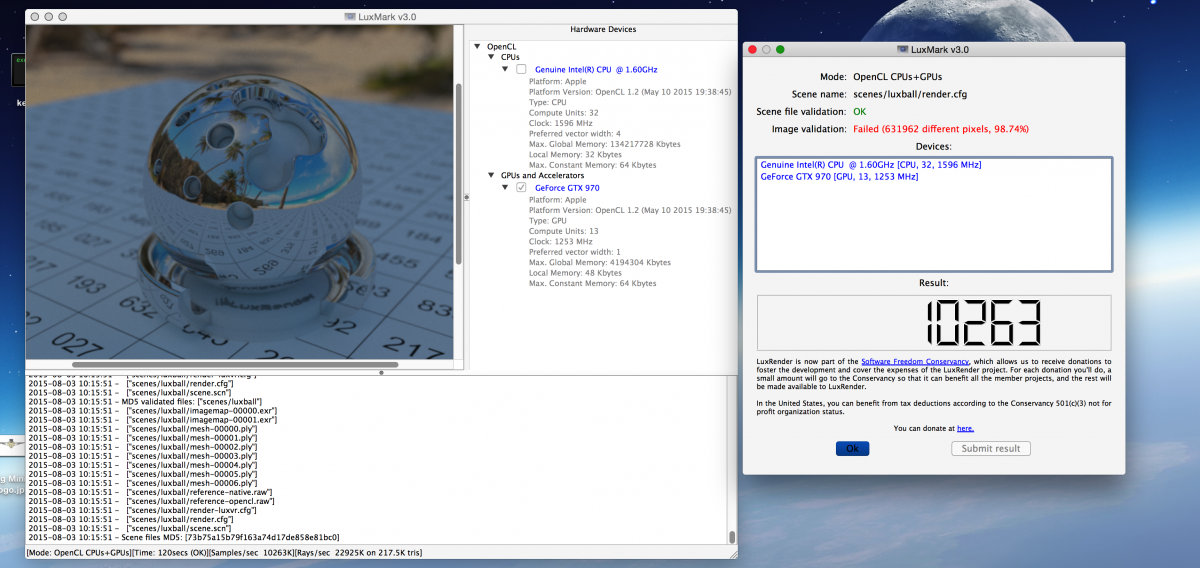

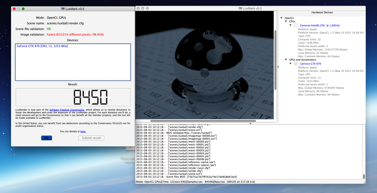

oskr66 Posted August 3, 2015 Share Posted August 3, 2015 here are my results , the complex tests fails , due to a error on kernel compiled , tests done with a dual E5 2640 cpus, on a ASrock motherboard , 128 Gigs of ram , water cooled Link to comment https://www.insanelymac.com/forum/topic/274549-luxmark-v40alpha1-nov-2020-opencl-benchmark/page/6/#findComment-2157522 Share on other sites More sharing options...

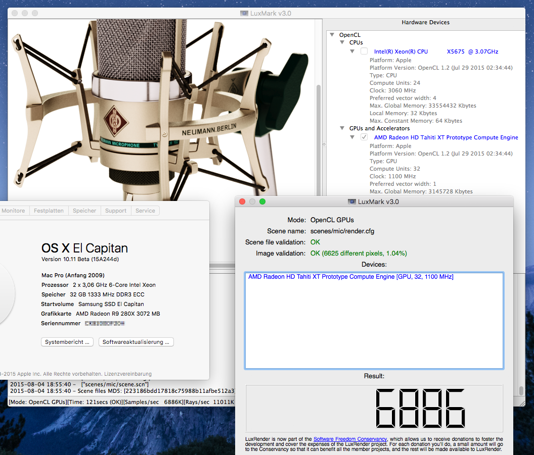

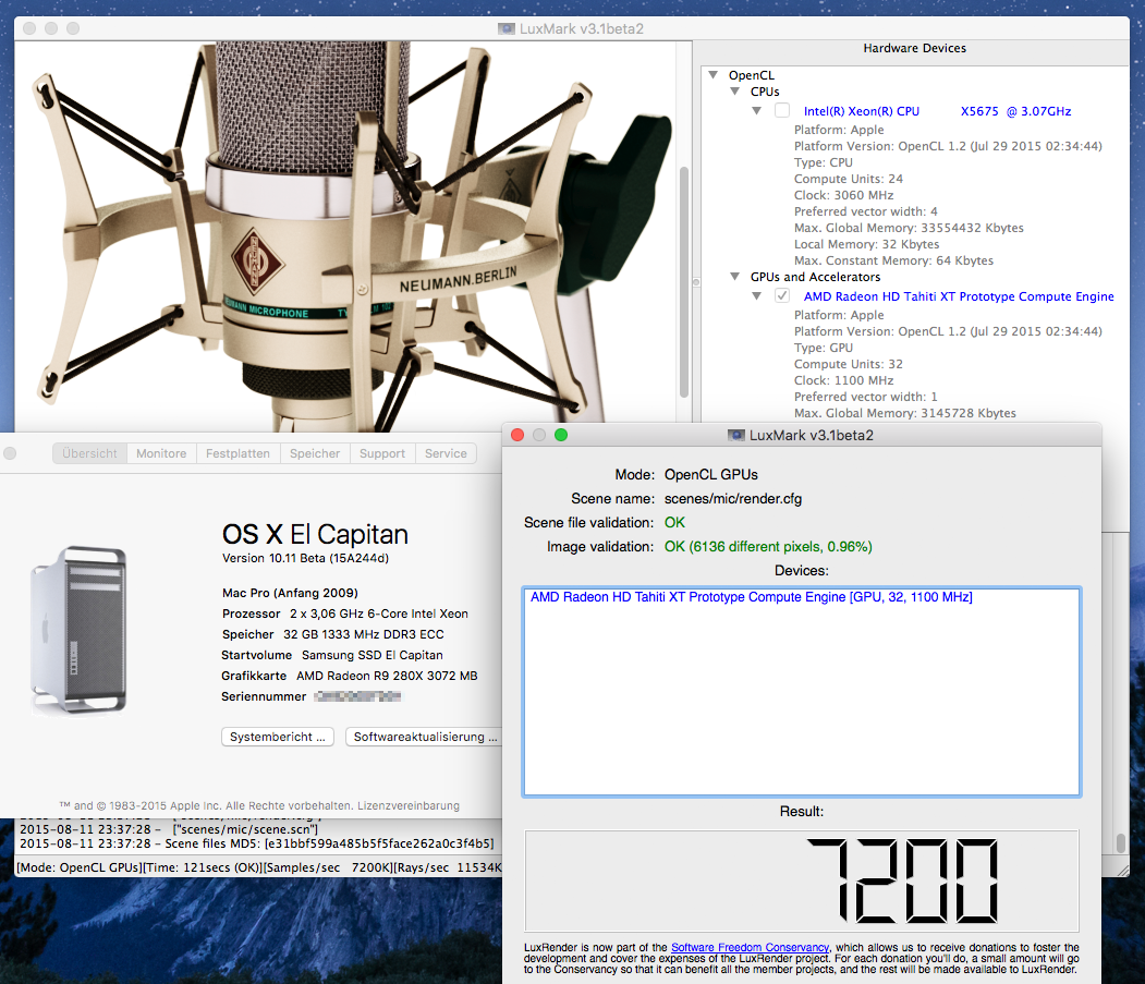

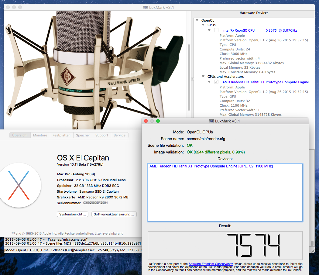

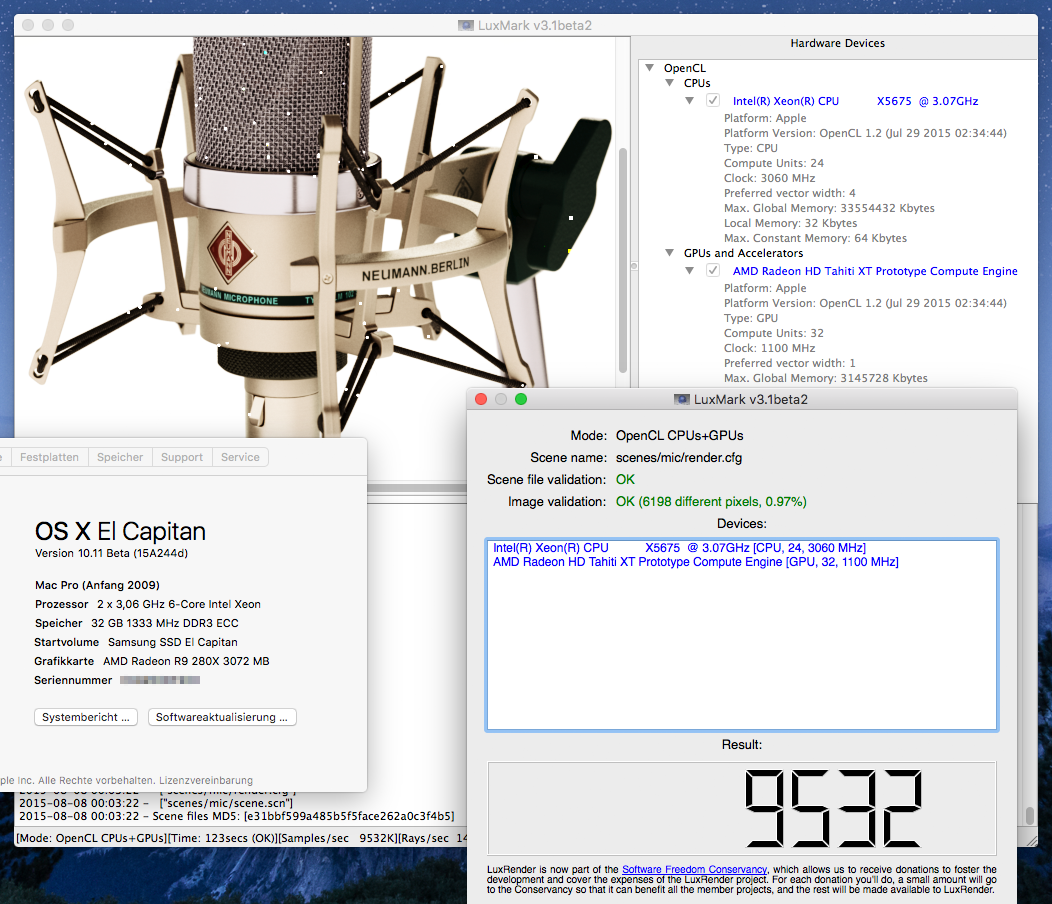

Fangio Posted August 12, 2015 Share Posted August 12, 2015 There's progress with the Neumann Mic medium scene on Macs, it's working fine now in El Cap no more errors. Might become a standard like Sala in v2.1. And yes same here, unfortunately still no way to get GPU only results from the Hotel Lobby complex scene. Luxmark 3.0 vs 3.1 beta 2 / 10.11 DP6 GPU & CPU, v3.1 beta 2 Hawaii or Fiji, anyone? Or Maxwell? 2 Link to comment https://www.insanelymac.com/forum/topic/274549-luxmark-v40alpha1-nov-2020-opencl-benchmark/page/6/#findComment-2159722 Share on other sites More sharing options...

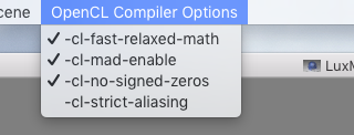

mitch_de Posted August 15, 2015 Author Share Posted August 15, 2015 10.10.5 isnt able to run the mic scene (3.1beta2,3). compiler fails like older 10.10 versions. Someone posted it is working in El Captain. Perhaps apple never fix that in 10.10.x , because most other OpenCL tasks arent affected or OpenCL today isnt used that complex way like luxmark. Updated first post 3.1beta3 available (added option to change CL compiler options in the menue) 1 Link to comment https://www.insanelymac.com/forum/topic/274549-luxmark-v40alpha1-nov-2020-opencl-benchmark/page/6/#findComment-2160581 Share on other sites More sharing options...

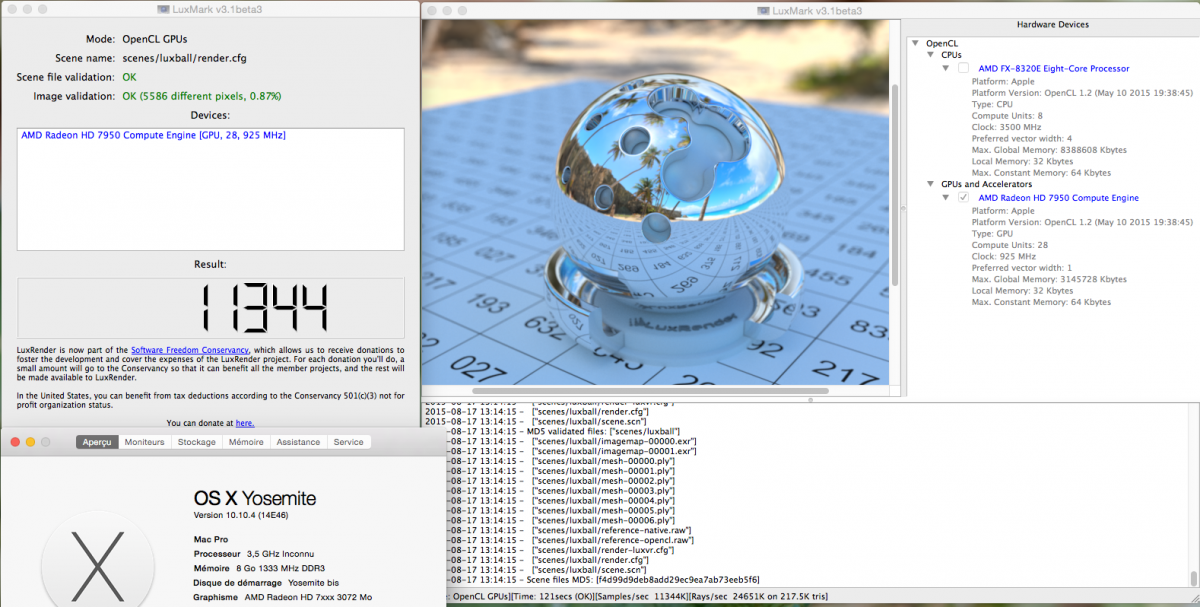

gils83 Posted August 17, 2015 Share Posted August 17, 2015 + 500 pts 1 Link to comment https://www.insanelymac.com/forum/topic/274549-luxmark-v40alpha1-nov-2020-opencl-benchmark/page/6/#findComment-2161091 Share on other sites More sharing options...

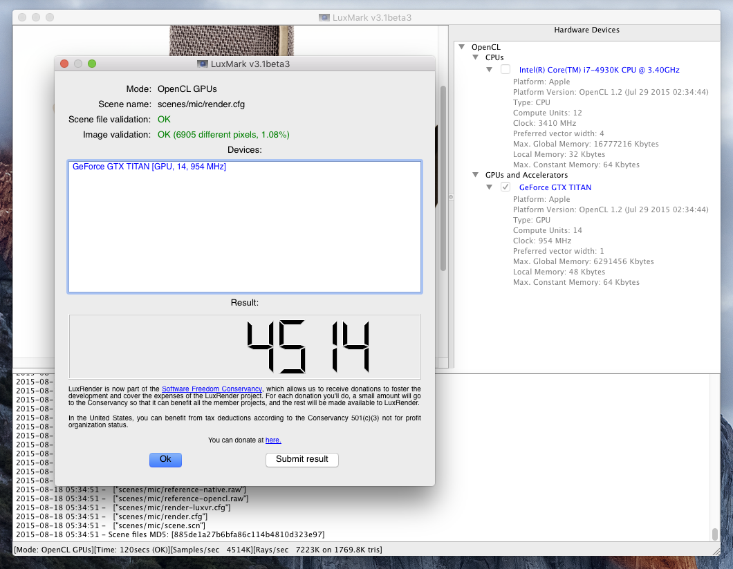

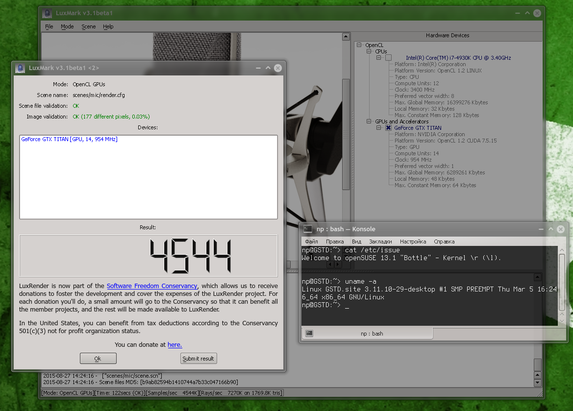

npwski Posted August 18, 2015 Share Posted August 18, 2015 Someone with Nvidia and 10.11 (using 3.1b2/3)? OS X 10.11 dev.beta 6 build 15A244d Luxmark v.3.1 beta 3, scene 'Neumann (microphone)' Nvidia GTX Titan GK110 I'm not sure which compiler option was needed, therefore used defaults PS. For comparison, here is linux result OpenSUSE 13.1, kernel 3.11.10-29, Nvidia proprietary driver 352.30 Luxmark v.3.1 beta 1, scene 'Neumann (microphone)' Link to comment https://www.insanelymac.com/forum/topic/274549-luxmark-v40alpha1-nov-2020-opencl-benchmark/page/6/#findComment-2161299 Share on other sites More sharing options...

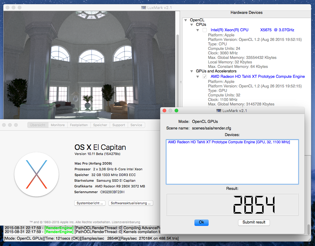

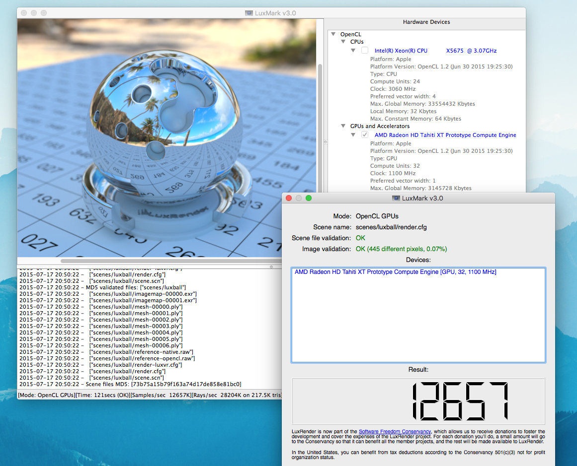

Fangio Posted September 2, 2015 Share Posted September 2, 2015 3 units rendering Yosi 10.10.5 One unit rendering Sala, Tahiti XT (!) & El Cap DP8 again +160 pts, getting new alltime highscores with almost every new beta of 10.11. Edit, similar increase with LuxMark v3.1 final release and Neumann Mic, default compilers. +370 pts in DP8 1 Link to comment https://www.insanelymac.com/forum/topic/274549-luxmark-v40alpha1-nov-2020-opencl-benchmark/page/6/#findComment-2165109 Share on other sites More sharing options...

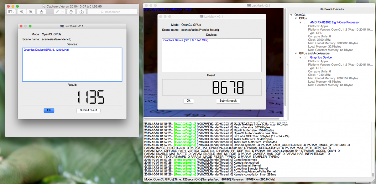

gils83 Posted October 7, 2015 Share Posted October 7, 2015 Maxwell 2 GTX 950 (2.1) Link to comment https://www.insanelymac.com/forum/topic/274549-luxmark-v40alpha1-nov-2020-opencl-benchmark/page/6/#findComment-2174327 Share on other sites More sharing options...
