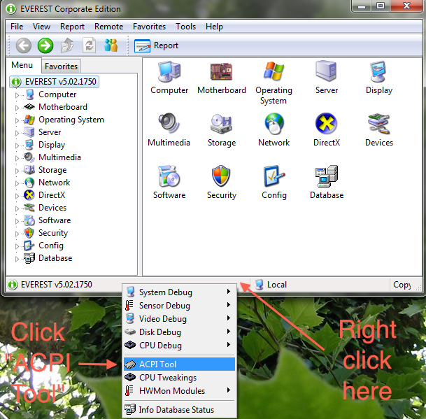

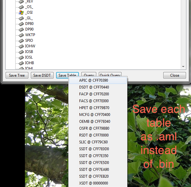

Gringo Vermelho Posted September 16, 2013 Share Posted September 16, 2013 If required (generally Gigabyte Z77 boards don't need it, ASUS boards do) patch the latest BIOS for your motherboard with PMPatch for compatibility with OS X power management. Note that some motherboards require special tools or a specific method in order to flash a modified BIOS. With the new BIOS flashed, first configure it like it was before, and second (if you were using a dsdt.aml) re-extract a clean DSDT from Windows using Lavalys Everest Corporate Edition (scroll down to 'discontinued') and re-patch the new DSDT. Screenshots provided for reference (thanks to an old friend of mine) - save the ACPI tables with .aml extension instead of the default .bin extension: If you don't have Windows installed, use a Linux live environment - Google for a how-to. Don't use a DSDT extracted from within OS X and never use a DSDT provided by a 3rd party, unless you know what you're doing - the DSDT table is not static, contents change depending on BIOS settings and revision, amount of RAM installed and other obscure things. ssdtPRGen - make your own SSDT (while it's still useful, RampageDev's tutorial is slightly outdated, use ssdtPRGen.app, google it..) name it ssdt.aml and place it in /Extra, add DropSSDT=y to /Extra/org.Chameleon.Boot.plist. Insert values that match your present overclock. If you change overclocking settings you'll need to run the app or script again and insert the new values. Z77 chipset + Ivy Bridge CPU = iMac13,1 smbios: smbios.plist.zip Use Chameleon Wizard to generate an authentic iMac13,1 serial number, I've placed a filler.. If you do everything right there's no need to set any clock frequency overrides in smbios.plist. Grab the latest HWSensors package and edit info.plist inside FakeSMC.kext like this to match the iMac13,1: If you're using XCode to edit the plist, first select 'show raw keys & values' from the editor menu so you can see what you're doing. Double check that the new REV data actually sticks, save the plist to your desktop before editing it. Only install the FakeSMC plugins you need. Timing issues, particularly those resulting in slowdowns and stuttering sound/dropouts, can in most cases be resolved by removing forced IRQs from certain devices in your DSDT. This allows OS X to distribute IRQs as it sees fit. Use IORegistryExplorer (from XCode Dev Tools) to monitor your modifications: Assigned IRQs for each device are visible under "IOInterruptSpecifiers". Obviously get rid of NullCPUPM.kext, SleepEnabler.kext and anything else designed to override or block native power management from working. Don't use /Extra/Extensions. I can't be more specific than this, you must read, study and collect information specific to your hardware. 2 Link to comment https://www.insanelymac.com/forum/topic/273004-how-to-know-if-oc-is-working-on-hackintosh/#findComment-1946199 Share on other sites More sharing options...
