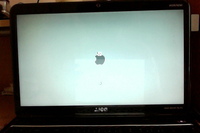

sovairon Posted August 26, 2013 Share Posted August 26, 2013 Hey guys finally got my cousin's macbook. i did everything with 10.8.2 install tutorial. and USB managed to boot. now i'm stuck with this. i've been waiting for 20 minutes now it shouldnt have taken this long. You have any idea about how to fix this? Thanks UPDATE: ok i solved stuck part. it was saying still waiting for root and i put usb on 2.0 port. now my problem is since that i don't have any other usb 2.0 ports and usb 3.0 doesnt work, i cant install it because i cant format the disk. now i got the crazy idea im gonna format the disk from iatkos l1 disk which lets me to use my only usb 2.0 then im going to boot from usb again and with keyboard im gonna install it. i hope UPDATE 2: ok format the HDD with iATKOS L1 Disk now i'm installing it. let's see where this goes Link to comment https://www.insanelymac.com/forum/topic/271573-guide-dell-inspiron-n5110/page/66/#findComment-1941386 Share on other sites More sharing options...
rob1980 Posted August 26, 2013 Share Posted August 26, 2013 put genericUSBXHCI.kext in EXTRA folder on usb installer, that will enable you to use USB 3 ports whilst you install if you get stuck again. Link to comment https://www.insanelymac.com/forum/topic/271573-guide-dell-inspiron-n5110/page/66/#findComment-1941414 Share on other sites More sharing options...
