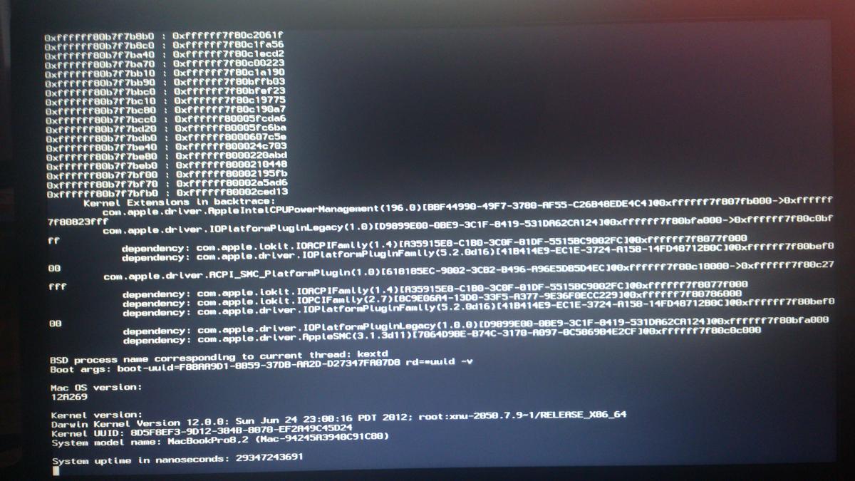

ZAZA__ Posted September 23, 2012 Share Posted September 23, 2012 hey guys, i got a problem... so i prepared my drive exactly like it said in the tutorial but i get a kernel panic when im trying to boot from it to install ml ... i dont know what i could've done wrong. anyway i attached a picture of the kernel panic screen, hope someone could figure it out, i really need my laptop :/ thanks in advance Link to comment Share on other sites More sharing options...
Madamido Posted September 24, 2012 Share Posted September 24, 2012 my HDD is now on MBR partition scheme and ML is installed on the 2nd partition (the first is reserved for windows 7). I flagged the 2nd partition "boot" in gparted and installed Chameleon on it and I keep getting "boot0: error" and I tried many kinds of boot1 and with bs=4096 and without it and still no success. What could be the reason for that? thanks a lot in advance Windows, mac, ubuntu MUST BE on a primary partition, installing windows first is always the best solution with windows vista/7 bootloader in the MBR using EasyBCD hey guys, i got a problem... so i prepared my drive exactly like it said in the tutorial but i get a kernel panic when im trying to boot from it to install ml ... i dont know what i could've done wrong. anyway i attached a picture of the kernel panic screen, hope someone could figure it out, i really need my laptop :/ thanks in advance you didn't mod your bios for the intelcpupowermanagement.kext post#1 in page 1 got the mod for A10 bios and post#815 in page 41 got the one for A11 bios make sure you use the correct one Link to comment Share on other sites More sharing options...

ZAZA__ Posted September 24, 2012 Share Posted September 24, 2012 you didn't mod your bios for the intelcpupowermanagement.kext post#1 in page 1 got the mod for A10 bios and post#815 in page 41 got the one for A11 bios make sure you use the correct one first of all, thank you for the answer but i didnt know i could use the wrong one .... did it at first with the a11 one, but i installed windows again now and flash with the bios mod from page 1, prepared the drive again, but i still get this kernel panic, the exact same one! :S did i mess my bios up when modding it with the a11 one? or what could be the problem ? Link to comment Share on other sites More sharing options...

Madamido Posted September 26, 2012 Share Posted September 26, 2012 first of all, thank you for the answer but i didnt know i could use the wrong one .... did it at first with the a11 one, but i installed windows again now and flash with the bios mod from page 1, prepared the drive again, but i still get this kernel panic, the exact same one! :S did i mess my bios up when modding it with the a11 one? or what could be the problem ? You don't have to flash or mod BIOS when you install windows or even format your HDD because the BIOS is stored in the motherboard Anyway you can now just download the mediafire file in post#815, use the original A11 bios.exe that came from Dell and flash your BIOS to A11, if it is A11 already then skip what I just said use the mod from the same file and you won't get that kernel panic Link to comment Share on other sites More sharing options...
Marcinho Posted September 26, 2012 Share Posted September 26, 2012 May you have "p-state stepper error 18", google that. Link to comment Share on other sites More sharing options...
