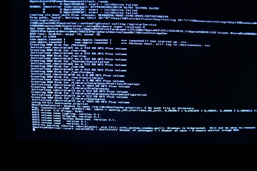

ginkosan Posted September 26, 2011 Share Posted September 26, 2011 I'm getting this KP when I try to install Lion on my Rampage III Extreme: AppleTyMCEDriver::start coreVIDPID = 0xffffffff Number of packages = 1 Number of cpus = 8 localhost kernel[0]: AppleTyMCEDriver::start memory monitor trough MCA It will go no further than that. Any ideas? Thanks. Link to comment https://www.insanelymac.com/forum/topic/267001-guide-lion-107-on-asus-x58-lga-1366-i7-9xx/page/7/#findComment-1753257 Share on other sites More sharing options...
ErmaC Posted September 26, 2011 Author Share Posted September 26, 2011 I'm getting this KP when I try to install Lion on my Rampage III Extreme: AppleTyMCEDriver::start coreVIDPID = 0xffffffff Number of packages = 1 Number of cpus = 8 localhost kernel[0]: AppleTyMCEDriver::start memory monitor trough MCA It will go no further than that. Any ideas? Thanks. Pls add your specs in signature... So we can see what hardware you have (GFX CPU...) Fabio Link to comment https://www.insanelymac.com/forum/topic/267001-guide-lion-107-on-asus-x58-lga-1366-i7-9xx/page/7/#findComment-1753261 Share on other sites More sharing options...
ginkosan Posted September 26, 2011 Share Posted September 26, 2011 Pls add your specs in signature...So we can see what hardware you have (GFX CPU...) Fabio Yes, sorry, I've done so now. "i7 930 | Asus Rampage III Extreme | Corsair Dominator GT 12GB | Nvidia Geforce 570 GTX |" A guess of mine would be too much RAM (?) Thanks Link to comment https://www.insanelymac.com/forum/topic/267001-guide-lion-107-on-asus-x58-lga-1366-i7-9xx/page/7/#findComment-1753264 Share on other sites More sharing options...
ErmaC Posted September 26, 2011 Author Share Posted September 26, 2011 Yes, sorry, I've done so now. "i7 930 | Asus Rampage III Extreme | Corsair Dominator GT 12GB | Nvidia Geforce 570 GTX |" A guess of mine would be too much RAM (?) Thanks No at all...(RAM is not a matter) be more descriptive... When and after what... happen? You done well the step 6? Boot your USB device and install Lion on /Volumes/Lion as you normally would.Wait for the installation to finish. Fabio Link to comment https://www.insanelymac.com/forum/topic/267001-guide-lion-107-on-asus-x58-lga-1366-i7-9xx/page/7/#findComment-1753267 Share on other sites More sharing options...
ginkosan Posted September 26, 2011 Share Posted September 26, 2011 No at all...(RAM is not a matter)be more descriptive... When and after what... happen? You done well the step 6? Fabio Ah sorry, I should've been more thorough. The KP occurs when I try step 6. I boot the USB and the installation with -v npci=0x2000 (because I got stuck at the PCI configuration thing) and then it KPs on AppleTyMCEDriver::start coreVIDPID = 0xffffffff Number of packages = 1 Number of cpus = 8 localhost kernel[0]: AppleTyMCEDriver::start memory monitor trough MCA. Link to comment https://www.insanelymac.com/forum/topic/267001-guide-lion-107-on-asus-x58-lga-1366-i7-9xx/page/7/#findComment-1753271 Share on other sites More sharing options...
ErmaC Posted September 26, 2011 Author Share Posted September 26, 2011 Ah sorry, I should've been more thorough. The KP occurs when I try step 6. I boot the USB and the installation with -v npci=0x2000 (because I got stuck at the PCI configuration thing) and then it KPs on AppleTyMCEDriver::start coreVIDPID = 0xffffffff Number of packages = 1 Number of cpus = 8 localhost kernel[0]: AppleTyMCEDriver::start memory monitor trough MCA. Ok... So add into the org.chameleon.Boot.plist (is located into the USB /Extra/ ) the key nspci=0x2000 How you can do this?... from a old Snow system for example... And... you not need to add anymore the -v flag... Let me know. Fabio Link to comment https://www.insanelymac.com/forum/topic/267001-guide-lion-107-on-asus-x58-lga-1366-i7-9xx/page/7/#findComment-1753275 Share on other sites More sharing options...
ginkosan Posted September 27, 2011 Share Posted September 27, 2011 Ok... So add into the org.chameleon.Boot.plist (is located into the USB /Extra/ ) the key nspci=0x2000 How you can do this?... from a old Snow system for example... And... you not need to add anymore the -v flag... Let me know. Fabio Hi again. I tried that but it still Kernel Panics im afraid. Here's a picture of the screen when it KP. Link to comment https://www.insanelymac.com/forum/topic/267001-guide-lion-107-on-asus-x58-lga-1366-i7-9xx/page/7/#findComment-1753357 Share on other sites More sharing options...
DefKorns Posted September 27, 2011 Share Posted September 27, 2011 Hi again. I tried that but it still Kernel Panics im afraid. Here's a picture of the screen when it KP. boot your USB with this kernel flags -v npci=0x2000 Link to comment https://www.insanelymac.com/forum/topic/267001-guide-lion-107-on-asus-x58-lga-1366-i7-9xx/page/7/#findComment-1753374 Share on other sites More sharing options...
ginkosan Posted September 27, 2011 Share Posted September 27, 2011 boot your USB with this kernel flags-v npci=0x2000 Hi, I've tried that and it still KP on that specific line. Could it be that my GFX is not in the first pci-e slot? or is it bios related. Im gonna troubleshoot some more after work. Thank you for your help EDIT: Well I've done some more research now and it seems to be a video card problem "AppleTyMCEDriver::start coreVIDPID = 0xfffffff Number of packages = 1 Number of cpus = 8 memory monitor trough MCA". Sadly I didn't find any solution to it. Maybe I forgot to turn of the OC on the card, maybe, can't remember. Could it be the issue? EDIT2: I got the installation to work now I re-did the USB and choose MacPro 3.1 instead of MacPro 4.1. What is the difference in those two anyway? Link to comment https://www.insanelymac.com/forum/topic/267001-guide-lion-107-on-asus-x58-lga-1366-i7-9xx/page/7/#findComment-1753379 Share on other sites More sharing options...

mm67 Posted September 27, 2011 Share Posted September 27, 2011 Hi, I've tried that and it still KP on that specific line. Could it be that my GFX is not in the first pci-e slot? or is it bios related. Im gonna troubleshoot some more after work. Thank you for your help EDIT: Well I've done some more research now and it seems to be a video card problem "AppleTyMCEDriver::start coreVIDPID = 0xfffffff Number of packages = 1 Number of cpus = 8 memory monitor trough MCA". Sadly I didn't find any solution to it. Maybe I forgot to turn of the OC on the card, maybe, can't remember. Could it be the issue? EDIT2: I got the installation to work now I re-did the USB and choose MacPro 3.1 instead of MacPro 4.1. What is the difference in those two anyway? My Rampage III Gene does exactly same, Mac Pro 4,1 or 5,1 system definitions don't work. Link to comment https://www.insanelymac.com/forum/topic/267001-guide-lion-107-on-asus-x58-lga-1366-i7-9xx/page/7/#findComment-1753554 Share on other sites More sharing options...
DefKorns Posted September 27, 2011 Share Posted September 27, 2011 ... EDIT2: I got the installation to work now I re-did the USB and choose MacPro 3.1 instead of MacPro 4.1. What is the difference in those two anyway? MacPro3,1 (CPU core2Quad - Better GFX performance for some GPU Model) MacPro4,1 (Core i 1366 - Quad core CPU like i7 920, 930, etc) MacPro5,1 (Recommended for 6 core CPU like i7 970, 980x or 990x) Link to comment https://www.insanelymac.com/forum/topic/267001-guide-lion-107-on-asus-x58-lga-1366-i7-9xx/page/7/#findComment-1753587 Share on other sites More sharing options...
