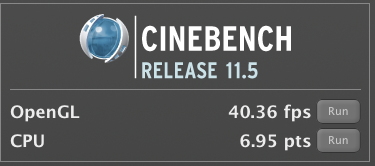

luisfdoc1 Posted September 21, 2011 Share Posted September 21, 2011 Because I do not use the onboard audio, but instead Creative X-Fi Titanium. PS: My GPU OpenGL performance still very slow. I am getting help for the Graphics in this thread: Fermi Guide Is it possible the cause might be from Leonize? (I already tried MacPro5,1 = same results) My Cinebench GPU result is 17 fps, using AGPM settings from people getting 36 fps (with same GPU) Thank for all your help! From your posted IOREG I see you use VoodooHDA... WHY?the patched AppleHDA didn't work for you? Fabio Link to comment https://www.insanelymac.com/forum/topic/267001-guide-lion-107-on-asus-x58-lga-1366-i7-9xx/page/6/#findComment-1751275 Share on other sites More sharing options...

luisfdoc1 Posted September 22, 2011 Share Posted September 22, 2011 Fabio, After some testing, I noticed that my GPU usage averaged 14% (running Cinebench in G-State 0). It never passed 52%. And that is why (I guess) I am getting low results. Do you have an idea why I have such a low usage? Also I ran GeekBench, and I am getting half the result I should be getting Any reason why I am getting such bad performance? Benchmark Summary Integer Score 4806 |||||| Floating Point Score 8954 ||||||||||| Memory Score 3320 |||| Stream Score 3966 ||||| Geekbench Score 5876 ||||||| System Information Operating System Mac OS X 10.7.1 (Build 11B26) Model MacPro4,1 Motherboard Apple Inc. Mac-F221BEC8 Rev 1.xx Processor Intel Core i7-950 @ 3.81 GHz 1 Processor, 4 Cores, 8 Threads Processor ID GenuineIntel Family 6 Model 26 Stepping 5 L1 Instruction Cache 32.0 KB x 4 L1 Data Cache 32.0 KB x 4 L2 Cache 256 KB x 4 L3 Cache 8.00 MB Memory 6.00 GB 1658 MHz DDR3 BIOS Apple Inc. MP41.88Z.0081.B08.1001221313 Thanks! Link to comment https://www.insanelymac.com/forum/topic/267001-guide-lion-107-on-asus-x58-lga-1366-i7-9xx/page/6/#findComment-1751686 Share on other sites More sharing options...

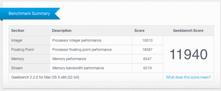

luisfdoc1 Posted September 22, 2011 Share Posted September 22, 2011 DefKorns, Can you run a benchmark in GeekBench? I am getting half the performance... Link to comment https://www.insanelymac.com/forum/topic/267001-guide-lion-107-on-asus-x58-lga-1366-i7-9xx/page/6/#findComment-1751786 Share on other sites More sharing options...
DefKorns Posted September 22, 2011 Share Posted September 22, 2011 DefKorns, Can you run a benchmark in GeekBench? I am getting half the performance... Results Link to comment https://www.insanelymac.com/forum/topic/267001-guide-lion-107-on-asus-x58-lga-1366-i7-9xx/page/6/#findComment-1751811 Share on other sites More sharing options...
luisfdoc1 Posted September 23, 2011 Share Posted September 23, 2011 Yeah.. I am getting half performance... Fabio, any idea? I hope you can help me... Thanks Benchmark Summary Integer Score 4806 |||||| Floating Point Score 8954 ||||||||||| Memory Score 3320 |||| Stream Score 3966 ||||| Geekbench Score 5876 ||||||| Anybody with a P6X58D-E MoBo? Results Link to comment https://www.insanelymac.com/forum/topic/267001-guide-lion-107-on-asus-x58-lga-1366-i7-9xx/page/6/#findComment-1751843 Share on other sites More sharing options...
luisfdoc1 Posted September 23, 2011 Share Posted September 23, 2011 PROBLEM SOLVED!!!!!!!!!!!!!!!!!!! Finally I was able to find my performance issue. It was in the BIOS! . I had SpeedStep and C-State Disabled. By enabling SpeedStep I gained almost all the performance, and the C-State gave me a little bit more! ----- Link to comment https://www.insanelymac.com/forum/topic/267001-guide-lion-107-on-asus-x58-lga-1366-i7-9xx/page/6/#findComment-1751868 Share on other sites More sharing options...
DefKorns Posted September 23, 2011 Share Posted September 23, 2011 PROBLEM SOLVED!!!!!!!!!!!!!!!!!!! Finally I was able to find my performance issue. It was in the BIOS! . I had SpeedStep and C-State Disabled. By enabling SpeedStep I gained almost all the performance, and the C-State gave me a little bit more! ----- LoL! Sometimes we miss the simple things In my case was to change the the audio output and i was like crazy trying to figure why the sound didn't work. Link to comment https://www.insanelymac.com/forum/topic/267001-guide-lion-107-on-asus-x58-lga-1366-i7-9xx/page/6/#findComment-1751907 Share on other sites More sharing options...
