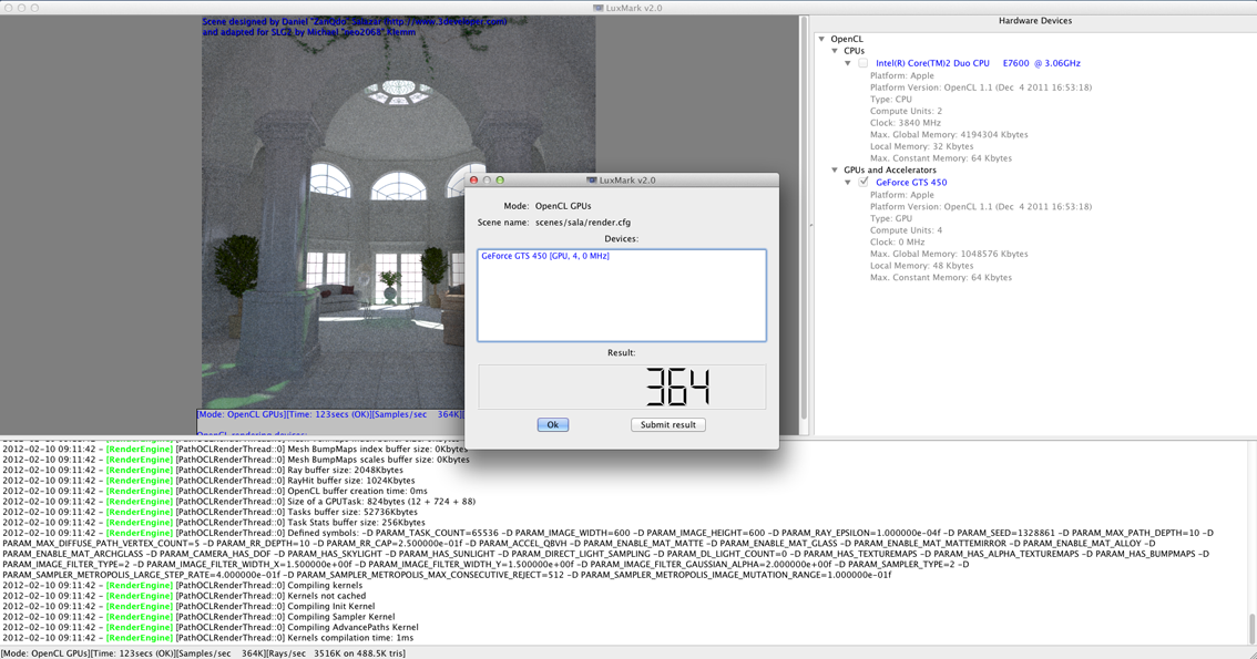

Carstiman Posted February 10, 2012 Share Posted February 10, 2012 hello, GTS450 working GeForceGLDriver.bundle/Contents/MacOS/GeForceGLDriver: 78e883f8 02 7c11 replaced by: 78e883f8 03 7c11 GeForceGLDriver.bundle/Contents/MacOS/libclh.dylib: 8B 87 1C 0C 00 00 89 06 8B 87 20 0C 00 00 89 02 replaced by: 31 C0 FF C0 FF C0 89 06 31 C0 89 02 90 90 90 90 Insert the device ID in "NVDAGF100Hal.kext" info.plist <key>IOPCIPrimaryMatch</key> <string> 0x06c010de&0xffe0ffff 0x0dc010de&0xffc0ffff 0x0e2010de&0xffe0ffff 0x0ee010de&0xffe0ffff 0x0f0010de&0xffc0ffff 0x104010de&0xffc0ffff 0x124010de&0xffc0ffff 0x0dc410de&0xffc0ffff </string> but Boinc http://boinc.berkeley.edu/ won´t reconice the openCL like it does before in 10.7.2 Link to comment https://www.insanelymac.com/forum/topic/266318-opencl-fix-for-non-gf100gf110-cards-aka-ccsm-21/page/2/#findComment-1794780 Share on other sites More sharing options...

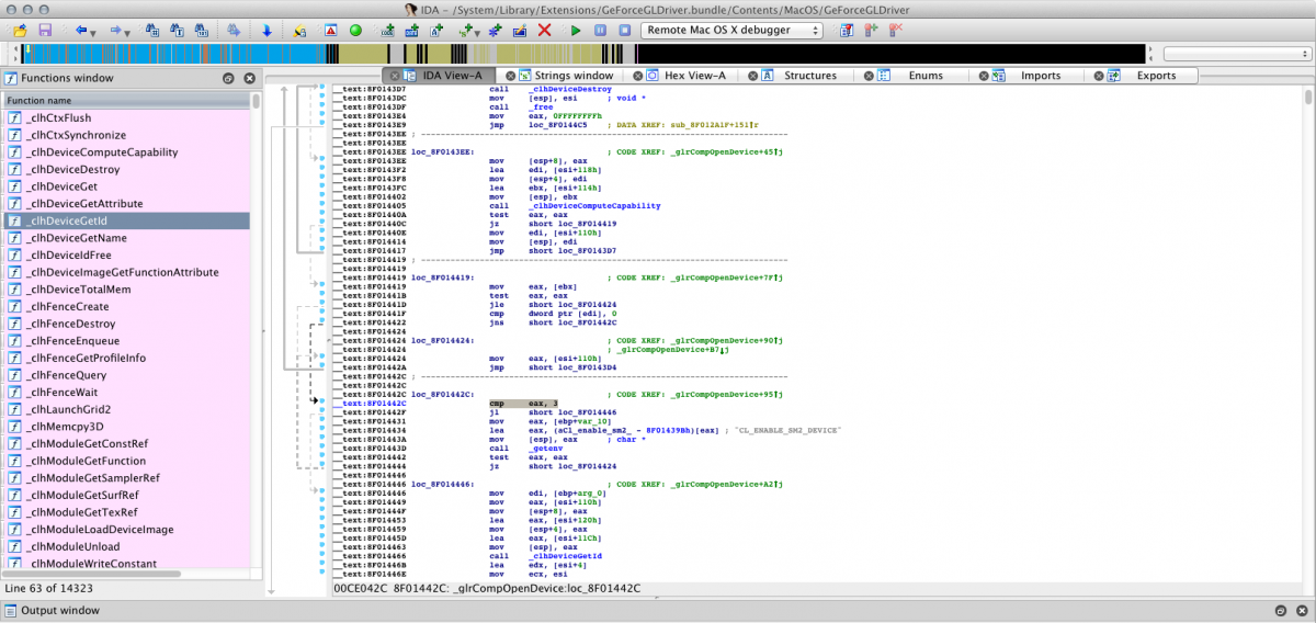

oSxFr33k Posted February 13, 2012 Share Posted February 13, 2012 @cmf, Same hex code in 10.7.2 as in 10.7.3 for for the libclh.dylib, but there is a change in the GeForceGLDriver see below From Netkas Thread: Find EB A8 83 F8 02 7C 15 replace 02 with 03 to get EB A8 83 F8 03 7C 15 Find 78 E8 83 F8 02 7C 11 replace 02 with 03 to get 78 E8 83 F8 03 7C 11 I cannot find the second set "78 E8 83 F8 02 7C 11" @cmf What exactly is this command for or what will it do? echo "export CL_ENABLE_SM2_DEVICE=1" >> ~/.profile Thanks EDITED A FEW MINUTES LATER: My Fault I was using Crossover with the windows Editor HxD and for some reason it did not find the second set hex string. Ran a Mac Hex editor and it found it. Sorry!! I still have the question about the export CL_ENABLE_SM2_DEVICE=1 Link to comment https://www.insanelymac.com/forum/topic/266318-opencl-fix-for-non-gf100gf110-cards-aka-ccsm-21/page/2/#findComment-1795662 Share on other sites More sharing options...
cmf Posted February 14, 2012 Author Share Posted February 14, 2012 What exactly is this command for or what will it do? echo "export CL_ENABLE_SM2_DEVICE=1" >> ~/.profile it's basically the same as the GeForceGLDriver binary patch, but at the user level (and w/o modifying the binary, obviously). i.e. if the binary patch isn't applied, opencl will only function if "CL_ENABLE_SM2_DEVICE" is defined/set in the users environment vars (default set can be changed through the .profile file). so, if apple ever decides to add an additional "is device opencl capable?" check or shuffle the code around, so that the binary patch doesn't work any more (which i'm surprised it did in 10.7.3), opencl should still work (to some extent*) using the "CL_ENABLE_SM2_DEVICE" define. downside and (*): this really only works if a program is started by the user and the program doesn't ignore/overwrite the cl define or does some other weird stuff (like luxmark does ...). some system services/programs that use opencl and are started by another user also won't be able to use the opencl device (just open activity monitor and look which processes aren't owned by your user). and ftr and the people that are interested: the GeForceGLDriver binary patch changes the "cmp eax, 2" to a "cmp eax, 3" (note: eax at this point contains the major version of the nvidia compute capability (cc/sm), which is 2 for fermi gpus), so the subsequent jump condition will evaluate to true (instead of false, b/c 2 is not less than 2, but 2 < 3!) and continue @loc_8F014446. if the binary patch has not been applied (it still says "cmp eax, 2"), it will continue and check if "CL_ENABLE_SM2_DEVICE" is defined in the users env vars. if so, it will also continue @loc_8F014446. if not, the device will be "destroyed" and be "declared" not opencl capable. Link to comment https://www.insanelymac.com/forum/topic/266318-opencl-fix-for-non-gf100gf110-cards-aka-ccsm-21/page/2/#findComment-1796084 Share on other sites More sharing options...
