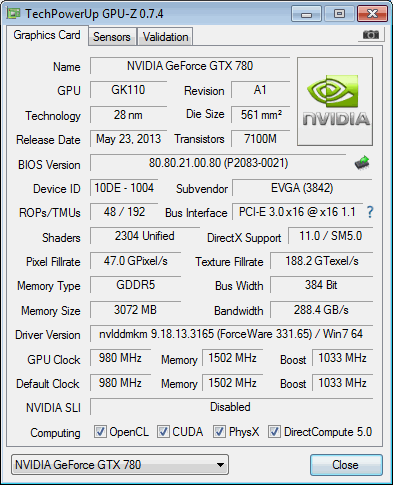

Chibi Delenn Posted November 15, 2013 Share Posted November 15, 2013 OK, I have the ROM zipped for you. My stepping says A1, so it doesn't look to be a GK110B unless you know otherwise. Edit: This says my board is based on the B1 stepping, but GPU-Z disagrees. Yay? GK110.zip Link to comment https://www.insanelymac.com/forum/topic/266318-opencl-fix-for-non-gf100gf110-cards-aka-ccsm-21/page/6/#findComment-1968121 Share on other sites More sharing options...
cmf Posted November 15, 2013 Author Share Posted November 15, 2013 yeah, definitely GK110B: "GK110B P2083 SKU 21 VGA BIOS" (@0x686)original GTX 780 is just "GK110" and "SKU 20", Titan is "SKU 10" and GTX 780 Ti is "SKU 30".The "A1" in GPU-Z might be hardcoded, what does it say in the OS X System Information / Revision ID? Link to comment https://www.insanelymac.com/forum/topic/266318-opencl-fix-for-non-gf100gf110-cards-aka-ccsm-21/page/6/#findComment-1968204 Share on other sites More sharing options...
