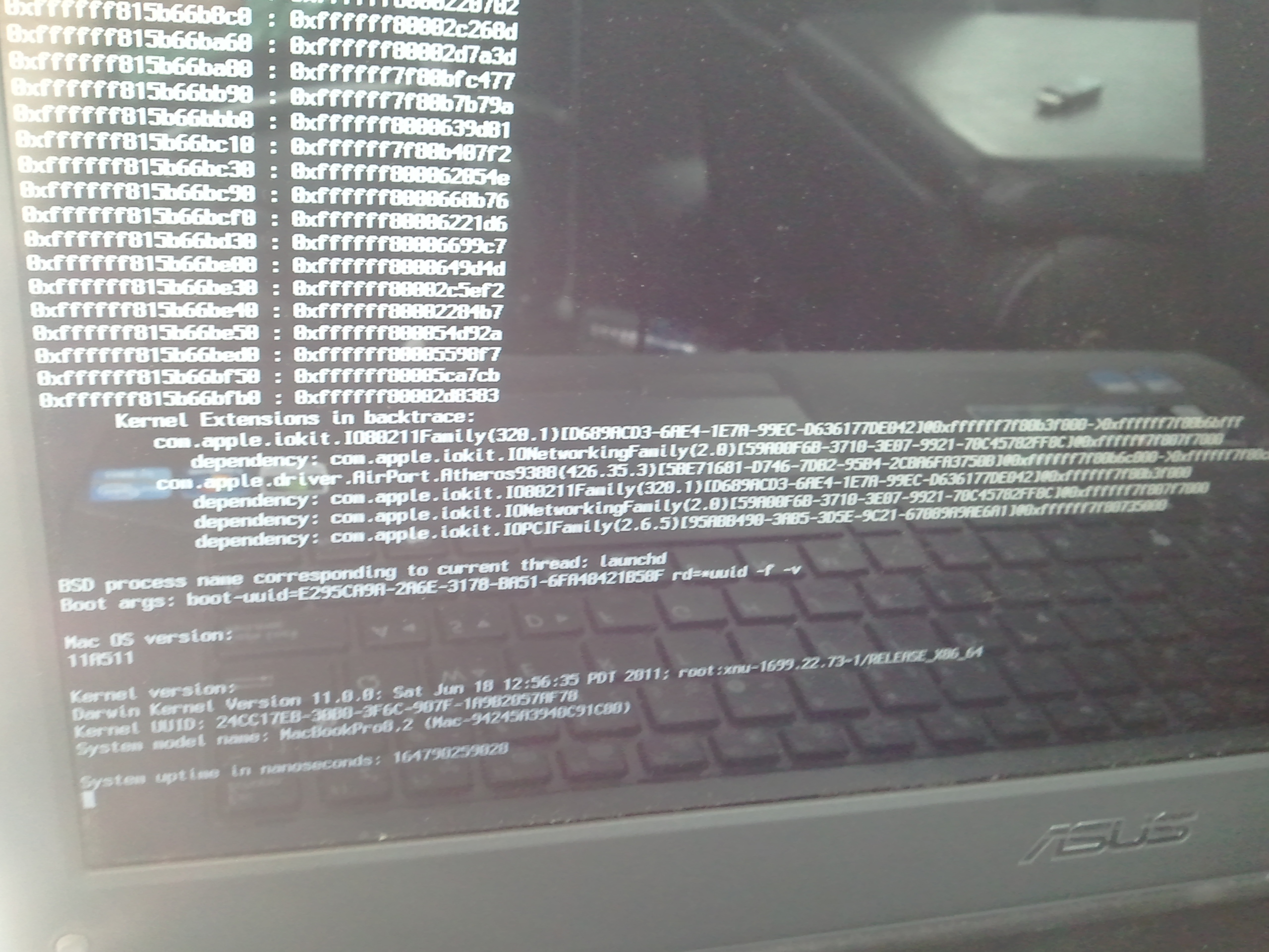

jeffc2009 Posted July 11, 2011 Author Share Posted July 11, 2011 When I get home from work I sure can, you're having wifi issues too? I am lost on what to do Are you getting ath attached failed in verbose mode as well? I got wifi, but kp's when i shut down and start backup. Error with IOHIDFamily with dependancies AppleKeyStore. Had to restart after 2-3 times it starts.. Don't know why? Link to comment https://www.insanelymac.com/forum/topic/261968-g73swg74sw-lion-gm-install/page/3/#findComment-1713002 Share on other sites More sharing options...
littlepapapump Posted July 11, 2011 Share Posted July 11, 2011 I got wifi, but kp's when i shut down and start backup. Error with IOHIDFamily with dependancies AppleKeyStore. Had to restart after 2-3 times it starts.. Don't know why? I'm getting IOPCIfamily panic atheros panic usb panic at times and audio at times Link to comment https://www.insanelymac.com/forum/topic/261968-g73swg74sw-lion-gm-install/page/3/#findComment-1713009 Share on other sites More sharing options...
jeffc2009 Posted July 11, 2011 Author Share Posted July 11, 2011 I'm getting IOPCIfamily panic atheros panic usb panic at times and audio at times There's a few files that you need, but before I upload it I have to test the rest!!! I started with that, then audio and now applekeystore. I am having MaLon look at it to see if he can figure it out. I had google that but nothing!!!. But I have all that worked out and running. I thought I had it all running until i hit restart! Just be patient with me.. I thought you don't have your laptop with you?? Link to comment https://www.insanelymac.com/forum/topic/261968-g73swg74sw-lion-gm-install/page/3/#findComment-1713020 Share on other sites More sharing options...

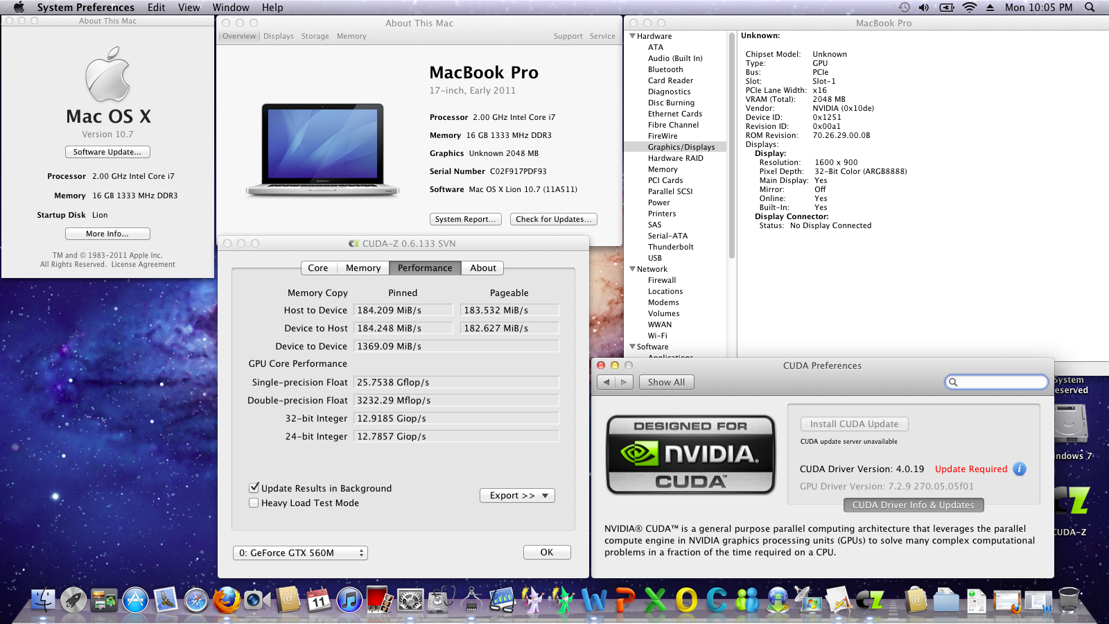

jeffc2009 Posted July 12, 2011 Author Share Posted July 12, 2011 G74SX nVidia GTX560M http://www.insanelymac.com/forum/index.php...t&p=1710334 Method that osxfr33k used two posts back worked also. If you noticed that device to device is still in mib/s, not giop/s. You have some acceleration, but not full cuda. You might want to try some other nvidia gfx drivers!!! @jeffc2009, I just installed cuda and binary hex changed the values per netkas hack. I also got a pre module for Chameleon to support the GTX560m from Azimutz which he wanted me to test and said it will be in the next release!! When launch photo booth I keep getting the spinwheel. Not he rainbow apple spinwheel but the one that looks like the one on startup. Then when I take a snapshot, I get an error unable to save. I am not sure what you are encountering with GTX 560M. That's one thing you have to figure out yourself. As for photo, it ask for gfx and webcam. Does your webcam work in facetime? I for the life of me can't get the wifi working, on boot ath attached failed, im lost Whatever you did to the system is locking up the io80211. Did you touch another kext and changed info.plist to reflect your wifi? I used jeffc2009's new kexts it solved my random kernel panic and freeze issues but USB 3.0 still will only work if I remove battery before booting and does not work at all in windows In bios load default configuration and disable legacy devices!!! Let me know if that fix it. Link to comment https://www.insanelymac.com/forum/topic/261968-g73swg74sw-lion-gm-install/page/3/#findComment-1713324 Share on other sites More sharing options...

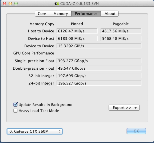

oSxFr33k Posted July 12, 2011 Share Posted July 12, 2011 Not sure about that here is my screenshot of the GTX560M. Link to comment https://www.insanelymac.com/forum/topic/261968-g73swg74sw-lion-gm-install/page/3/#findComment-1713521 Share on other sites More sharing options...
littlepapapump Posted July 12, 2011 Share Posted July 12, 2011 If you noticed that device to device is still in mib/s, not giop/s. You have some acceleration, but not full cuda. You might want to try some other nvidia gfx drivers!!! I am not sure what you are encountering with GTX 560M. That's one thing you have to figure out yourself. As for photo, it ask for gfx and webcam. Does your webcam work in facetime? Whatever you did to the system is locking up the io80211. Did you touch another kext and changed info.plist to reflect your wifi? In bios load default configuration and disable legacy devices!!! Let me know if that fix it. I have not done anything, maybe I'll just format the hdd and try again, maybe the issue is snow leopard on the same hdd, im lost. Lol Link to comment https://www.insanelymac.com/forum/topic/261968-g73swg74sw-lion-gm-install/page/3/#findComment-1713646 Share on other sites More sharing options...

jeffc2009 Posted July 12, 2011 Author Share Posted July 12, 2011 Not sure about that here is my screenshot of the GTX560M. Look like you got cuda to work! I have not done anything, maybe I'll just format the hdd and try again, maybe the issue is snow leopard on the same hdd, im lost. Lol I had it working in both. Don't know what you did. A fresh install should clear it up! Jeff: I am using all of your files, but the io80211 from you first Lion pack. The other one kept doing the same thing as in snow leopard where it would just grab apipa address.... out of nowhere the backlight on keyboard wont work again. I ran the dsdt auto patcher in windows this time and am using that... haven't had any kps since... sleep works too... I ran the runme from mald0n and going to forward that to him to see if he can double check my dsdt.aml and let me know if there is something wrong with it. But now i have a fairly stable 10.7 that works pretty well your wifi might be on a different setup than g73sw. Link to comment https://www.insanelymac.com/forum/topic/261968-g73swg74sw-lion-gm-install/page/3/#findComment-1713683 Share on other sites More sharing options...
