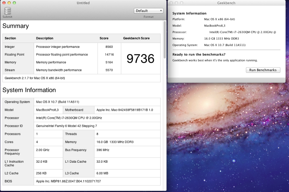

jeffc2009 Posted July 21, 2011 Author Share Posted July 21, 2011 anyone noticed that the speedster for lion gm 166 is not working correctly! It shows the speedsters but my geekbench never gets above 6800. Link to comment https://www.insanelymac.com/forum/topic/261968-g73swg74sw-lion-gm-install/page/6/#findComment-1718900 Share on other sites More sharing options...

westsdad Posted July 22, 2011 Share Posted July 22, 2011 anyone noticed that the speedster for lion gm 166 is not working correctly! It shows the speedsters but my geekbench never gets above 6800. Jeff, I've been consistently in the 97xx to 98xx range in Geekbench. I'm on a G74SX-BBK7 and have 16GB memory, the Dell DW1510 for a wireless card, and the GTX 560M. I'm running a DSDT from MaLd0n based on my machine (previous to the possible updates that I've seen a few posts back), and the Lion GM AppleIntelCPUPowerManagement.kext that I patched using flaKed's GM patch. Only other differences are that I'm using the vanilla GM IO80211Family.kext (due to Dell DW1510 being recognized "out of the box"), installed Lnx2Mac's RealtekRTL81xx-0_0_67%2B.pkg instead of the RealtekRTL81xx.kext in your package (probably no difference), and have no specific nVidia Fermi driver install package available yet (not an issue). BTW, thanks for all of your efforts and for MaLd0n's participation in this thread and his efforts. I tried to get the card reader to work, but there is a fundamental configuration issue that doesn't configure the card specific to required power, device class, device subclass, device protocol, and possibly needs a "Probe all LUNs on each SCSI device" setting in mach_kernel to accomplish this. Same issue in Ubuntu that it doesn't recognize our card reader. Haven't had a chance to compile a kernel in Ubuntu with a "Probe all LUNs on each SCSI device" setting to verify this (due to lack of time and lack of knowledge). westsdad > Link to comment https://www.insanelymac.com/forum/topic/261968-g73swg74sw-lion-gm-install/page/6/#findComment-1719668 Share on other sites More sharing options...
oSxFr33k Posted July 22, 2011 Share Posted July 22, 2011 @westsdad, I am seeing the same issue as Jeff around 6800 Geekbench score for me. Its the floating point score on the processor that is bringing my score down when I compare it to yours. Maybe the GeForceGLDriver.bundle hex mod by Netkas is causing this or not, or is it the AICPUPM Speedstepper GM Speedstepper mod causing this? Are you using the Module Azimutz made for us? He said it would be in later builds not sure if it is yet or not? Have you done the hex mod on the GL binary or just using the module Azimutz prepared with Cuda only? Thanks Link to comment https://www.insanelymac.com/forum/topic/261968-g73swg74sw-lion-gm-install/page/6/#findComment-1720013 Share on other sites More sharing options...
jeffc2009 Posted July 22, 2011 Author Share Posted July 22, 2011 @westsdad, I am seeing the same issue as Jeff around 6800 Geekbench score for me. Its the floating point score on the processor that is bringing my score down when I compare it to yours. Maybe the GeForceGLDriver.bundle hex mod by Netkas is causing this or not, or is it the AICPUPM Speedstepper GM Speedstepper mod causing this? Are you using the Module Azimutz made for us? He said it would be in later builds not sure if it is yet or not? Have you done the hex mod on the GL binary or just using the module Azimutz prepared with Cuda only? Thanks oSxFr33k, I had gone back to AICPUPM 159 for speedstep. As far as I know, this is due to stepper mod, not GeForceGLDriver.bundle hex mod. Jeff, I've been consistently in the 97xx to 98xx range in Geekbench. I'm on a G74SX-BBK7 and have 16GB memory, the Dell DW1510 for a wireless card, and the GTX 560M. I'm running a DSDT from MaLd0n based on my machine (previous to the possible updates that I've seen a few posts back), and the Lion GM AppleIntelCPUPowerManagement.kext that I patched using flaKed's GM patch. Only other differences are that I'm using the vanilla GM IO80211Family.kext (due to Dell DW1510 being recognized "out of the box"), installed Lnx2Mac's RealtekRTL81xx-0_0_67%2B.pkg instead of the RealtekRTL81xx.kext in your package (probably no difference), and have no specific nVidia Fermi driver install package available yet (not an issue). BTW, thanks for all of your efforts and for MaLd0n's participation in this thread and his efforts. I tried to get the card reader to work, but there is a fundamental configuration issue that doesn't configure the card specific to required power, device class, device subclass, device protocol, and possibly needs a "Probe all LUNs on each SCSI device" setting in mach_kernel to accomplish this. Same issue in Ubuntu that it doesn't recognize our card reader. Haven't had a chance to compile a kernel in Ubuntu with a "Probe all LUNs on each SCSI device" setting to verify this (due to lack of time and lack of knowledge). westsdad > You are getting those kid of scores because you are using geek bench 64 bit version. Unless you have higher core I7. I have tried to fix the card reader with no luck! http://developer.download.nvidia.com/compu....0.21_macos.dmg cuda 4.0.21 Thanks for the link! It's working great without login pop ups anymore and I had changed it in OP. hi Jeff, Thanks for the updated package, I still have no sleep. But i didnt do a fresh install with the newest package, just installed over what i had. I do have the same problem about usb mouse and KP. Thanks Daryl UPDATE: For completeness, i did a fresh install and used your latest package, every if working except for backlit, iv even tried the other fix, about the windows files. lol no luck backlit worked great in 10.6.8, so I'm sure its just a simple config somewhere, i just don't know where. can i just install the 10.6.8 package of yours ? will that work under lion? Unless i find a solution, ill just stay here until you get back in town. thanks UPDATE Update: Ok i tried the extra file.zip that plourde put up and everything is working great, sleep, battery, backlite, but now i cant boot with a usb plugged in. going to go back to to your previous package and use plourdes extra folder, and everything should work perfect. My geekbench is 9600 - 9700 so im happy with this setup. ill post back with final results. During all these changes, I had lost backlit too! I know one time I had reverted back to 10.6.8 AICPUPM, AppleACPIPlatform and IOPCIFamily for backlit and sleep to work. But the only problem was it will KP after restart! Link to comment https://www.insanelymac.com/forum/topic/261968-g73swg74sw-lion-gm-install/page/6/#findComment-1720066 Share on other sites More sharing options...
oSxFr33k Posted July 23, 2011 Share Posted July 23, 2011 @jeffc2009, That was it jeff, it was the AICPUPM version 166 that gave me the lower score so I put the 159 back and my geek bench score is now 9715 now where it was 6800 before. The 6800 score was also in 64 bit geek bench. Link to comment https://www.insanelymac.com/forum/topic/261968-g73swg74sw-lion-gm-install/page/6/#findComment-1720100 Share on other sites More sharing options...

oSxFr33k Posted July 23, 2011 Share Posted July 23, 2011 @jeffc2009, Spoke too soon I dunno why my scores where 6800 the other night but I tried it again with AICPUPM build 166 GM and my score is now 9688 Link to comment https://www.insanelymac.com/forum/topic/261968-g73swg74sw-lion-gm-install/page/6/#findComment-1720110 Share on other sites More sharing options...
jeffc2009 Posted July 23, 2011 Author Share Posted July 23, 2011 @jeffc2009, Spoke too soon I dunno why my scores where 6800 the other night but I tried it again with AICPUPM build 166 GM and my score is now 9688 I had noticed that the cpu throttles when it wants to, that's why I went back to 159! I also noticed that in msrdumper/console. Doesn't matter when or what you dump at the cpu, stepping was all over the place. Link to comment https://www.insanelymac.com/forum/topic/261968-g73swg74sw-lion-gm-install/page/6/#findComment-1720114 Share on other sites More sharing options...

westsdad Posted July 23, 2011 Share Posted July 23, 2011 @westsdad,I am seeing the same issue as Jeff around 6800 Geekbench score for me. Its the floating point score on the processor that is bringing my score down when I compare it to yours. Maybe the GeForceGLDriver.bundle hex mod by Netkas is causing this or not, or is it the AICPUPM Speedstepper GM Speedstepper mod causing this? Are you using the Module Azimutz made for us? He said it would be in later builds not sure if it is yet or not? Have you done the hex mod on the GL binary or just using the module Azimutz prepared with Cuda only? Thanks oSxFr33k, I'm using the 2 byte hex mod on the GeForceGLDriver.bundle, addition of the vendor and device ID in NVDAGF100Hal.kext, and the cuda_devdriver_4.0.19_macos. Used the Chameleon version and module from Azimutz and the cuda_devdriver_4.0.19_macos with the same results. westsdad (This is for the GTX 560M in the G74SX.) You are getting those kid of scores because you are using geek bench 64 bit version. Unless you have higher core I7. I have tried to fix the card reader with no luck! jeffc2009, Good to know. Have the same core i7 as the G73SW. I spent a lot of time trying to get the card reader to work and never succeeded. westsdad Link to comment https://www.insanelymac.com/forum/topic/261968-g73swg74sw-lion-gm-install/page/6/#findComment-1720555 Share on other sites More sharing options...
