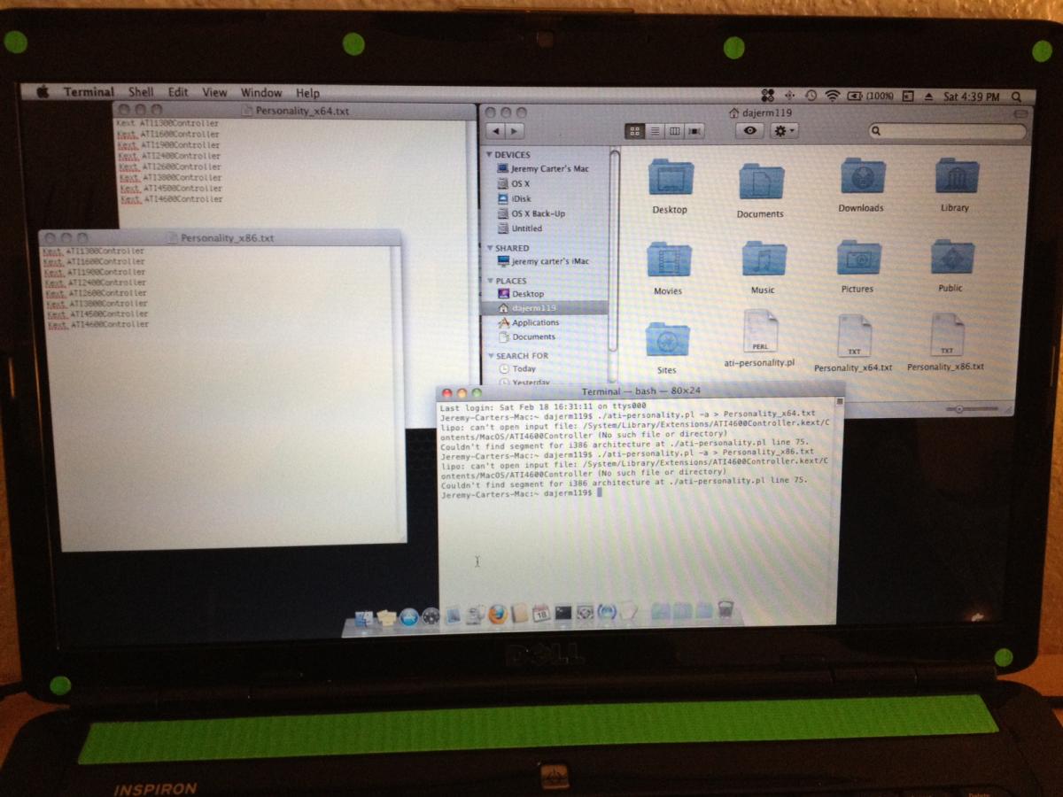

dajerm119 Posted February 18, 2012 Share Posted February 18, 2012 Got to bcc9's thread:- http://www.insanelym...howtopic=249642 download ati-personality.pl.0.8.zip. Extract the zip file & you'll get ati-personality.pl. Open terminal, change directory to the directory where ati-personality.pl is located & run it like this:- ./ati-personality.pl > Personality_x86.txt ./ati-personality.pl -x > Personality_x64.txt Both file contain personality for 32-bit & 64-bit support:- 32-bit: Personality_x86.txt 64-bit: Personality_x64.txt For example, if you're going to use Shrike personality, just open the Personality_xXX.txt file & look for Shrike:- Personality: Shrike ConnectorInfo count in decimal: 3 Disk offset in decimal 225944 0000000 02 00 00 00 40 00 00 00 09 01 00 00 02 01 00 03 0000010 02 00 00 00 00 01 00 00 09 01 00 00 20 01 02 02 0000020 00 04 00 00 04 03 00 00 00 01 00 00 10 00 01 01 convert the connector info to one-line form:- 020000004000000009010000020100030200000000010000090100002001020200040000040300000001000010000101 copy the above connector info & search it in ATIFramebuffer file. This is the line you need to edit, replaced it with your own connector info. When i do this both .txt files come out blank. I will keep trying but i think something else is going on. Maybe my system is corrupt? everything seems fine but i don't understand why this isnt working if it works for others. Link to comment https://www.insanelymac.com/forum/topic/252061-mobility-radeon-hd-4650full-resolution-with-qe-ci-working-on-internal-lvds-screen/page/24/#findComment-1797741 Share on other sites More sharing options...
neomatrix125 Posted February 18, 2012 Share Posted February 18, 2012 You need to have XCode installed as ther Perl script uses otool which is part of XCode. XCode is free in the App Store, it's a fairly big download but thats what you need! Link to comment https://www.insanelymac.com/forum/topic/252061-mobility-radeon-hd-4650full-resolution-with-qe-ci-working-on-internal-lvds-screen/page/24/#findComment-1797767 Share on other sites More sharing options...

dajerm119 Posted February 18, 2012 Share Posted February 18, 2012 Ok so I downloaded a different ATIFramebuffer.kext file, installed, repaired permissions the rebooted. I tried searching of the offsets in OxED with no luck once again. I also went ahead and ran the ati-personality.pl with the new ATIFramebuffer installed and actually got the results this time. This does lead me to believe that cOke is more than likely correct in the fact that with this card we may need a different version of radeondump to accuire the correct info. I may try and find a different version and see if I can get the right dump. However I'm still no closer to QE/CI. Why can't I find the offsets? I put them in at the "go to offset" box in OxED and hit enter and it takes me to the closest on to it but the one I need is not there. EDIT: I wonder if it's the version of RadeonHD or of radeondump. Maybe I'll try and get different versions of both. Link to comment https://www.insanelymac.com/forum/topic/252061-mobility-radeon-hd-4650full-resolution-with-qe-ci-working-on-internal-lvds-screen/page/24/#findComment-1797855 Share on other sites More sharing options...
neomatrix125 Posted February 18, 2012 Share Posted February 18, 2012 Try typing perl ati-personality.pl -a Link to comment https://www.insanelymac.com/forum/topic/252061-mobility-radeon-hd-4650full-resolution-with-qe-ci-working-on-internal-lvds-screen/page/24/#findComment-1797891 Share on other sites More sharing options...
dajerm119 Posted February 18, 2012 Share Posted February 18, 2012 This is what i got. and i am in 32bit mode. Link to comment https://www.insanelymac.com/forum/topic/252061-mobility-radeon-hd-4650full-resolution-with-qe-ci-working-on-internal-lvds-screen/page/24/#findComment-1797908 Share on other sites More sharing options...
