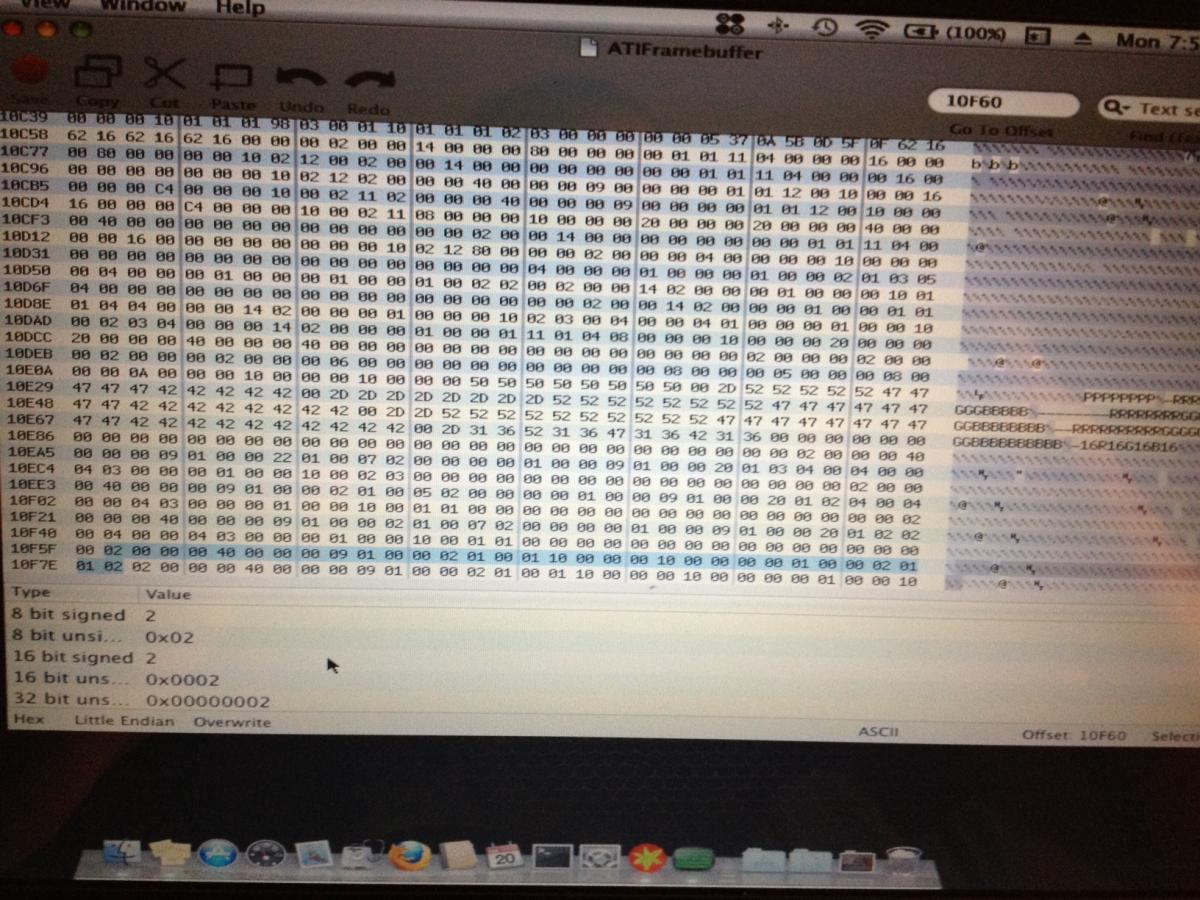

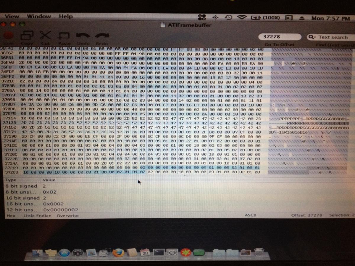

dajerm119 Posted February 20, 2012 Share Posted February 20, 2012 I repaired permissions with disk utility, I also fixed them your way cOke. I used the find and replace feature in HexEditor to replace the correct binary. After I saved it I went back into the file to make sure the changes were made and it appears so. I did replace the entire lines. Not just the areas that needed it, that should be ok though right. No luck rearrangeing boot loaders or with GraphicsEnabler=NO. I feel like I was getting close to QE/CI but couldn't figure out why those kexts wouldn't load. I repaired the permissions just like you guys told me to. I'm pretty sure this doesn't matter but my dell didn't come with this graphics card. I bought the correct motherboard and heatsink and swapped them out. I originaly had intel graphics. Now when I do the commans above after the first one it asks for password, I enter it and it runs the command. Then I run the second one just fine. When I run the last one it tells me permission denied so I then have to sudo -s first is this normal? I have also done sudo -s first then the commands. Link to comment https://www.insanelymac.com/forum/topic/252061-mobility-radeon-hd-4650full-resolution-with-qe-ci-working-on-internal-lvds-screen/page/26/#findComment-1798701 Share on other sites More sharing options...
c0ke Posted February 20, 2012 Share Posted February 20, 2012 (...) I used the find and replace feature in HexEditor to replace the correct binary.(...) (...) I did replace the entire lines. Not just the areas that needed it, that should be ok though right. (...) I didn't clearly understand what you did search for and what you did replace... How do you know the right content to search? With the editor, once you find the right 64bit offset, you should highlight the personalities and just paste the new ones(just 32 numbers without spaces e.g. 02000000400000000901000002010001) over them. (32 numbers or 16 couples or 4 x 4 couples since in 0xED you see a column mark every 4 couple...) And again for the very next 32. Same thing for 32bit offset. Nothing else. Try to understand if also ati4600controller loads. And to be sure the kext cache is refreshed boot with -f I think everything else is ok. Link to comment https://www.insanelymac.com/forum/topic/252061-mobility-radeon-hd-4650full-resolution-with-qe-ci-working-on-internal-lvds-screen/page/26/#findComment-1798733 Share on other sites More sharing options...
dajerm119 Posted February 20, 2012 Share Posted February 20, 2012 @cOke : I used HexEdit and searched for the personality I needed to replace (the one from pereine, i may have misspelled that)and then replaced it with the one you provided. Did this on both instances. Maybe I did it wrong. As I said before when I search for the offset on OxED it doesn't find it. Please see my posts from yesterday. Sorry, I'm doing this on my phone so I can quote myself . Thank you Let me ask it like this. If I search for the offsets that you provided in 0xED it should find that exact offset correct. Link to comment https://www.insanelymac.com/forum/topic/252061-mobility-radeon-hd-4650full-resolution-with-qe-ci-working-on-internal-lvds-screen/page/26/#findComment-1798766 Share on other sites More sharing options...
Lordadmiral Drake Posted February 20, 2012 Share Posted February 20, 2012 dajerm119: Do you actually know how hexadecimal works? 0xED finds the correct offset, however the list on the left always shows the offset of the first byte in the respective line. E.g. if you read 10F5F at the left then byte 10F60 is the second in the line. Link to comment https://www.insanelymac.com/forum/topic/252061-mobility-radeon-hd-4650full-resolution-with-qe-ci-working-on-internal-lvds-screen/page/26/#findComment-1798814 Share on other sites More sharing options...

dajerm119 Posted February 21, 2012 Share Posted February 21, 2012 I didn't clearly understand what you did search for and what you did replace... How do you know the right content to search? With the editor, once you find the right 64bit offset, you should highlight the personalities and just paste the new ones(just 32 numbers without spaces e.g. 02000000400000000901000002010001) over them. (32 numbers or 16 couples or 4 x 4 couples since in 0xED you see a column mark every 4 couple...) And again for the very next 32. Same thing for 32bit offset. Nothing else. Try to understand if also ati4600controller loads. And to be sure the kext cache is refreshed boot with -f I think everything else is ok. Yes the ATI4600controller.kext is loading. But it still,won't load the Framebuffer kext. I checked my work from yesterday against what you and Lordadmiral Drake said to do and I did it correctly. I will post pics of the edited personalities in OxED. Here is what is does when it hangs. Here they are in OxED. They look right to me, but as everyone can tell i'm a total noob. I did repair everything like you guys told me to and tried booting with -f. Now it just wants to hang at the apple logo. oh i am booting GraphicsEnabler=YES and -f. Link to comment https://www.insanelymac.com/forum/topic/252061-mobility-radeon-hd-4650full-resolution-with-qe-ci-working-on-internal-lvds-screen/page/26/#findComment-1798971 Share on other sites More sharing options...
kizwan Posted February 21, 2012 Share Posted February 21, 2012 You should use the original ATIFramebuffer.kext. Just need to patched the original ATIFramebuffer.kext. Link to comment https://www.insanelymac.com/forum/topic/252061-mobility-radeon-hd-4650full-resolution-with-qe-ci-working-on-internal-lvds-screen/page/26/#findComment-1799006 Share on other sites More sharing options...

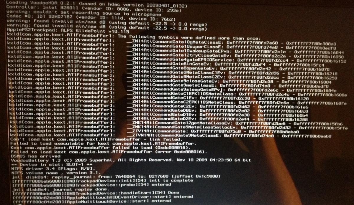

c0ke Posted February 21, 2012 Share Posted February 21, 2012 Ok anyway it seems that we're close to the solution. from the verbose pic I understand either that the framebuffer is corrupt or that the system didn't find it... Too many error messages. But I guess that when the display hangs at the apple logo, osx is loaded anyway. Try to change the sound volume or to open the cd tray or to shut down to verify. Are your modified ati kext all inside System/library/extensions and only there? Check if you have some of them in extra/extensions, in this case you should remove them... Ok, then remove atiframebuffer from S/L/E and start again from a clean 10.6.7's one. Link to comment https://www.insanelymac.com/forum/topic/252061-mobility-radeon-hd-4650full-resolution-with-qe-ci-working-on-internal-lvds-screen/page/26/#findComment-1799068 Share on other sites More sharing options...
dajerm119 Posted February 21, 2012 Share Posted February 21, 2012 You should use the original ATIFramebuffer.kext. Just need to patched the original ATIFramebuffer.kext. Well i used the one in crazybirdys original post but i will get the one from mucha and try again. Ok anyway it seems that we're close to the solution. from the verbose pic I understand either that the framebuffer is corrupt or that the system didn't find it... Too many error messages. But I guess that when the display hangs at the apple logo, osx is loaded anyway. Try to change the sound volume or to open the cd tray or to shut down to verify. Are your modified ati kext all inside System/library/extensions and only there? Check if you have some of them in extra/extensions, in this case you should remove them... Ok, then remove atiframebuffer from S/L/E and start again from a clean 10.6.7's one. As far as i can tell everything else is loaded. There are no ATI kext in Extra folder, i will start with a clean kext. as far as the ATI kexts i can see that ATIRadeonx2000.kext, ATI4600controller and the ATISupport are all loaded. Same thing, still hangs. Link to comment https://www.insanelymac.com/forum/topic/252061-mobility-radeon-hd-4650full-resolution-with-qe-ci-working-on-internal-lvds-screen/page/26/#findComment-1799073 Share on other sites More sharing options...
