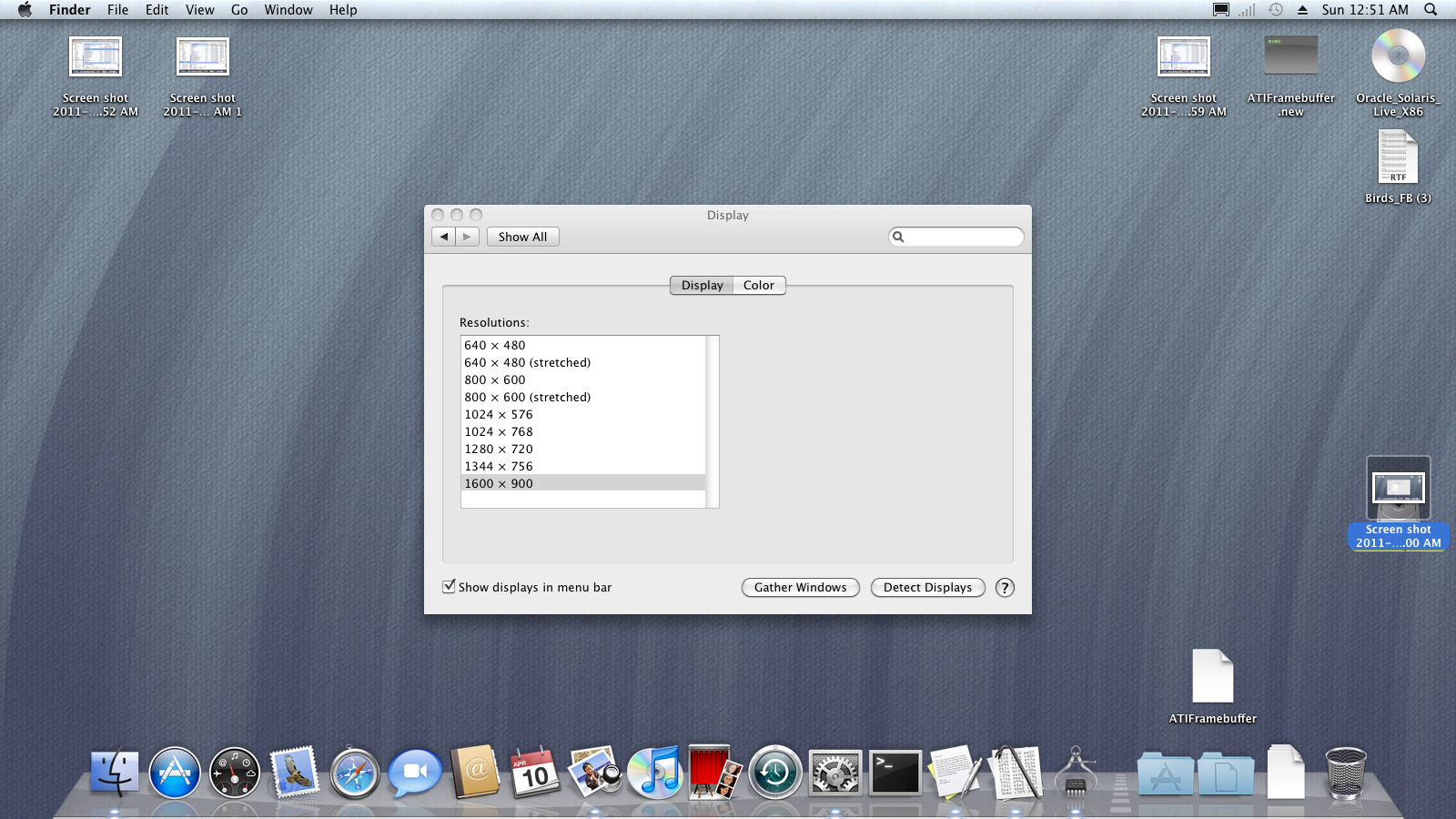

almuras Posted April 12, 2011 Share Posted April 12, 2011 QUOTE (Misha Vakulich @ Apr 10 2011, 07:28 PM)finally it works changed the Shrike personality to CODE 02 00 00 00 40 00 00 00 09 01 00 00 02 02 00 07 10 00 00 00 10 00 00 00 00 01 00 00 00 10 01 06 00 08 00 00 00 02 00 00 00 01 00 00 20 01 02 01 and fixed the issue with monitor according this guides http://www.insanelymac.com/forum/index.php?showtopic=208410 http://www.insanelymac.com/forum/index.php...p;?do=findComment&comment=1362685 Now I have 1600x900 with full qe/ci on my internal display. laptop: hp dv7 2130 with ATI HD4650 [1002:9480] Congratulations on your success! Interestingly, you used encoder 02, reserved for DIG_3 (Radeons HD 5XXX and above) and it worked! I tried to replicate your method but it did not work. I think I have pretty similar laptop Dell Studio 1747 with ATI HD4650 [1002:9480] and 1600x900 resolution. Any advice is much appreciated, I am begining to pull my hair... Link to comment https://www.insanelymac.com/forum/topic/252061-mobility-radeon-hd-4650full-resolution-with-qe-ci-working-on-internal-lvds-screen/page/11/#findComment-1669046 Share on other sites More sharing options...
Misha Vakulich Posted April 12, 2011 Share Posted April 12, 2011 Congratulations on your success! Interestingly, you used encoder 02, reserved for DIG_3 (Radeons HD 5XXX and above) and it worked! I tried to replicate your method but it did not work. I think I have pretty similar laptop Dell Studio 1747 with ATI HD4650 [1002:9480] and 1600x900 resolution. Any advice is much appreciated, I am begining to pull my hair... I was used a tricky method to get it work. I have 2 hdd on my laptop. On the first drive I have Fedora 14. So for the MacOsX installation and Driver manipulation I'm using VirtualBox that has access to my 2nd hdd. This method is good for investigating the problems with videocard. because modified ATI framebuffer will not be loading in VirtualBox. The exact method I was using: 1. I tried ti find a control flags. Tried this values(0x14,0x40,0x100,0x214) this is a control that could be. So if you have a simple black screen you are on right way 2. The same way I was trying the values for transmitter and encoder. when I put encoder 0x00 or 0x01 I can see the desktop but the image was broken. 3. I insert my edid value, make a dsdt patch for dual link. I still had a problems with display. 4. then I start to patch EDID again. in the http://www.insanelymac.com/forum/index.php?showtopic=208410 in step 6 Reboot, wait a while, or do whatever it takes to boot so the display is NOT right so I tried encoder 0x02 and it start work. maybe you should try other encoders. because it looks like that laptops with resolution higher than 1280x1024 could use other encoders than 0x01 and 0x00 Link to comment https://www.insanelymac.com/forum/topic/252061-mobility-radeon-hd-4650full-resolution-with-qe-ci-working-on-internal-lvds-screen/page/11/#findComment-1669227 Share on other sites More sharing options...
almuras Posted April 12, 2011 Share Posted April 12, 2011 I was used a tricky method to get it work. I have 2 hdd on my laptop.On the first drive I have Fedora 14. So for the MacOsX installation and Driver manipulation I'm using VirtualBox that has access to my 2nd hdd. This method is good for investigating the problems with videocard. because modified ATI framebuffer will not be loading in VirtualBox. The exact method I was using: 1. I tried ti find a control flags. Tried this values(0x14,0x40,0x100,0x214) this is a control that could be. So if you have a simple black screen you are on right way 2. The same way I was trying the values for transmitter and encoder. when I put encoder 0x00 or 0x01 I can see the desktop but the image was broken. 3. I insert my edid value, make a dsdt patch for dual link. I still had a problems with display. 4. then I start to patch EDID again. in the http://www.insanelymac.com/forum/index.php?showtopic=208410 in step 6 Reboot, wait a while, or do whatever it takes to boot so the display is NOT right so I tried encoder 0x02 and it start work. maybe you should try other encoders. because it looks like that laptops with resolution higher than 1280x1024 could use other encoders than 0x01 and 0x00 Thanks for your reply. For some reason I have only HDMI working properly, and black screens for VGA and LVDS. Do you think I should try different control flags for VGA and LVDS or black screens mean the control flags are correct? Link to comment https://www.insanelymac.com/forum/topic/252061-mobility-radeon-hd-4650full-resolution-with-qe-ci-working-on-internal-lvds-screen/page/11/#findComment-1669263 Share on other sites More sharing options...
Misha Vakulich Posted April 12, 2011 Share Posted April 12, 2011 Thanks for your reply. For some reason I have only HDMI working properly, and black screens for VGA and LVDS. Do you think I should try different control flags for VGA and LVDS or black screens mean the control flags are correct? Black screen with backlight enabled means that you have correct control flag, you should try different values for encoder and transmitter. That's works for me. Link to comment https://www.insanelymac.com/forum/topic/252061-mobility-radeon-hd-4650full-resolution-with-qe-ci-working-on-internal-lvds-screen/page/11/#findComment-1669423 Share on other sites More sharing options...
almuras Posted April 12, 2011 Share Posted April 12, 2011 Black screen with backlight enabled means that you have correct control flag, you should try different values for encoder and transmitter.That's works for me. I tried encoder values from 00 to 06, and transmitter 00, 01, 12, 22, 02 still nothing.... Link to comment https://www.insanelymac.com/forum/topic/252061-mobility-radeon-hd-4650full-resolution-with-qe-ci-working-on-internal-lvds-screen/page/11/#findComment-1669445 Share on other sites More sharing options...
