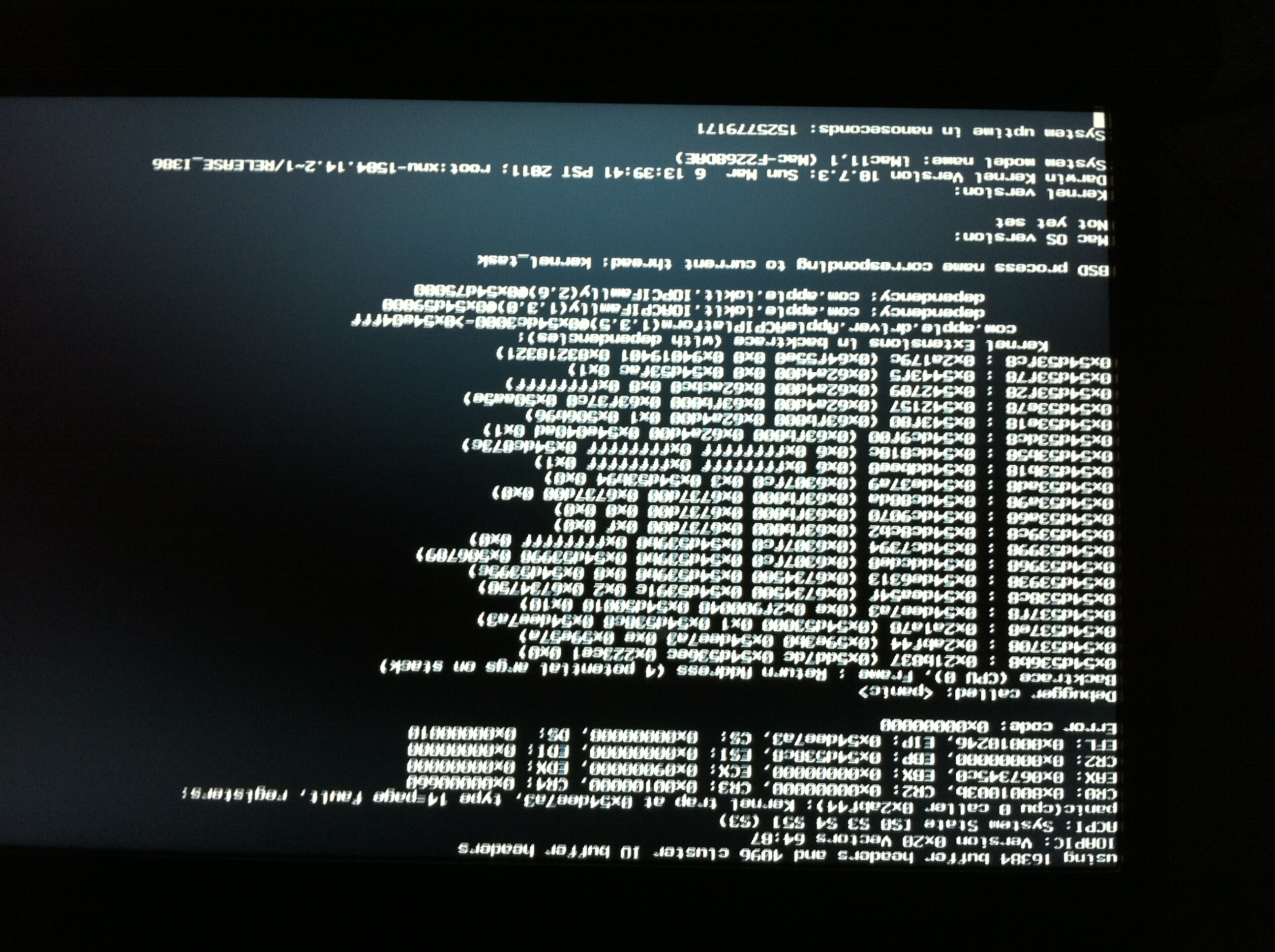

Kizwan, I installed DSDT.aml and changed the boot.plist but now I have kernel panic please see the image.
http://dl.dropbox.com/u/24426032/photo.JPG
Hi almuras,
I triple check your DSDT. Everything already checked out. It shouldn't cause kernel panic because I only add basic patch which supposedly for OSX's compatibility. In addition to basic patch, I only inject ATI's dual-link property for dual-link LVDS transmitter support. I already tested it myself & it didn't cause kernel panic on mine.
When the kernel panic happen, did you tried to boot for second time? Probably just a glitch. I did got kernel panic for no reason but it is very rare & hasn't happen since. Please list any foreign/3rd party kext you still using, including in Extra folder. Thank you.

For some reason the new DSDT.aml always gives kernel panic. I switched to your first version of DSDT.aml and was able to boot but all screens are black with both framebuffers. To see external screen with HDMI I need to remove DSDT and to add ati_rom. to extra. For some reason VNC does not work too when DSDT is loaded. I got so many errors trying to compile DSDT, did you fixed all those errors?
That's strange. Yes, I did fixed those errors. It's just caused by one "if" statement which don't belong to any control method. I have the same "if" statement & removed it but I don't get kernel panic. Please removed VoodooBattery.kext & try again. I believe the FakeSMC.kext is for sensors reading, please removed it but you'll need to replaced it with standard fakesmc.kext. You can find the standard fakesmc.kext at my Studio 1557's thread.

I am getting error failed load AppleIntelCpuPowerManagement.kext and then boot freezes.
Make sure removed the DSDT.AML. These are the modified boot file (Peregrine, Shrike & Vervet) for ATI Mobility Radeon HD4650 (device ID 0x9480):-
