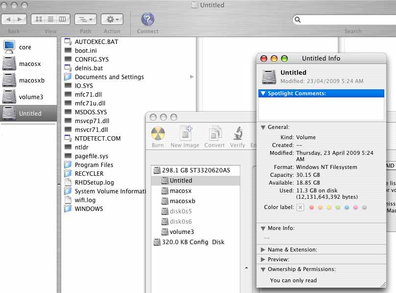

fabcat Posted November 15, 2006 Share Posted November 15, 2006 is your NTFS drive automount?how do u do that? I have 2 drives 1 for osx and 1 for xp but when i boot up my osx i always get this error "The disk you inserted was not readable by this computer." i can just click eject, but u know i want my osx box to be "perfect" can someone please help me fix this too please!! thank you The ntfs drive does automount. It mounts it as a volume (disk) just like my hfs+ disks except that I can only read files on it and not change anything. The volume is called "Untitled". I don't know how I did that. Macosx just does it for me. It mounts it automatically (with no errors). If I get info on the windows disk, it says the Format is: Windows NT Filesystem (I formated it as ntfs) and in the "Ownership and Permissions:" section it says "You can only read" and I can not change this. Which interface do you have your XP disk plugged into? Maybe it is on an interface controlled by the jmicron controller. The jmicron controller is not usable by macosx yet so if you are using this them macosx will not be able to see it. Can you try to open "Disk Utility" in macosx and see what partitions and disks you can see? As for " i always get this error "The disk you inserted was not readable by this computer."" if you read the whole of this thread, it is mentioned that that error is caused by the ez_backup function of the motherboard. I assume this is the same in your case, but I could be wrong. If it is called something like "Config Disk" then it is the same issue. We don't really know why it does that, but in any case, Matej has posted a fix in post #17 on how to get rid of the error: "Matej: I got rid of it! Simply connect your sata disk to the orange EZ-Backup Serial ATA connectors instead of the red Intel CH7R Serial ATA connector (see your user guide how do do this). Boot into bios and check that your boot disk is the right one (look for something like External Disk 0). I also did a clean install sice I messed up my system before while trying to fix this with a software method but I think you shoud be ok without any further modifications." http://forum.insanelymac.com/index.php?s=&...st&p=173693 Regards, Fabcat Link to comment Share on other sites More sharing options...
fabcat Posted November 15, 2006 Share Posted November 15, 2006 here is a picture showing the ntfs volume Link to comment Share on other sites More sharing options...
p_noch Posted November 15, 2006 Share Posted November 15, 2006 thank you, fabcat i'll try fix it Matej way then Link to comment Share on other sites More sharing options...
