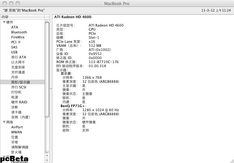

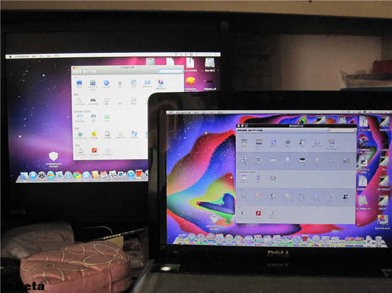

Ccc Posted March 12, 2011 Share Posted March 12, 2011 There's another successful example on the chinese forum, http://bbs.pcbeta.com/viewthread.php?tid=8...tra=&page=3 No.46. He used -ATI4600Controller.kext, from lion, added dev id (95521002, ATI4330,512MB) in INFO.PLIST -ATISupport.kext, from lion, -ATIFramebuffer.kext, from lion, -ATIRadeonX2000.kext from 10.6.6, and 3 other files, ATIRadeonX2000*.*. External VGA monitor QE/CI works, resolution could change. The internal monitor is shown in the attachment. however he did not mention other things as boot method, etc. [update] He used Chameleon RC5 747 download from kexts.com, without dsdt, and he did not mention about GraphicsEnabler=Yes. 7 hours later one more reported successfully supported QE/CI on external monitor. Link to comment https://www.insanelymac.com/forum/topic/245308-mobility-radeon-10667-guide-for-qeci-testing-107/page/4/#findComment-1653854 Share on other sites More sharing options...
kizwan Posted March 12, 2011 Share Posted March 12, 2011 External VGA monitor QE/CI works, resolution could change. The internal monitor is shown in the attachment. however he did not mention other things as boot method, etc. Exactly the same thing which I got (VGA). When plugged in monitor to HDMI port, internal screen automatically blank. Backlight still ON though. Based on the screenshot of the System Profiler, I bet he/she use official Chameleon 2 RC5 boot file with GraphicsEnabler=Yes. Link to comment https://www.insanelymac.com/forum/topic/245308-mobility-radeon-10667-guide-for-qeci-testing-107/page/4/#findComment-1653859 Share on other sites More sharing options...
wmarsh Posted March 12, 2011 Author Share Posted March 12, 2011 Exactly the same thing which I got (VGA). When plugged in monitor to HDMI port, internal screen automatically blank. Backlight still ON though. Based on the screenshot of the System Profiler, I bet he/she use official Chameleon 2 RC5 boot file with GraphicsEnabler=Yes. Kizwan, could you post your recompiled version of kabyl's bootloader. Some consistency here might be useful. Link to comment https://www.insanelymac.com/forum/topic/245308-mobility-radeon-10667-guide-for-qeci-testing-107/page/4/#findComment-1653946 Share on other sites More sharing options...
