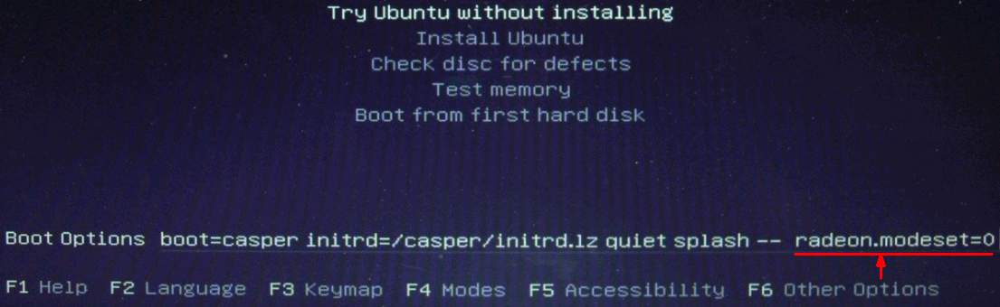

checcco Posted March 20, 2011 Share Posted March 20, 2011 I tried ubuntu live CD download from website, and you needn't to install it, just try the live cd. http://www.ubuntu.com/desktop/get-ubuntu/download Disabling KMS will give you more information I've been working for 3 days with ubuntu and talking to the radeon drivers guys on irc to understand how to get that values and make my 5650 work... Today I've had my first success... To get more information from ubuntu you have to disable kms with radeon driver. https://wiki.archlinux.org/index.php/ATI#Disable_KMS So you'll have xorg to take care about your graphic card. After ubuntu boots open the file /var/log/xorg.0.log There you will find info about encoder and transmitter. Today I got my HDMI to work properly (I think this is the first success for a 5XXX series). I still can't get my LVDS but I'm still using NullCPUPM for various reasons. In xorg log the terminology is a bit different from mucha's info(e.g. we have dig0->dig5 and not dig1->dig6). Search for "dig" in the log. For 5XXX series we only can have these combinations: T E 10 00 00 00 20 01 11 02 01 02 21 03 12 04 02 04 22 05 So once you get the encoder if it's 1,3 or 5 you're done, if it's 0,2 or 4 you'll have to test with two values for Transmitter. I got dig3 for my hdmi and 21 03 worked like a charm. Link to comment https://www.insanelymac.com/forum/topic/245308-mobility-radeon-10667-guide-for-qeci-testing-107/page/9/#findComment-1657765 Share on other sites More sharing options...

crazybirdy Posted March 20, 2011 Share Posted March 20, 2011 Disabling KMS will give you more informationTo get more information from ubuntu you have to disable kms with radeon driver. https://wiki.archlinux.org/index.php/ATI#Disable_KMS So you'll have xorg to take care about your graphic card. After ubuntu boots open the file /var/log/xorg.0.log There you will find info about encoder and transmitter. Today I got my HDMI to work properly (I think this is the first success for a 5XXX series). I still can't get my LVDS but I'm still using NullCPUPM for various reasons. Congratulations! That's really a great news, I think you have installed ubuntu to hdd in order to modify some files. I will try not to install, maybe just modify the iso file and burn the live cd to get what i need. [Edit] @checcco Thanks for your advice, that's great help to me, I will let you know the result of test if any. Link to comment https://www.insanelymac.com/forum/topic/245308-mobility-radeon-10667-guide-for-qeci-testing-107/page/9/#findComment-1657847 Share on other sites More sharing options...
checcco Posted March 20, 2011 Share Posted March 20, 2011 Congratulations! That's really a great news, I think you have installed ubuntu to hdd in order to modify some files. I will try not to install, maybe just modify the iso file and burn the live cd to get what i need. You don't need to install it...just add "radeon.modeset=0" without quotes to boot options Link to comment https://www.insanelymac.com/forum/topic/245308-mobility-radeon-10667-guide-for-qeci-testing-107/page/9/#findComment-1657866 Share on other sites More sharing options...
