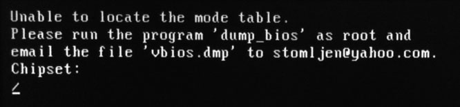

blackosx Posted February 10, 2011 Share Posted February 10, 2011 If there are any bugs that you notice before then, I'll be sure to fix them. One thing I do see when booting is this message from the Resolution.dylib module. Screenshot attached.. If this is expected with my 8800GT then that's okay with me, but is there anyway to disable this message from showing? Link to comment https://www.insanelymac.com/forum/topic/239993-chameleon-rc5-meklorts-branch/page/3/#findComment-1637412 Share on other sites More sharing options...
meklort Posted February 11, 2011 Share Posted February 11, 2011 Ya, I've never worked on the nvidia / ati code with 915resolution, so I don't know what the issue is. I'll disable the warning for now. In either case, it's not too important as I won't be merging the resolution module into trunk. Link to comment https://www.insanelymac.com/forum/topic/239993-chameleon-rc5-meklorts-branch/page/3/#findComment-1637873 Share on other sites More sharing options...

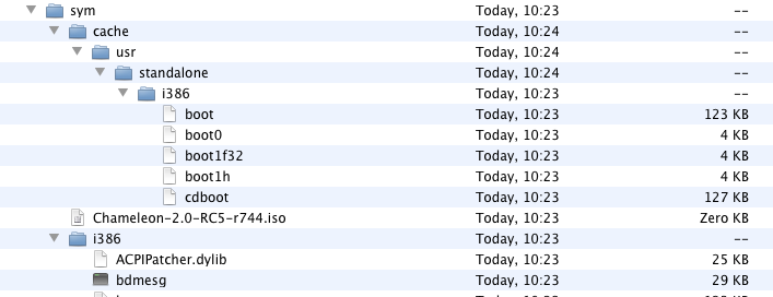

Slice Posted February 11, 2011 Share Posted February 11, 2011 Great work, meklort! I like to follow you. Look onto one problem: I do with your branche make make image Now I see Zero ISO! Now I can add /Extra into the "cache" folder with /themes and with /modules then type again make image Fine! Now I have bootable ISO image that can be written into CD. Can you remake makefile to do this in one step? Ya, I've never worked on the nvidia / ati code with 915resolution, so I don't know what the issue is. I'll disable the warning for now. In either case, it's not too important as I won't be merging the resolution module into trunk. Look into in my edid.c and edid.h files. I made they more correct in some cases. More users got native resolution. char* edidInfo = readEDID(); if(!edidInfo) return; edid_mode mode; // TODO: check *all* resolutions reported and either use the highest, or the native resolution (if there is a flag for that) //xResolution = edidInfo[56] | ((edidInfo[58] & 0xF0) << 4); //yResolution = edidInfo[59] | ((edidInfo[61] & 0xF0) << 4); //Slice - done here if(fb_parse_edid((struct EDID *)edidInfo, &mode) == 0) { xResolution = DEFAULT_SCREEN_WIDTH; yResolution = DEFAULT_SCREEN_HEIGHT; } else { xResolution = mode.h_active; yResolution = mode.v_active; } and so on. Link to comment https://www.insanelymac.com/forum/topic/239993-chameleon-rc5-meklorts-branch/page/3/#findComment-1637922 Share on other sites More sharing options...

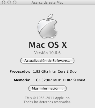

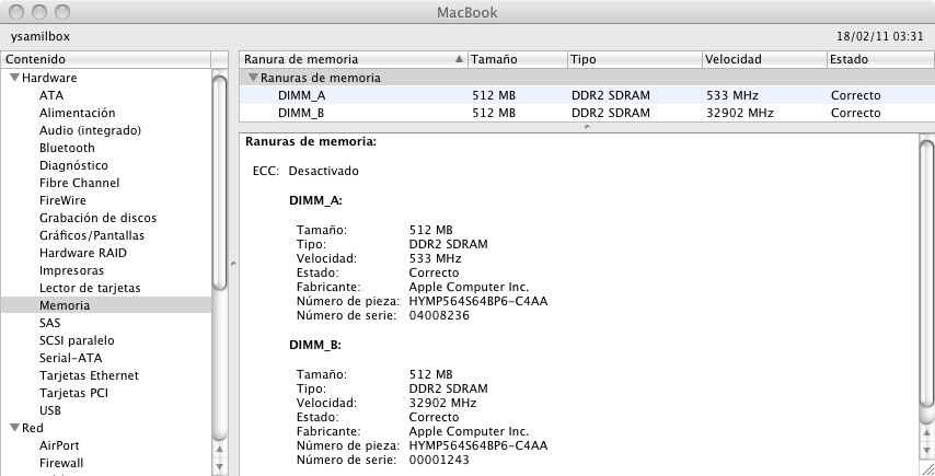

M@dMac Posted February 11, 2011 Share Posted February 11, 2011 hi! there is something wrong with the memory routine in 744, first module detected speed at 533Mhz while second goes above 50000Mhz... I dont have the pictures since I had to test using slice's branch and that one also have issues relating to HPET... so I'm going to trunk 744 and see what happens, whatever results I get I'll try to go back to meklort's so I can post pics depicting the memory wrong speed detection on second module, btw... THANKS! HUGE THANKS TO EVERYONE. Link to comment https://www.insanelymac.com/forum/topic/239993-chameleon-rc5-meklorts-branch/page/3/#findComment-1638004 Share on other sites More sharing options...
meklort Posted February 11, 2011 Share Posted February 11, 2011 The probably is something wrong with the mem detection. My branch was based on an older version of trunk that may have had it broken. As I've said before, I'm not going to be keeping (many) of my modules and that's one of them, so I won't be fixing it. Any looking specifically for issues related to the module system at the moment. After I merge with trunk I'll recreate my branch with just the modules that won't go into trunk (patcher modules, nbi module). Slice, I never use make image, but I suppose I can look into it. See above about nvidia. Anyway, I'll try to get the module system merged tonight (say, around 18 hrs from now). Link to comment https://www.insanelymac.com/forum/topic/239993-chameleon-rc5-meklorts-branch/page/3/#findComment-1638009 Share on other sites More sharing options...
Slice Posted February 11, 2011 Share Posted February 11, 2011 One thing I do see when booting is this message from the Resolution.dylib module. Screenshot attached.. If this is expected with my 8800GT then that's okay with me, but is there anyway to disable this message from showing? Upload your BIOS obtained by this method. I'll look into. Link to comment https://www.insanelymac.com/forum/topic/239993-chameleon-rc5-meklorts-branch/page/3/#findComment-1638256 Share on other sites More sharing options...
blackosx Posted February 12, 2011 Share Posted February 12, 2011 Hi Slice - Here it is. 0611.006C.006F.vga.rom.zip Link to comment https://www.insanelymac.com/forum/topic/239993-chameleon-rc5-meklorts-branch/page/3/#findComment-1638440 Share on other sites More sharing options...
Slice Posted February 12, 2011 Share Posted February 12, 2011 Some numeric exersize while (i < 0x300) { //We don't need to look for the table in the whole bios, the 768 first bytes only if (( map->bios_ptr[i] == 0x44) && (map->bios_ptr[i+1] == 0x01) && (map->bios_ptr[i+2] == 0x04) && (map->bios_ptr[i+3] == 0x00)) { nv_data_table_offset = (unsigned short) (map->bios_ptr[i+4] | (map->bios_ptr[i+5] << 8)); //0x02b6 break; } i++; } nv_data_table = (unsigned short *) (map->bios_ptr + (nv_data_table_offset + OFFSET_TO_VESA_TABLE_INDEX)); std_vesa = (NV_VESA_TABLE *) (map->bios_ptr + *nv_data_table); map->nv_mode_table = (char *) std_vesa->sModelines; if (map->nv_mode_table == 0) { verbose("Unable to locate the mode table.\n"); verbose("Please run the program 'dump_bios' as root and\n"); verbose("email the file 'vbios.dmp' to stomljen@yahoo.com.\n"); verbose("Chipset: %s\n", map->chipset); close_vbios(map); return 0; } map->mode_table_size = std_vesa->sHeader.usTable_Size; I took 4 different nVidia BIOSes for 0x01D7, 0x06E9, 0x0611 and 0x0649. nv_data_table is calculated successfully for all. std_vesa pointer is calculated also and I see the same headers 0x01D7: 23c, 2ba, *2bc=aeb0->20 05 20 10 4B 64 19 00 0x06E9: 22a, 2c2, *2c4=805c->20 05 20 10 00 64 19 00 0x0611: 220, 2b6, *2b8=7bca->20 05 20 10 00 64 19 00 0x0649: 226, 2be, *2c0=7d4c->20 05 20 10 00 64 19 00 But 4B is the difference. Is this algo works for 0x01d* and do not work for 0x06xx? I am not clear here but map->nv_mode_table = (char *) std_vesa->sModelines; is not zero in all these cases. Link to comment https://www.insanelymac.com/forum/topic/239993-chameleon-rc5-meklorts-branch/page/3/#findComment-1638697 Share on other sites More sharing options...

M@dMac Posted February 18, 2011 Share Posted February 18, 2011 hi! I just tought it would be a good idea to share these images... Link to comment https://www.insanelymac.com/forum/topic/239993-chameleon-rc5-meklorts-branch/page/3/#findComment-1641398 Share on other sites More sharing options...
blackosx Posted February 18, 2011 Share Posted February 18, 2011 @M@dMac Meklort answered your previous post about memory detection in post #66 where he says: I'm not going to be keeping (many) of my modules and that's one of them Link to comment https://www.insanelymac.com/forum/topic/239993-chameleon-rc5-meklorts-branch/page/3/#findComment-1641440 Share on other sites More sharing options...
