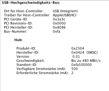

verleihnix Posted February 5, 2011 Share Posted February 5, 2011 dsdt.USB.zipwhat you have connected with the ports USBs? it sleeps -- super!! Feb 5 15:49:12 macpro kernel[0]: System Sleep Feb 5 15:49:36 macpro kernel[0]: Wake reason = PWRB EHC2 Feb 5 15:49:36 macpro kernel[0]: System Wake now you removed everything under ehc1 and 2. What about ehci fixes? like this Method (_DSM, 4, NotSerialized) { Store (Package (0x0D) { "AAPL,clock-id", Buffer (One) { 0x02 }, "built-in", Buffer (One) { 0x00 }, "device_type", Buffer (0x05) { "EHCI" }, "AAPL,current-available", 0x04B0, "AAPL,current-extra", 0x02BC, "AAPL,current-in-sleep", 0x03E8, Buffer (One) { 0x00 } }, Local0) DTGP (Arg0, Arg1, Arg2, Arg3, RefOf (Local0)) Return (Local0) } Link to comment https://www.insanelymac.com/forum/topic/235523-dsdt-auto-patcher/page/82/#findComment-1634904 Share on other sites More sharing options...
MaLd0n Posted February 5, 2011 Author Share Posted February 5, 2011 it sleeps remove only PWR add this but their USBs should not need to fix see the about this mac as USBs appear there? Link to comment https://www.insanelymac.com/forum/topic/235523-dsdt-auto-patcher/page/82/#findComment-1634914 Share on other sites More sharing options...
