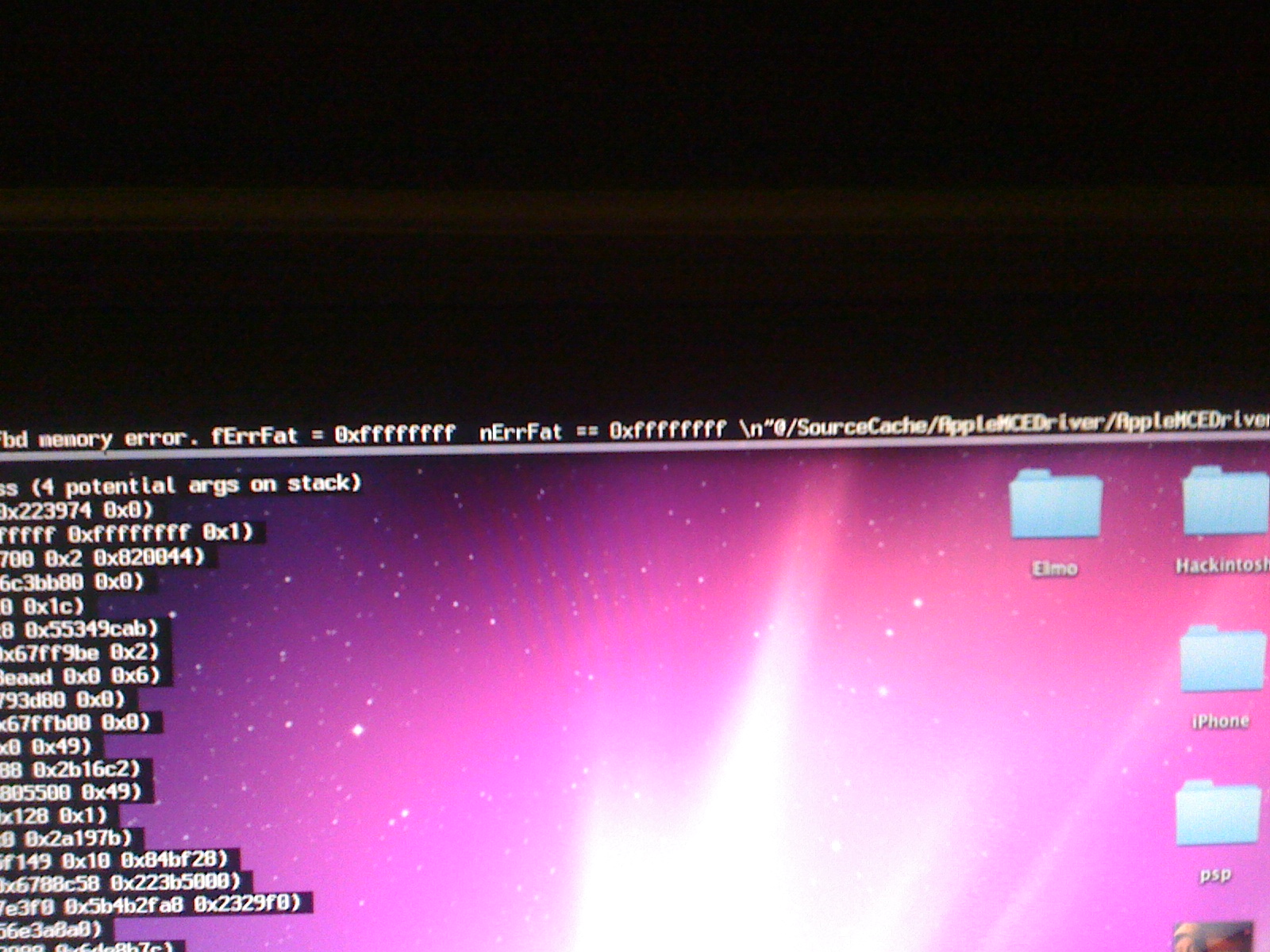

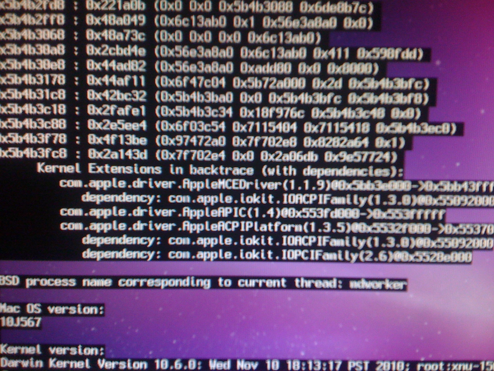

pet1 Posted February 1, 2011 Share Posted February 1, 2011 AppleMCEDriver?Hummm confirms for me please whether appletymcedriver or applemcedriver Thanks AppleMCEDriver. Thank you. Link to comment https://www.insanelymac.com/forum/topic/235523-dsdt-auto-patcher/page/77/#findComment-1632936 Share on other sites More sharing options...
MaLd0n Posted February 1, 2011 Author Share Posted February 1, 2011 AppleMCEDriver. Thank you. send me DSDT Link to comment https://www.insanelymac.com/forum/topic/235523-dsdt-auto-patcher/page/77/#findComment-1632941 Share on other sites More sharing options...

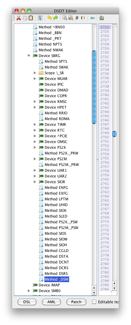

koko Posted February 1, 2011 Share Posted February 1, 2011 Hi, I'm here, i just try dsdt, without nulcpu kext i got kernel panic (No HPET processor). With nullcpu boot is ok but no AppleLPC up. In lspci i see LPC device like "Unknown device" and Vendor id is where should be device id. My System info: Devices_Kexts.zip Why you put DSM in Device (SIOR) and not in Device (SBRG)? THX Link to comment https://www.insanelymac.com/forum/topic/235523-dsdt-auto-patcher/page/77/#findComment-1633197 Share on other sites More sharing options...

MaLd0n Posted February 2, 2011 Author Share Posted February 2, 2011 Thanks again. dsdt.pet1.zip Why you put DSM in Device (SIOR) and not in Device (SBRG)? you sure about that? Link to comment https://www.insanelymac.com/forum/topic/235523-dsdt-auto-patcher/page/77/#findComment-1633380 Share on other sites More sharing options...

pet1 Posted February 2, 2011 Share Posted February 2, 2011 Thanx for your dsdt. But it still gives me the same kernel panic. Link to comment https://www.insanelymac.com/forum/topic/235523-dsdt-auto-patcher/page/77/#findComment-1633442 Share on other sites More sharing options...
MaLd0n Posted February 2, 2011 Author Share Posted February 2, 2011 Thanx for your dsdt. But it still gives me the same kernel panic. run on terminal kextstat Link to comment https://www.insanelymac.com/forum/topic/235523-dsdt-auto-patcher/page/77/#findComment-1633449 Share on other sites More sharing options...

koko Posted February 2, 2011 Share Posted February 2, 2011 you sure about that? My mistake, sorry. I was tried dsdt.. 1. Got kernel panic without nullcpu kext. 2. Put back nullcpu and boot is ok, but no AppleLPC up. Look at system info and device id was 10de and vendor id 0d82. Posted my system info in Post #1916. 3. Changed in your DSM 0x82, 0x0D, 0x00, 0x00 into 0xAE, 0x0A, 0x00, 0x00 and got AppleLPC up. 4. Removed nullcpu kext and got panic (No HPET capable cpu)!? What now? Do i need to remove RTC kext? (I know, you fix RTC in DSDT, but left it in extra for safety...) THX Link to comment https://www.insanelymac.com/forum/topic/235523-dsdt-auto-patcher/page/77/#findComment-1633520 Share on other sites More sharing options...
