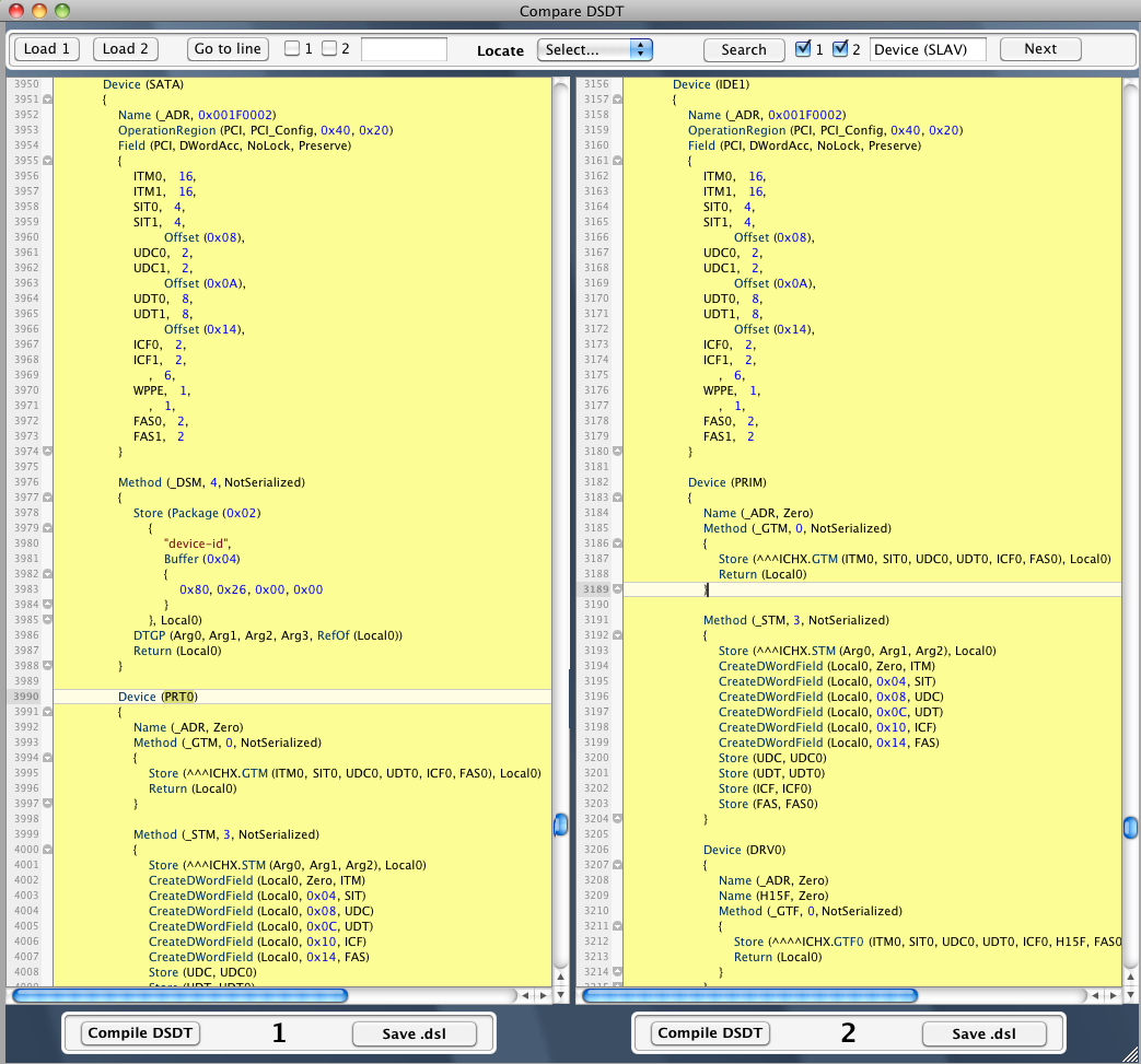

LatinMcG Posted January 2, 2011 Share Posted January 2, 2011 i found a bug in sata and pata of vostro entry. (EDIT bolded) the Device (IDE0) 0x001F002 is SATA not Pata!! the same patch is also missing the ioata panic fix for snow in device (IDE1) 0x001F0001 and while u there rename to PATA not SATA. i used it for my inspiron 1520 .. fresh install of snow gave me ioata panic. once i fixed it with dsdtse from my 10.5.8 got it to workworking nice !~ got my rebranded atheros wll4080 to ibm 1014:058a to work too thank you! the shutdownfix might be wrong.. check in the m1530 dsdt thread first post its 0x1030 not 0x0430 ? other than that great stuff. i been wanting something like this for a while so heres my 5 cents. with inflation .. cause 2 cents hardly gets anything. Link to comment https://www.insanelymac.com/forum/topic/235523-dsdt-auto-patcher/page/50/#findComment-1612807 Share on other sites More sharing options...
MaLd0n Posted January 2, 2011 Author Share Posted January 2, 2011 i found a bug in sata and pata of vostro entry. the Device (IDE0) 0x001F000 is SATA not Pata!! the same patch is also missing the ioata panic fix for snow in device (IDE1) 0x001F0001 and while u there rename to PATA not SATA. i used it for my inspiron 1520 .. fresh install of snow gave me ioata panic. once i fixed it with dsdtse from my 10.5.8 got it to workworking nice !~ got my rebranded atheros wll4080 to ibm 1014:058a to work too thank you! the shutdownfix might be wrong.. check in the m1530 dsdt thread first post its 0x1030 not 0x0430 ? other than that great stuff. i been wanting something like this for a while so heres my 5 cents. with inflation .. cause 2 cents hardly gets anything. Shutdown oSxFr33k had already alerted http://www.insanelymac.com/forum/index.php...p;#entry1448614 fix ioatapanic Included NextUpdate it is fixed from 10.6.3 Thanks Link to comment https://www.insanelymac.com/forum/topic/235523-dsdt-auto-patcher/page/50/#findComment-1612821 Share on other sites More sharing options...
LatinMcG Posted January 2, 2011 Share Posted January 2, 2011 EDIT heres the file. used your auto-pacher on vostro 1500 dropdown then fixed a few things.. 1: USB EHCI2 .. only one of them need hack. 2: sata pata backwards names 1 post up. and added ide timing fix only to pata(ide1) and trimmed the secondary since its laptop who needs second ide inside. ty for a cool tool. btw it has CPU section underclocked T7500. u can clean. i find it runs cooler with dsdt cpu info than with generate pstates cstates. EDIT 1-2-11: ARPT in PSX1 section.. should be PSX2 . but some people have issues with wifi slot. so i use cell wwan slot. Link to comment https://www.insanelymac.com/forum/topic/235523-dsdt-auto-patcher/page/50/#findComment-1612834 Share on other sites More sharing options...

yehia2amer Posted January 2, 2011 Share Posted January 2, 2011 dsdt.yehia_Amer.zip DTGP EHCI HID/CID UHCI IRQs LAN LPC REMOVE RENAME RTC SMBUS SHUTDOWN WAK thanks MaLd0n i tried your DSDT and it didn't work giving me "Waiting for root device" after checking the DSDT i found that Device (IDE1) need to be Renamed to (SATA) and adding the DTGP method also Renaming Device (PRIM) to (PRT0) please correct me if there is anything wrong and after correcting them and trying the DSDT it works Some questions 1) on the latest 10.6.5 update USB don't work well and i rolledback to the old 10.6.4 can i switch back again Now 2) is there anyway to inject the Lan from the DSDT 3) Can i make sleep working aftersend me a kextstat and log kextstat cat /var/log/kernel.log cat /var/log/kernel.log > ~/Desktop/kernel.txt kextstat > ~/Desktop/kextstat.txt After using your DSDT kextstat___Kernel.zip unfortunately kernel mod will not let us use "vanilla"I need these files to see what was loaded actually i am using a vanilla Kernel but with using a special chamelon RC5 "boot" file New modified Chamelon Bootloader for P4 offcourse it's patched, but i don't have to change it with the legacy kernel every update ich6 that's the greatness of this operating system Link to comment https://www.insanelymac.com/forum/topic/235523-dsdt-auto-patcher/page/50/#findComment-1613272 Share on other sites More sharing options...
