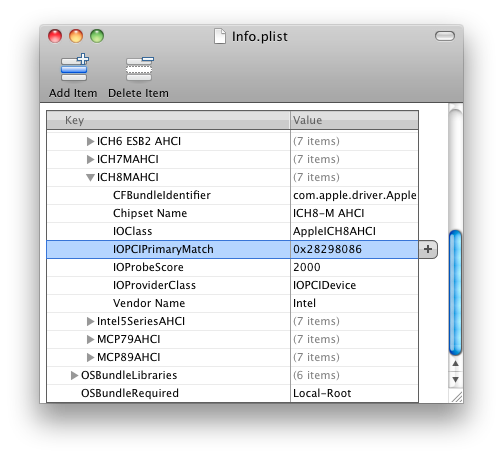

LatinMcG Posted January 3, 2011 Share Posted January 3, 2011 ioata panic - 10.6.3 solves this problem yah but i have 10.6.0 retail so it wont let it boot till i do -v -x -f.. or fix dsdt. 2928 no 2828.. on 2 port sata mobile.. 2828 is included in ahcikext. its in combination with 2850 ide. 2928 would be ich9 likely (not included). 2828 ich8-m sata.. p.s. this disables 3 and 4 port of sata on DESKTOP mobos! testing patch.. doubt shutdown will work.. i think this laptop shares something in common with m1330 and its no shutdown issue.. SMI ? Link to comment https://www.insanelymac.com/forum/topic/235523-dsdt-auto-patcher/page/51/#findComment-1613730 Share on other sites More sharing options...

LatinMcG Posted January 3, 2011 Share Posted January 3, 2011 yeah seems dev_2828 is when its in ide mode .. ahci seems to be dev_2829 same as my inspiron1520. but on some rare cases ahci isn't enabled and they get 2828 ata mode. in other words if their device shows 2829 then they are ahci and ok. (no need to inject anything in dsdt unless they are ich9 then inject 2829 or 2828 depending on bios set to legacy=2828 or native=2829) and if no setting can be changed then use dsdt to enable ahci trick.. and inject 2829. look in IOATAFamily> AppleIntelpIIATA.kext (useful for people that cant enable ahci.) www.insanelymac.com/forum/index.php?showtopic=126089&st=60# Link to comment https://www.insanelymac.com/forum/topic/235523-dsdt-auto-patcher/page/51/#findComment-1613847 Share on other sites More sharing options...

LatinMcG Posted January 3, 2011 Share Posted January 3, 2011 tuxie try lspci -nn.. from what i see u need ahci 2829 injection. since u have ich9. i did do a inspiron530 desktop with ich9 chipset. had to inject ids for USB's, LPCB, SBUS, SATA and IDEx of an ICH8 this is my GA-G31M-ES2L rev:1.0 ICH7 00:00.0 Host bridge [0600]: Intel Corporation 82G33/G31/P35/P31 Express DRAM Controller [8086:29c0] (rev 10) 00:01.0 PCI bridge [0604]: Intel Corporation 82G33/G31/P35/P31 Express PCI Express Root Port [8086:29c1] (rev 10) 00:1b.0 Audio device [0403]: Intel Corporation 82801G (ICH7 Family) High Definition Audio Controller [8086:27d8] (rev 01) 00:1c.0 PCI bridge [0604]: Intel Corporation 82801G (ICH7 Family) PCI Express Port 1 [8086:27d0] (rev 01) 00:1c.1 PCI bridge [0604]: Intel Corporation 82801G (ICH7 Family) PCI Express Port 2 [8086:27d2] (rev 01) 00:1d.0 USB Controller [0c03]: Intel Corporation 82801G (ICH7 Family) USB UHCI Controller #1 [8086:27c8] (rev 01) 00:1d.1 USB Controller [0c03]: Intel Corporation 82801G (ICH7 Family) USB UHCI Controller #2 [8086:27c9] (rev 01) 00:1d.2 USB Controller [0c03]: Intel Corporation 82801G (ICH7 Family) USB UHCI Controller #3 [8086:27ca] (rev 01) 00:1d.3 USB Controller [0c03]: Intel Corporation 82801G (ICH7 Family) USB UHCI Controller #4 [8086:27cb] (rev 01) 00:1d.7 USB Controller [0c03]: Intel Corporation 82801G (ICH7 Family) USB2 EHCI Controller [8086:27cc] (rev 01) 00:1e.0 PCI bridge [0604]: Intel Corporation 82801 PCI Bridge [8086:244e] (rev e1) 00:1f.0 ISA bridge [0601]: Intel Corporation 82801GB/GR (ICH7 Family) LPC Interface Bridge [8086:27b8] (rev 01) 00:1f.1 IDE interface [0101]: Intel Corporation 82801G (ICH7 Family) IDE Controller [8086:27df] (rev 01) 00:1f.2 IDE interface [0101]: Intel Corporation 82801GB/GR/GH (ICH7 Family) SATA IDE Controller [8086:27c0] (rev 01) 00:1f.3 SMBus [0c05]: Intel Corporation 82801G (ICH7 Family) SMBus Controller [8086:27da] (rev 01) 01:00.0 VGA compatible controller [0300]: nVidia Corporation Unknown device [10de:0615] (rev a2) 03:00.0 Ethernet controller [0200]: Realtek Semiconductor Co., Ltd. RTL8111/8168B PCI Express Gigabit Ethernet controller [10ec:8168] (rev 02) Link to comment https://www.insanelymac.com/forum/topic/235523-dsdt-auto-patcher/page/51/#findComment-1613993 Share on other sites More sharing options...

LatinMcG Posted January 3, 2011 Share Posted January 3, 2011 tux i think the usb issue is same as i had. the EHCI is causing it. not both need the mod. i think i fixed. also renamed OVGA> GFX0 , LPC> LPCB , SAT0> SATA and added the id 2829 so u can forget about chameleon2 ahci kext. EDIT1-3-2011: Removed attached dsdt.. no usb. Link to comment https://www.insanelymac.com/forum/topic/235523-dsdt-auto-patcher/page/51/#findComment-1614113 Share on other sites More sharing options...
