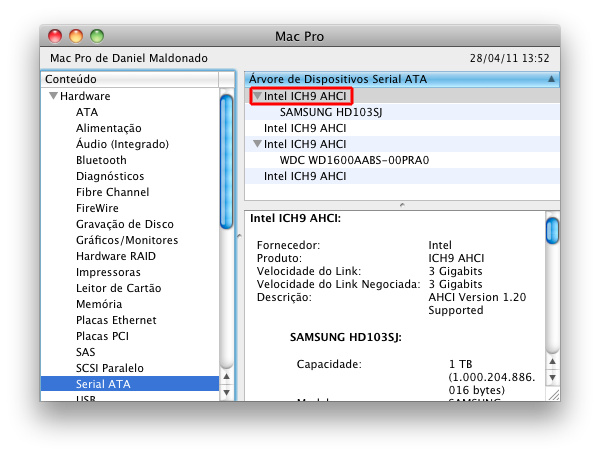

Ps, 1 last problem
After a period of time(15 minutes+-), i opened system Profile
at hardware tab:
Disc Burning ;No disc burning device was found. If the device is external, make sure it’s connected and turned on.
Serial ATA ;There was an error while scanning for Serial-ATA devices.
Any1 know y?
