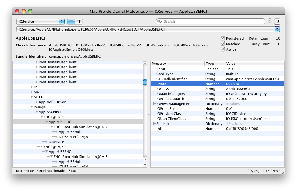

Thanks for your help in my other thread! Just wanted to say that after testing some stuff out in the DSDT the following code seems to make sleep work fully for me (as long as I use USB2/ECHI devices ONLY! UCHI devices still causes failed sleep and CMOS-reset/corrupt):
(ofcourse the clock-id for ECH2 is 0x02)
Don't need the device-ids and such as they are already identified as bult-in and have correct IDs!
Just wanted to tell you if you want to include it in a future update!

my mistake :)
The ids macpro3, 1 and correcting errata in ioreg
My DSDT
dsdt.MaLd0n.zip
try it
				Store (Package (0x04)
						"device-id",
						Buffer (0x04)
							0x8C, 0x26, 0x00, 0x00
						"AAPL,clock-id",
						Buffer (One)
							[color="#FF0000"][b]0x01[/b][/color]
					}, Local0)
				Return (Local0)

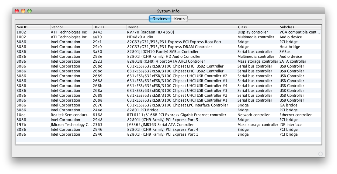

I think I may have lost Sleep but I'm on to getting Audio working. Does the below screen shot help in possibly modifying my previous DSDT to correct Sleep or get Audio working? I used the bin patch from the first post, do I need to modify that bin patch string to match the DevID listed?
Audio
http://www.projectosx.com/forum/index.php?showtopic=465
Sleep
What Happens?
