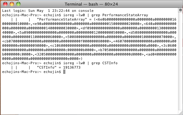

Hackintosh2000 Posted May 1, 2011 Share Posted May 1, 2011 dsdt.Hackintosh2000.zip Sorry for taking so long to get back to you. The Asus CG5290 patched DSDT you posted works marvelously. I had to remove nullcpumanagement.kext and add the following to my com.apple.boot.plist: <key>GenerateCStates</key> <string>Yes</string> <key>GeneratePStates</key> <string>Yes</string> After that sleep worked. Restart and shutdown worked with and without nullcpumanagement.kext. Thank you so much for your help. Link to comment https://www.insanelymac.com/forum/topic/235523-dsdt-auto-patcher/page/125/#findComment-1677417 Share on other sites More sharing options...
