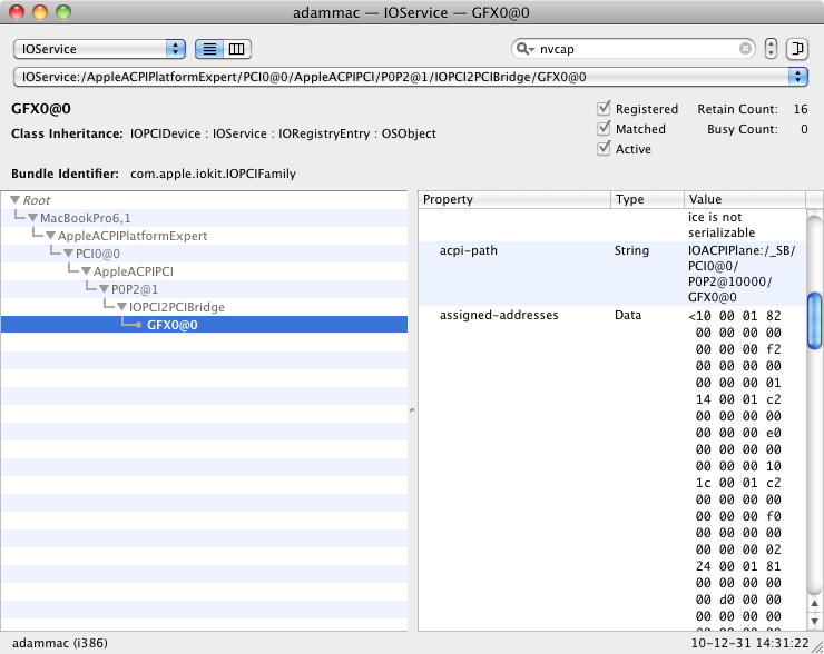

Have you gfx device under 0x00030000 address?

@bungo: i´m not sure if i got gfx device under these address i used it from the tonymac dsdt fixes, don´t know where to find the proper values... (i´ve seen you have a 2 instead of 3...)...

To find your gfx device in DSDT easy boot with GraphicsEnabler=Yes (remove your DSDT or use DST=No at boot), next open up IORegExpl and search for the NVCAP string. In the left pane you'll see something like this:
Last bolded device (in my case it is GFX0, your may be named differently e.g. PEGP) is your gfx.
