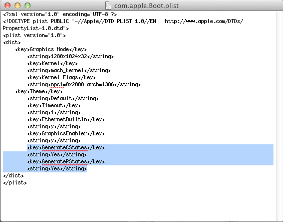

Tristano Posted August 4, 2011 Share Posted August 4, 2011 Nella mia cartella extra ho solo fakeSMC e evoreboot.Qualche consiglio da darmi?? prova sensa dsdst.aml. fammi sapere il mio boot.plist in extra <?xml version="1.0" encoding="UTF-8"?> <!DOCTYPE plist PUBLIC "-//Apple//DTD PLIST 1.0//EN" "http://www.apple.com/DTDs/PropertyList-1.0.dtd"> <plist version="1.0"> <dict> <key>Graphics Mode</key> <string>1280x1024x32</string> <key>Kernel</key> <string>mach_kernel</string> <key>Kernel Flags</key> <string>npci=0x2000 arch=i386</string> <key>Theme</key> <string>Default</string> <key>Timeout</key> <string>1</string> <key>EthernetBuiltIn</key> <string>y</string> <key>GraphicsEnabler</key> <string>y</string> <key>GenerateCStates</key> <string>Yes</string> <key>GeneratePStates</key> <string>Yes</string> </dict> </plist> Link to comment https://www.insanelymac.com/forum/topic/234196-guida-snow-leopard-su-asus-p5q-series/page/43/#findComment-1729578 Share on other sites More sharing options...

massi1978 Posted August 4, 2011 Share Posted August 4, 2011 prova sensa dsdst.aml.fammi sapere il mio boot.plist in extra <?xml version="1.0" encoding="UTF-8"?> <!DOCTYPE plist PUBLIC "-//Apple//DTD PLIST 1.0//EN" "http://www.apple.com/DTDs/PropertyList-1.0.dtd"> <plist version="1.0"> <dict> <key>Graphics Mode</key> <string>1280x1024x32</string> <key>Kernel</key> <string>mach_kernel</string> <key>Kernel Flags</key> <string>npci=0x2000 arch=i386</string> <key>Theme</key> <string>Default</string> <key>Timeout</key> <string>1</string> <key>EthernetBuiltIn</key> <string>y</string> <key>GraphicsEnabler</key> <string>y</string> <key>GenerateCStates</key> <string>Yes</string> <key>GeneratePStates</key> <string>Yes</string> </dict> </plist> grazie mille per il consiglio ora provo e ti faccio sapere! grazie mille per il consiglio ora provo e ti faccio sapere! allora senza dsdt, ottengo le icone disco gialle e l' impossibilita' di mettere in stop il pc: si spegne il monitor si spengono per un attimo le ventole e poi si riaccende tutto Link to comment https://www.insanelymac.com/forum/topic/234196-guida-snow-leopard-su-asus-p5q-series/page/43/#findComment-1729613 Share on other sites More sharing options...

copil Posted August 5, 2011 Share Posted August 5, 2011 Questo e il mio. lo stop a me per il momento non si parla perche a me non funziona e poi non mi va nemeno in stop il pc, solo lo schermo per ora va in stop. EXTRA Lion extra.zip E non ci andrà mai. EvOreboot, NullCPUPowerManagement si usa su AMD, LegacyAppleRTC, IOATAFamily, AppleVIAATA, AHCIPortInjector a che ti servono? Per lo stop i dsdt allegati ( Post #1062 ) non sono modificati per avere le Usb viste come interne quindi lo stop non funzionerà. Inoltre i device per lo speedstep non sono funzionanti. Per essere caricato LPC ad esempio su ICH10R hai bisogno di toccare il dsdt per farlo andare a differenza di ICH10 che va da se. Può mai funzionare lo speedstep? Link to comment https://www.insanelymac.com/forum/topic/234196-guida-snow-leopard-su-asus-p5q-series/page/43/#findComment-1730061 Share on other sites More sharing options...
Tristano Posted August 5, 2011 Share Posted August 5, 2011 E non ci andrà mai. EvOreboot, NullCPUPowerManagement si usa su AMD, LegacyAppleRTC, IOATAFamily, AppleVIAATA, AHCIPortInjector a che ti servono? Per lo stop i dsdt allegati ( Post #1062 ) non sono modificati per avere le Usb viste come interne quindi lo stop non funzionerà. Inoltre i device per lo speedstep non sono funzionanti. Per essere caricato LPC ad esempio su ICH10R hai bisogno di toccare il dsdt per farlo andare a differenza di ICH10 che va da se. Può mai funzionare lo speedstep? LegacyAppleRTC, IOATAFamily, AppleVIAATA, AHCIPortInjector a che ti servono? - EvOreboot, NullCPUPowerManagement,LegacyAppleRTC (per questi non so risponderti) . IOATAFamily, AppleVIAATA, AHCIPortInjector (questi mi servono per i ide e una scheda pci chipset jimicron363) sensa questi niente boot. Inoltre i device per lo speedstep non sono funzionanti. Per essere caricato LPC ad esempio su ICH10R hai bisogno di toccare il dsdt per farlo andare a differenza di ICH10 che va da se. Troppo bella questa per come lo dici,io non sono in grado di farlo se riesci ad aiutarmi bene se no pace... grazie c.m.q Tutto questo riguarda lion,a quanto ho capito e uguale a snow 10.6.8 ora sono su snow 10.6.8 e ho questo come boot.plist <?xml version="1.0" encoding="UTF-8"?> <!DOCTYPE plist PUBLIC "-//Apple//DTD PLIST 1.0//EN" "http://www.apple.com/DTDs/PropertyList-1.0.dtd"> <plist version="1.0"> <dict> <key>Graphics Mode</key> <string>1280x1024x32</string> <key>Kernel</key> <string>mach_kernel</string> <key>Kernel Flags</key> <string></string> <key>Theme</key> <string>Default</string> <key>Timeout</key> <string>3</string> <key>EthernetBuiltIn</key> <string>y</string> <key>GraphicsEnabler</key> <string>y</string> </dict> </plist> OT: Copil di dove sei? Link to comment https://www.insanelymac.com/forum/topic/234196-guida-snow-leopard-su-asus-p5q-series/page/43/#findComment-1730100 Share on other sites More sharing options...
Fabio1971 Posted August 5, 2011 Share Posted August 5, 2011 LegacyAppleRTC, IOATAFamily, AppleVIAATA, AHCIPortInjector a che ti servono? - EvOreboot, NullCPUPowerManagement,LegacyAppleRTC (per questi non so risponderti) . IOATAFamily, AppleVIAATA, AHCIPortInjector (questi mi servono per i ide e una scheda pci chipset jimicron363) sensa questi niente boot. Inoltre i device per lo speedstep non sono funzionanti. Per essere caricato LPC ad esempio su ICH10R hai bisogno di toccare il dsdt per farlo andare a differenza di ICH10 che va da se. Troppo bella questa per come lo dici,io non sono in grado di farlo se riesci ad aiutarmi bene se no pace... grazie c.m.q Tutto questo riguarda lion,a quanto ho capito e uguale a snow 10.6.8 ora sono su snow 10.6.8 e ho questo come boot.plist <?xml version="1.0" encoding="UTF-8"?> <!DOCTYPE plist PUBLIC "-//Apple//DTD PLIST 1.0//EN" "http://www.apple.com/DTDs/PropertyList-1.0.dtd"> <plist version="1.0"> <dict> <key>Graphics Mode</key> <string>1280x1024x32</string> <key>Kernel</key> <string>mach_kernel</string> <key>Kernel Flags</key> <string></string> <key>Theme</key> <string>Default</string> <key>Timeout</key> <string>3</string> <key>EthernetBuiltIn</key> <string>y</string> <key>GraphicsEnabler</key> <string>y</string> </dict> </plist> OT: Copil di dove sei? Ciao Tristano puoi passarmi IoReg F.A.Q Anche informazioni hardware sul tuo sistema (LsPCI) F.A.Q e infine il tuo dsdt NON Modificato Così si parte da zero Tu stai usando Snow 10.6.8 Guisto ? Che Boot stai usando ? Link to comment https://www.insanelymac.com/forum/topic/234196-guida-snow-leopard-su-asus-p5q-series/page/43/#findComment-1730125 Share on other sites More sharing options...
copil Posted August 5, 2011 Share Posted August 5, 2011 EvOreboot, NullCPUPowerManagement, LegacyAppleRTC non ti servono è solo merda. Il tuo dsdt e il bootloader sono in grado di gestire lo spegnimento/riavvio/speedstep fuori dalla scatola su P5Q più le key che hai appena tolto dal org.chameleon.Boot.plist. Il tuo controller è il Marvell 88SE6111 ti basta AppleVIAATA se devi usare un disco duro IDE. Poco sopra ti ho scritto come fare ( Post #1063 ). Da terminale kextstat -k | grep SMBus che output ti da? Link to comment https://www.insanelymac.com/forum/topic/234196-guida-snow-leopard-su-asus-p5q-series/page/43/#findComment-1730126 Share on other sites More sharing options...
