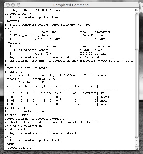

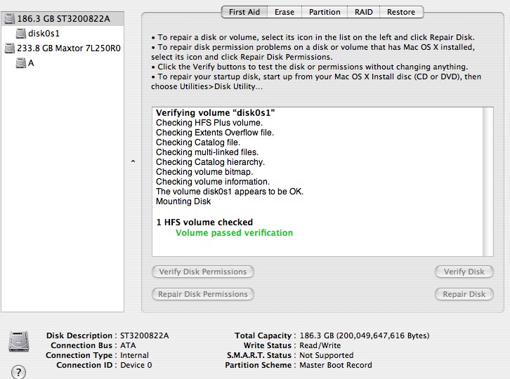

groux Posted January 10, 2007 Share Posted January 10, 2007 Hi, thanks a lot Rammjet for your guide. I think I did everything said but no way. I can not boot after having a copy of my main partition with carbon copy cloner to my other drive. I just got a blank screen with a flashing underscore. I think also that the primary partition done with gparted was right. I'm getting nut. I can not determine where the problem come from. Any help? Thanks Link to comment https://www.insanelymac.com/forum/topic/22844-how-to-setting-your-partition-active-using-fdisk-in-macosx/page/2/#findComment-273102 Share on other sites More sharing options...
