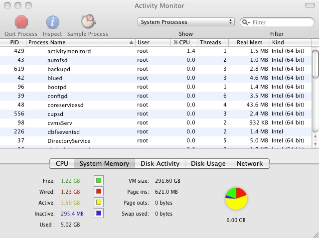

splonk Posted December 13, 2010 Share Posted December 13, 2010 I am curious about if anyone using more then 3-4Gigs of RAM in their Inspiron 530 with OSX? I heard that the Mainboard will not adress more. Anyone tried? //K I have 6GB in mine as you saw above. Worked with Leopard, Snow Leopard, Vista 64bit and Windows 7 64bit , so neither a limitation of software nor hardware. Perhaps someone was trying with 32bit Windows, which has its own limitations on memory addressing. Link to comment https://www.insanelymac.com/forum/topic/221162-guide-snow-leopard-on-inspiron-530/page/4/#findComment-1601496 Share on other sites More sharing options...

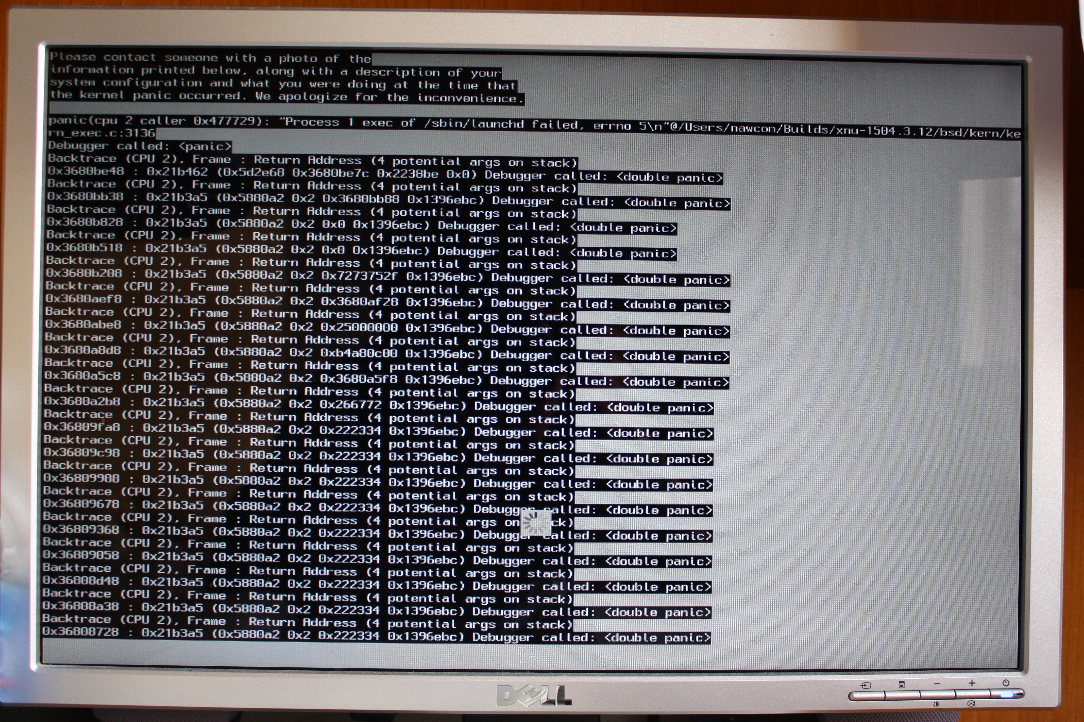

jhonka Posted December 19, 2010 Share Posted December 19, 2010 I did a fresh install on my i530 and updated to 10.6.5 using System Updater with few problems. After rebooting I would get stuck on "still waiting for root device" message, even though I toggled between the BIOS settings for IDE/RAID several times. The solution? I booted into an old (working) OS install, re-copied over the kexts from A Chance of Snow at 5:30 to my /S/L/E directory and dragged that folder over Kext Helper. I rebooted into the 10.6.5 partition (using the "ignore caches" option) and after a delay I saw my desktop. (from there, I installed a new audio kext manually.) __________ what do I have to do to see my hard drive icon on the desktop? Check under the menu: Finder > Preferences > "Show these items on the desktop" I personally like the cleaner desktop. __________ Has anyone found a better audio kext yet? The one I use has a quiet screeching noise. Thanks for all the hard work of everyone involved here. And thanks for the A Chance of Snow at 5:30 kext pack! Link to comment https://www.insanelymac.com/forum/topic/221162-guide-snow-leopard-on-inspiron-530/page/4/#findComment-1605209 Share on other sites More sharing options...

ws2000 Posted December 24, 2010 Share Posted December 24, 2010 Please tell me more about the ram upgrade to 6GB. What are the specs of the ram you are using? Example Manufacturer ? Specs: DDR2 PC2-5300 • CL=5 • Unbuffered • NON-ECC • DDR2-667 • 1.8V • 256Meg x 64 ? 2 X 2GB and 1X GB ? Many Thanks! I have 6GB in mine as you saw above. Worked with Leopard, Snow Leopard, Vista 64bit and Windows 7 64bit , so neither a limitation of software nor hardware. Perhaps someone was trying with 32bit Windows, which has its own limitations on memory addressing. Link to comment https://www.insanelymac.com/forum/topic/221162-guide-snow-leopard-on-inspiron-530/page/4/#findComment-1608433 Share on other sites More sharing options...

TGz Posted December 25, 2010 Share Posted December 25, 2010 I tried to install using iAtkos S3 V2 today. Didn't work as well as I expected. I set the boot device to my DVD drive and my SATA mode to RAID. I booted off the iAtkos disk and I see the Apple loading screen with the little circle underneath. It would spin for several minutes and then I would be presented with the language selection. I select English and then it would say "Preparing Installation" for several minutes. Then it says it wasn't able to install and gave me options to restart, shut down, save log, or view log. I looked at the log and naturally didn't understand any of it. I didn't save the log though. Next, I tried to install by using -v -f, but then I got this weird error. I would see a bunch of white text on a black background and then I see this: disk1s3: I/O error Then it started saying something about SAM and how it couldn't read or write. I saw on some other guides about busratio=20 and cpus=1 so I booted the disk with -v cpus=1 busratio=20. Then I would see the Chameleon background with four lines of text. It said that it was trying to load machkernal or something like that. It froze there. I restarted and tried to boot iAtkos again, this time without any boot options. I got a kernal panic. I've attached a picture of it. By the way, this kernal panic was after numerous attempts of installing. Man, I really wonder why my computer doesn't install as easily as other people's. Help please! Link to comment https://www.insanelymac.com/forum/topic/221162-guide-snow-leopard-on-inspiron-530/page/4/#findComment-1608539 Share on other sites More sharing options...
