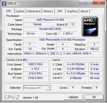

Mohamed Khairy Posted January 11, 2011 Share Posted January 11, 2011 see 16.5*210 CPU: AMD Phenom(tm) II X4 955 Processor P-State 0: Frequency: 3451, Multiplier: 17 P-State 1: Frequency: 1827, Multiplier: 9 P-State 2: Frequency: 1015, Multiplier: 5 P-State 3: Frequency: 0, Multiplier: 0 CPU: Vendor/Family/ExtFamily: 0x68747541/0xf/0x1 CPU: Model/ExtModel/Stepping: 0x4/0x0/0x2 CPU: Multipliers x10: max=170, min=0 CPU: MaxDiv/CurrDiv: 0x0/0x1 CPU: TSCFreq: 3465MHz CPU: CPUFreq: 3465MHz CPU: FSBFreq: 203MHz CPU: NoCores/NoThreads: 1/4 CPU: Features: 0x36900221 this with 16 *210 CPU: AMD Phenom(tm) II X4 955 Processor P-State 0: Frequency: 3360, Multiplier: 16 P-State 1: Frequency: 1890, Multiplier: 9 P-State 2: Frequency: 1050, Multiplier: 5 P-State 3: Frequency: 0, Multiplier: 0 CPU: Vendor/Family/ExtFamily: 0x68747541/0xf/0x1 CPU: Model/ExtModel/Stepping: 0x4/0x0/0x2 CPU: Multipliers x10: max=160, min=0 CPU: MaxDiv/CurrDiv: 0x0/0x1 CPU: TSCFreq: 3360MHz CPU: CPUFreq: 3360MHz CPU: FSBFreq: 210MHz CPU: NoCores/NoThreads: 1/4 CPU: Features: 0x36900221 Link to comment https://www.insanelymac.com/forum/topic/216726-anval-acpi-loader/page/50/#findComment-1620425 Share on other sites More sharing options...

Mohamed Khairy Posted January 11, 2011 Share Posted January 11, 2011 @Mohamed,on next one I tried to get minimal multiplier and maxdiv ok dear 16*200 CPU: AMD Phenom(tm) II X4 955 Processor P-State 0: Frequency: 3200, Multiplier: 16 P-State 1: Frequency: 1800, Multiplier: 9 P-State 2: Frequency: 1000, Multiplier: 5 P-State 3: Frequency: 0, Multiplier: 0 CPU: Vendor/Family/ExtFamily: 0x68747541/0xf/0x1 CPU: Model/ExtModel/Stepping: 0x4/0x0/0x2 CPU: Multipliers x10: max=160, min=0 CPU: MaxDiv/CurrDiv: 0x0/0x1 CPU: TSCFreq: 3210MHz CPU: CPUFreq: 3210MHz CPU: FSBFreq: 200MHz CPU: NoCores/NoThreads: 1/4 CPU: Features: 0x36900221 Link to comment https://www.insanelymac.com/forum/topic/216726-anval-acpi-loader/page/50/#findComment-1620515 Share on other sites More sharing options...
valv Posted January 11, 2011 Author Share Posted January 11, 2011 forget about it, I made a mistake (regarding states number). I'll pm one with vid output also. give me one second Link to comment https://www.insanelymac.com/forum/topic/216726-anval-acpi-loader/page/50/#findComment-1620522 Share on other sites More sharing options...
Mohamed Khairy Posted January 11, 2011 Share Posted January 11, 2011 forget about it,I made a mistake (regarding states number). I'll pm one with vid output also. give me one second ok 16*200 CPU: AMD Phenom(tm) II X4 955 Processor P-State 0: Frequency: 3200, Multiplier: 16, vid: 16 P-State 1: Frequency: 1800, Multiplier: 9, vid: 24 P-State 2: Frequency: 1000, Multiplier: 5, vid: 32 CPU: Vendor/Family/ExtFamily: 0x68747541/0xf/0x1 CPU: Model/ExtModel/Stepping: 0x4/0x0/0x2 CPU: Multipliers x10: max=160, min=0 CPU: MaxDiv/CurrDiv: 0x0/0x0 CPU: TSCFreq: 3210MHz CPU: CPUFreq: 3210MHz CPU: FSBFreq: 200MHz CPU: NoCores/NoThreads: 1/4 CPU: Features: 0x36900221 16*200 CPU: AMD Phenom(tm) II X4 955 Processor P-State 0: Frequency: 3200, Multiplier: 16, vid: 16 P-State 1: Frequency: 1800, Multiplier: 9, vid: 24 P-State 2: Frequency: 1000, Multiplier: 5, vid: 32 CPU: Vendor/Family/ExtFamily: 0x68747541/0xf/0x1 CPU: Model/ExtModel/Stepping: 0x4/0x0/0x2 CPU: Multipliers x10: max=160, min=50 CPU: MaxDiv/CurrDiv: 0x0/0x0 CPU: TSCFreq: 3210MHz CPU: CPUFreq: 3210MHz CPU: FSBFreq: 200MHz CPU: NoCores/NoThreads: 1/4 CPU: Features: 0x36900221 Link to comment https://www.insanelymac.com/forum/topic/216726-anval-acpi-loader/page/50/#findComment-1620525 Share on other sites More sharing options...
valv Posted January 11, 2011 Author Share Posted January 11, 2011 now try with an comma oc'ed ratio (e.g.: 16.5) to see what those div values would give. Link to comment https://www.insanelymac.com/forum/topic/216726-anval-acpi-loader/page/50/#findComment-1620561 Share on other sites More sharing options...
Mohamed Khairy Posted January 11, 2011 Share Posted January 11, 2011 now try with an comma oc'ed ratio (e.g.: 16.5) to see what those div values would give. 16.5*200 CPU: AMD Phenom(tm) II X4 955 Processor P-State 0: Frequency: 3298, Multiplier: 17, vid: 16 P-State 1: Frequency: 1746, Multiplier: 9, vid: 24 P-State 2: Frequency: 970, Multiplier: 5, vid: 32 CPU: Vendor/Family/ExtFamily: 0x68747541/0xf/0x1 CPU: Model/ExtModel/Stepping: 0x4/0x0/0x2 CPU: Multipliers x10: max=170, min=50 CPU: MaxDiv/CurrDiv: 0x0/0x0 CPU: TSCFreq: 3311MHz CPU: CPUFreq: 3311MHz CPU: FSBFreq: 194MHz CPU: NoCores/NoThreads: 1/4 CPU: Features: 0x36900221 Link to comment https://www.insanelymac.com/forum/topic/216726-anval-acpi-loader/page/50/#findComment-1620566 Share on other sites More sharing options...
valv Posted January 11, 2011 Author Share Posted January 11, 2011 it is not working the way I hoped it to. we're moving to beta's level. am trying an new approach to get divs and/or multipliers. I count on your outputs Link to comment https://www.insanelymac.com/forum/topic/216726-anval-acpi-loader/page/50/#findComment-1620575 Share on other sites More sharing options...
Mohamed Khairy Posted January 11, 2011 Share Posted January 11, 2011 it is not working the way I hoped it to.we're moving to beta's level. am trying an new approach to get divs and/or multipliers. I count on your outputs beta 1 16.5*200 CPU: AMD Phenom(tm) II X4 955 Processor P-State 0: Frequency: 3298, Multiplier: 17, vid: 16 P-State 1: Frequency: 1746, Multiplier: 9, vid: 24 P-State 2: Frequency: 970, Multiplier: 5, vid: 32 CPU: Vendor/Family/ExtFamily: 0x68747541/0xf/0x1 CPU: Model/ExtModel/Stepping: 0x4/0x0/0x2 CPU: Multipliers x10: max=170, min=50 CPU: MaxDiv/CurrDiv: 0x0/0x0 CPU: TSCFreq: 3311MHz CPU: CPUFreq: 3311MHz CPU: FSBFreq: 194MHz CPU: NoCores/NoThreads: 1/4 CPU: Features: 0x36900221 beta2 16.5*200 CPU: AMD Phenom(tm) II X4 955 Processor P-State 0: Frequency: 3298, Multiplier: 17, vid: 16 P-State 1: Frequency: 1746, Multiplier: 9, vid: 24 P-State 2: Frequency: 970, Multiplier: 5, vid: 32 CPU: Vendor/Family/ExtFamily: 0x68747541/0xf/0x1 CPU: Model/ExtModel/Stepping: 0x4/0x0/0x2 CPU: Multipliers x10: max=170, min=50 CPU: MaxDiv/CurrDiv: 0x0/0x0 CPU: TSCFreq: 3311MHz CPU: CPUFreq: 3311MHz CPU: FSBFreq: 194MHz CPU: NoCores/NoThreads: 1/4 CPU: Features: 0x36900221 Link to comment https://www.insanelymac.com/forum/topic/216726-anval-acpi-loader/page/50/#findComment-1620579 Share on other sites More sharing options...

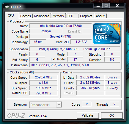

wojnar0 Posted January 11, 2011 Share Posted January 11, 2011 AnVAL 5.1.2 MacBook-Pro-wojnar:~ wojnar$ /Extra/Util/bdmesg ; exit; Config: [hd(0,2)/Extra/com.apple.Boot.plist] 846 bytes. CPU: Mobile Intel® Core(tm)2 Duo CPU T8300 @ 2.40GHz CPU: Thermal Monitor: TM, TM2, PROCHOT, FERR max: 12 current: 6 CPU: Tjmax ~ 104°C Temperature= ~ 40°C CPU: IDA: Enabled! CPU: Vendor/Family/ExtFamily: 0x756e6547/0x6/0x0 CPU: Model/ExtModel/Stepping: 0x17/0x1/0x6 CPU: Multipliers x10: max=120, min=60 CPU: MaxDiv/CurrDiv: 0x0/0x0 CPU: TSCFreq: 2394MHz CPU: CPUFreq: 2394MHz CPU: FSBFreq: 199MHz CPU: SLFM: 1 CPU: Enhanced SpeedStep: 1 CPU: NoCores/NoThreads: 2/2 CPU: Features: 0x26d803a3 Chipset is 965GM (pci id 0x2a008086) We have an NVIDIA Card Creating 2 Mode Tables New table with id : 0 New table with id : 1 First Standard VESA Table at offset 0x7bbb Second Standard VESA Table at offset 0x4832 Table #0 has 16 modes Table #1 has 32 modes Aspect Ratio is 16/10 Patching Table #0 : Mode 1024x768 -> 1440x900 (1047 1183 1343 770 776 805) Patching Table #1 : Mode 640x200 -> 640x400 (664 672 720 408 H- V+) Mode 640x350 -> 640x400 (664 678 720 408 H- V+) Mode 640x480 -> 640x400 (669 685 720 408 H- V+) Mode 640x480 -> 640x400 (669 685 720 408 H- V+) Mode 800x600 -> 800x500 (836 852 900 512 H- V+) Mode 800x600 -> 800x500 (836 852 900 512 H- V+) Mode 1024x768 -> 1024x640 (1071 1087 1152 656 H- V+) Mode 1024x768 -> 1024x640 (1071 1087 1152 656 H- V+) Mode 1280x1024 -> 1280x800 (1343 1359 1440 823 H- V+) Mode 1280x1024 -> 1280x800 (1343 1359 1440 823 H- V+) Mode 1400x1050 -> 1400x875 (1474 1488 1575 908 H+ V+) Mode 1600x1200 -> 1600x1000 (1674 1690 1800 1025 H- V+) Mode 2048x1536 -> 2048x1280 (2144 2160 2048 1314 H+ V+) Theme: [hd(0,2)]/Extra/Themes/Mint Resolution : 1440x900 (Graphics Mode key) Theme: [hd(0,2)]/Extra/Themes/Mint Found mode 1440x900 in VESA Table Config: [hd(0,2)/Extra/com.apple.Boot.plist] 846 bytes. Setting boot-uuid to: F959FE65-8D2E-348F-B794-62B4A262E3CA Closing VBios Table #0 : Freeing backup [OK] Table #0 : Freeing [OK] Table #1 : Freeing backup [OK] Table #1 : Freeing [OK] Freeing map [OK] header read size 200 Incorrect image signature Loading Darwin 10.6 Loading kernel /mach_kernel LoadDrivers: /Extra/Extensions.mkext LoadDrivers: /System/Library/Caches/com.apple.kext.caches/Startup/Extensions.mkext ACPI: [hd(0,2)/Extra/DSDT.aml] 27423 bytes. Using PCI-Root-UID value: 0 LAN Controller [10ec:8168] :: PciRoot(0x0)/Pci(0x1c,0x2)/Pci(0x0,0x0) Setting up lan keys SMBios: [hd(0,2)/Extra/smbios.plist] 646 bytes. Intel GM965/GL960 DRAM Controller [8086:2a00] at 00:00.0 Frequency detected: 332 MHz (665) Dual Channel CAS:5 tRC:5 tRP:5 RAS:15 (5-5-5-15) Slot: 0 Type 19 1024MB (DDR2 SDRAM) 666MHz Vendor=Samsung PartNo=M470T2953EZ3-CE63E SerialNo=74225C19 Slot: 2 Type 19 2048MB (DDR2 SDRAM) 666MHz Vendor=Samsung PartNo=M470T5663CZ3-CE63C SerialNo=261D3F87 Patched DMI Table Found SMBIOS System Information Table 1 Customizing SystemID with : 108adec0-ab9b-11dc-805a-efb9f38380ca ACPI: [hd(0,2)/Extra/DSDT.aml] 27423 bytes. ACPI: [hd(0,2)/Extra/SSDT-0.aml] 733 bytes. Table /Extra/SSDT-0.aml read and stored at: 1ad8000 ACPI: [hd(0,2)/Extra/SSDT-1.aml] 1254 bytes. Table /Extra/SSDT-1.aml read and stored at: 1ad9000 ACPI: [hd(0,2)/Extra/SSDT-2.aml] 1514 bytes. Table /Extra/SSDT-2.aml read and stored at: 1ada000 ACPI: [hd(0,2)/Extra/SSDT-3.aml] 700 bytes. Table /Extra/SSDT-3.aml read and stored at: 1adb000 ACPI: [hd(0,2)/Extra/SSDT-4.aml] 133 bytes. Table /Extra/SSDT-4.aml read and stored at: 1adc000 ACPI: [hd(0,2)/Extra/SSDT-5.aml] 200 bytes. Table /Extra/SSDT-5.aml read and stored at: 1add000 FADT: changing Preferred_PM_Profile from 0x00 to 0x02 FADT: Restart Fix applied ! FADT: Restart Fix applied ! Patched ACPI version 2 DSDT Starting Darwin x86_64 logout Still I have problem with: time cracky sound cracky movie preview Maybe something with my DSDT is not alright. Link to comment https://www.insanelymac.com/forum/topic/216726-anval-acpi-loader/page/50/#findComment-1620587 Share on other sites More sharing options...
valv Posted January 11, 2011 Author Share Posted January 11, 2011 @wojnar0, add FixFSB (value: Yes) to your boot.plist and see what happens oops, am seeing fsb = 199 on your bdmesg. are you using ForceFSB ? if yes, remove it. Link to comment https://www.insanelymac.com/forum/topic/216726-anval-acpi-loader/page/50/#findComment-1620593 Share on other sites More sharing options...

wojnar0 Posted January 11, 2011 Share Posted January 11, 2011 @wojnar0,add FixFSB (value: Yes) to your boot.plist and see what happens oops, am seeing fsb = 199 on your bdmesg. are you using ForceFSB ? if yes, remove it. I don't use ForceFSB. With FixFSB=Yes is worst, lower performance, still I have that bugs. Maybe I try without my SSDT Tables?? Last login: Tue Jan 11 19:07:14 on console /Extra/Util/bdmesg ; exit; MacBook-Pro-wojnar:~ wojnar$ /Extra/Util/bdmesg ; exit; Config: [hd(0,2)/Extra/com.apple.Boot.plist] 838 bytes. CPU: Mobile Intel® Core(tm)2 Duo CPU T8300 @ 2.40GHz CPU: Thermal Monitor: TM, TM2, PROCHOT, FERR CPU: Sticking with: [FSB: 200Mhz, Bus-Ratio: 12] CPU: Tjmax ~ 104°C Temperature= ~ 43°C CPU: IDA: Enabled! CPU: Vendor/Family/ExtFamily: 0x756e6547/0x6/0x0 CPU: Model/ExtModel/Stepping: 0x17/0x1/0x6 CPU: Multipliers x10: max=120, min=60 CPU: MaxDiv/CurrDiv: 0x0/0x0 CPU: TSCFreq: 2394MHz CPU: CPUFreq: 2400MHz CPU: FSBFreq: 200MHz CPU: SLFM: 1 CPU: Enhanced SpeedStep: 1 CPU: NoCores/NoThreads: 2/2 CPU: Features: 0x26d803a3 Chipset is 965GM (pci id 0x2a008086) We have an NVIDIA Card Creating 2 Mode Tables New table with id : 0 New table with id : 1 First Standard VESA Table at offset 0x7bbb Second Standard VESA Table at offset 0x4832 Table #0 has 16 modes Table #1 has 32 modes Aspect Ratio is 16/10 Patching Table #0 : Mode 1024x768 -> 1440x900 (1047 1183 1343 770 776 805) Patching Table #1 : Mode 640x200 -> 640x400 (664 672 720 408 H- V+) Mode 640x350 -> 640x400 (664 678 720 408 H- V+) Mode 640x480 -> 640x400 (669 685 720 408 H- V+) Mode 640x480 -> 640x400 (669 685 720 408 H- V+) Mode 800x600 -> 800x500 (836 852 900 512 H- V+) Mode 800x600 -> 800x500 (836 852 900 512 H- V+) Mode 1024x768 -> 1024x640 (1071 1087 1152 656 H- V+) Mode 1024x768 -> 1024x640 (1071 1087 1152 656 H- V+) Mode 1280x1024 -> 1280x800 (1343 1359 1440 823 H- V+) Mode 1280x1024 -> 1280x800 (1343 1359 1440 823 H- V+) Mode 1400x1050 -> 1400x875 (1474 1488 1575 908 H+ V+) Mode 1600x1200 -> 1600x1000 (1674 1690 1800 1025 H- V+) Mode 2048x1536 -> 2048x1280 (2144 2160 2048 1314 H+ V+) Theme: [hd(0,2)]/Extra/Themes/Mint Resolution : 1440x900 (Graphics Mode key) Theme: [hd(0,2)]/Extra/Themes/Mint Found mode 1440x900 in VESA Table Config: [hd(0,2)/Extra/com.apple.Boot.plist] 838 bytes. Setting boot-uuid to: F959FE65-8D2E-348F-B794-62B4A262E3CA Closing VBios Table #0 : Freeing backup [OK] Table #0 : Freeing [OK] Table #1 : Freeing backup [OK] Table #1 : Freeing [OK] Freeing map [OK] header read size 200 Incorrect image signature Loading Darwin 10.6 Loading kernel /mach_kernel LoadDrivers: /Extra/Extensions.mkext LoadDrivers: /System/Library/Caches/com.apple.kext.caches/Startup/Extensions.mkext ACPI: [hd(0,2)/Extra/DSDT.aml] 27423 bytes. Using PCI-Root-UID value: 0 LAN Controller [10ec:8168] :: PciRoot(0x0)/Pci(0x1c,0x2)/Pci(0x0,0x0) Setting up lan keys SMBios: [hd(0,2)/Extra/smbios.plist] 646 bytes. Intel GM965/GL960 DRAM Controller [8086:2a00] at 00:00.0 Frequency detected: 333 MHz (666) Dual Channel CAS:5 tRC:5 tRP:5 RAS:15 (5-5-5-15) Slot: 0 Type 19 1024MB (DDR2 SDRAM) 666MHz Vendor=Samsung PartNo=M470T2953EZ3-CE63E SerialNo=74225C19 Slot: 2 Type 19 2048MB (DDR2 SDRAM) 666MHz Vendor=Samsung PartNo=M470T5663CZ3-CE63C SerialNo=261D3F87 Patched DMI Table Found SMBIOS System Information Table 1 Customizing SystemID with : 108adec0-ab9b-11dc-805a-efb9f38380ca ACPI: [hd(0,2)/Extra/DSDT.aml] 27423 bytes. ACPI: [hd(0,2)/Extra/SSDT-0.aml] 733 bytes. Table /Extra/SSDT-0.aml read and stored at: 1ad8000 ACPI: [hd(0,2)/Extra/SSDT-1.aml] 1254 bytes. Table /Extra/SSDT-1.aml read and stored at: 1ad9000 ACPI: [hd(0,2)/Extra/SSDT-2.aml] 1514 bytes. Table /Extra/SSDT-2.aml read and stored at: 1ada000 ACPI: [hd(0,2)/Extra/SSDT-3.aml] 700 bytes. Table /Extra/SSDT-3.aml read and stored at: 1adb000 ACPI: [hd(0,2)/Extra/SSDT-4.aml] 133 bytes. Table /Extra/SSDT-4.aml read and stored at: 1adc000 ACPI: [hd(0,2)/Extra/SSDT-5.aml] 200 bytes. Table /Extra/SSDT-5.aml read and stored at: 1add000 FADT: changing Preferred_PM_Profile from 0x00 to 0x02 FADT: Restart Fix applied ! FADT: Restart Fix applied ! Patched ACPI version 2 DSDT Starting Darwin x86_64 logout [Proces zakończony] Link to comment https://www.insanelymac.com/forum/topic/216726-anval-acpi-loader/page/50/#findComment-1620642 Share on other sites More sharing options...

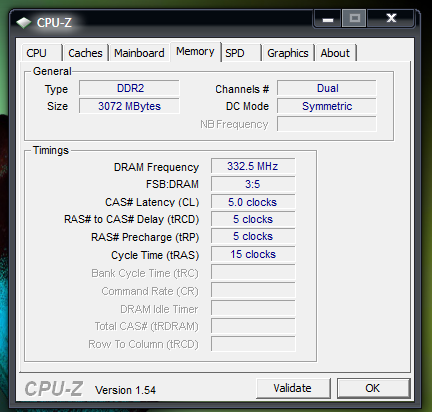

wojnar0 Posted January 11, 2011 Share Posted January 11, 2011 does this happen with anval only ? do u remember since which version it did appear ? what about other boot-loaders ? That problems was started from 5.0.6 or 5.0.7. Here are screenshots from Win7, check it, please. Multiplier was moving from 12.5 to 13 Bus Speed was stable 199.5 Rated FSB was moving 797.7 to 798.0 And dump from CPU-Z DESKTOP.txt.zip Maybe that can help you. Thanks Link to comment https://www.insanelymac.com/forum/topic/216726-anval-acpi-loader/page/50/#findComment-1620793 Share on other sites More sharing options...
