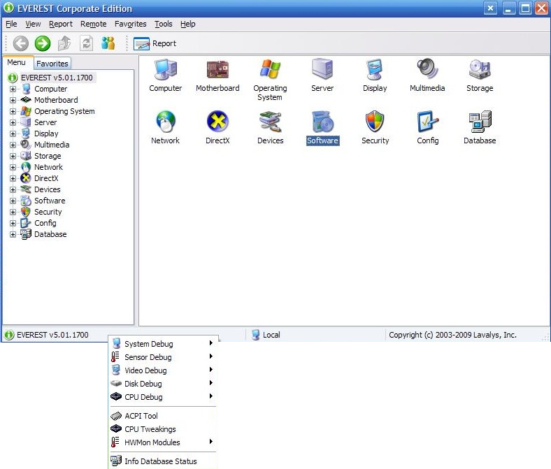

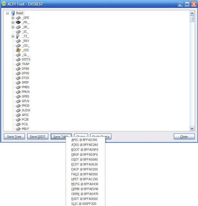

The Mont Everest:
Go get Everest Ultimate (unregistered) edition and install/unzip on windows
Launch it and click on the status bar (rights). from there u will get the possibility to dump your Tables

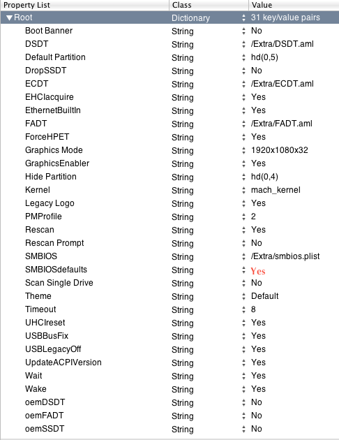

my boot.plist
these keys are available only when using the above bootloader.
Edit: pay attention to the value of SMBIOSdefaults key. This have to be changed to Yes.
Only then u can get rid of CPUInjector.kext from the above list. After reboot, your processor's model will be handled directly by the boot-loader.

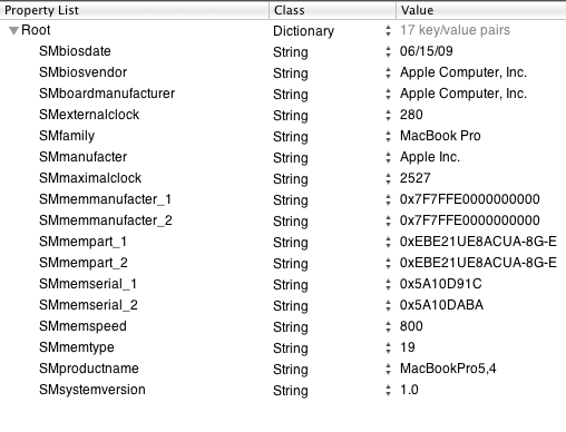

my smbios.plist
Pay attention to the SMexternalclock key. U can always keep 266 as value (280 is purely for OC'ing intentions :()

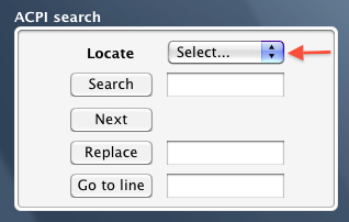

DSDT Fix
Ok, now that we all have DSDT extracted, go get this nifty editor from www.osx86.es and set it up. when done open your DSDT file with it, and let's start editing it.

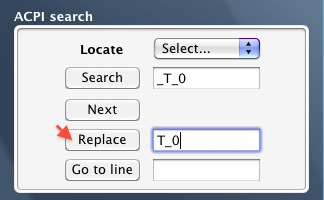

As is this file would compile successfully, but to get rid of every warning/remark, we have to fix our file like this:
1) Type _T_0 on the search field and T_0 on the Replace field like showing here,
then click on Replace

1) do you have native speedstep ? If yes , why do you have dropssdt=no in your boot.plist ?
2) is your SMexternalclock=280 correct in your smbios.plist? Isn't it 266?
Thanks !
Mal
hi Mal,
to be short:
1) yes, speed-step is working fine.
regarding DropSSDT key, I think u misunderstanding how it works. In fact DropSSDT=No means u load these tables. It depends though, either u load 'em from Bios or from HDD. please play with these values a little, it'll help u understand. If u still confused, give feedback into the right topic.
2) It may seem like I was mistyping the external clock value, but I ensure this and many more will be cleared later on the guide :D
