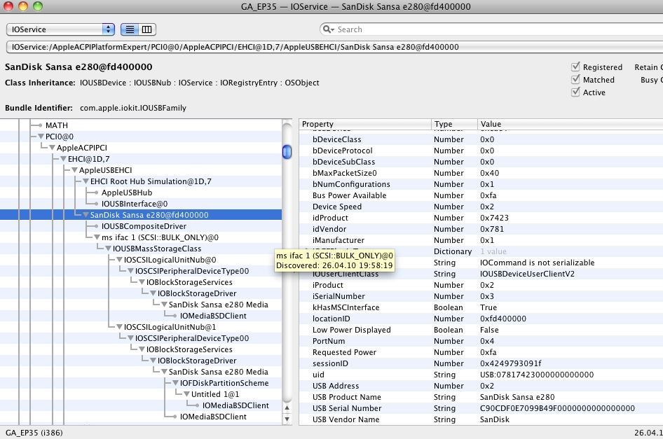

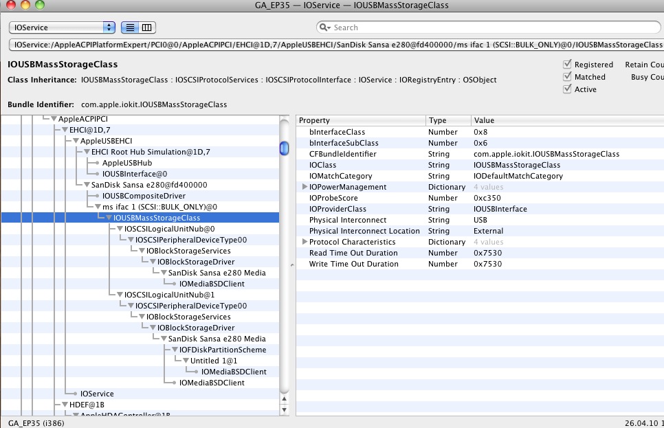

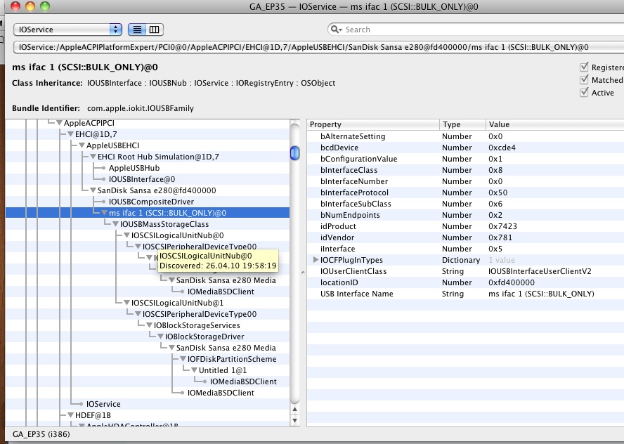

mitch_de Posted April 26, 2010 Share Posted April 26, 2010 If it has mass storage link it should work precisely as said in tutorial.Use IORegistryExplorer for looking up SCSI id of the phone. Thanks ! But i always stuck at your readme at this SCSI ID !!! IOService:/AppleACPIPlatformExpert/PCI0@0/AppleACPIPCI/EHC1@1D,7/AppleUSBEHCI/Storage@fd100000/MSC Bulk-Only Transfer@0/IOUSBMassStorageClass/IOSCSIPeripheralDeviceNub Storage may vary… Edit the plist and insert them under: - AnyiPodSBCDriver - Fake iPod SCSI ID - Fake iPod SBC ID all 3 unclear ! I cant find any IOSCSIPeripheralDeviceNub data/ID/entry below IOUSBMassStorageClass. But my Sansa E280 is an USB Massstorage 1 interneal 1 mycrosd card I posted my IORefistryExplorer Screenshoots . Please help and maybe clear/update tthat part of the readme. Link to comment https://www.insanelymac.com/forum/topic/214252-anyipod-for-making-any-usb-mp3-player-an-ipod/#findComment-1456250 Share on other sites More sharing options...
Andy Vandijck Posted April 26, 2010 Author Share Posted April 26, 2010 Thanks !But i always stuck at your readme at this SCSI ID !!! IOService:/AppleACPIPlatformExpert/PCI0@0/AppleACPIPCI/EHC1@1D,7/AppleUSBEHCI/Storage@fd100000/MSC Bulk-Only Transfer@0/IOUSBMassStorageClass/IOSCSIPeripheralDeviceNub Storage may vary… Edit the plist and insert them under: - AnyiPodSBCDriver - Fake iPod SCSI ID - Fake iPod SBC ID I cant find any IOSCSIPeripheralDeviceNub data/ID/entry below IOUSBMassStorageClass. But my Sansa E280 is an USB Massstorage 1 interneal 1 mycrosd card I posted my IORefistryExplorer Screenshoots . Please help and maybe clear/update tthat part of the readme. Apparently I need to update the driver for a device like that. I don't think it's compatible with this driver... Link to comment https://www.insanelymac.com/forum/topic/214252-anyipod-for-making-any-usb-mp3-player-an-ipod/#findComment-1456257 Share on other sites More sharing options...
mitch_de Posted April 27, 2010 Share Posted April 27, 2010 Thanks for clearing. Perhaps rewrite is not to much, because my SANSA is an USB MassStorage Device, also uses some IOSCSILogicalUnit, only that IOSCSIPeriphalDeviceNub is not used /not found. Link to comment https://www.insanelymac.com/forum/topic/214252-anyipod-for-making-any-usb-mp3-player-an-ipod/#findComment-1456506 Share on other sites More sharing options...
