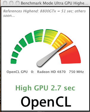

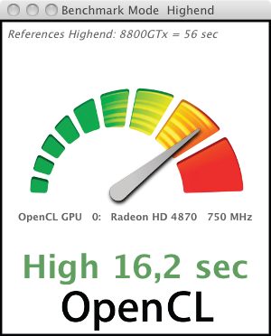

Boombeng Posted April 14, 2010 Share Posted April 14, 2010 HD4850 Gainward Golden Sample - 10.6.3 Benchmark Highend GPU Note that the score is lightly better than Hangten's one that I guess has a stock HD4850 ; the only difference between Gainward HD4850GS and stock HD4850 is GPU and Memory clock (700/1100MHz for the GS and 625/923MHz for the stock), they have the same quantity of shaders. Link to comment Share on other sites More sharing options...

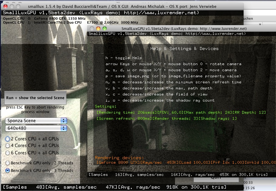

mitch_de Posted April 15, 2010 Author Share Posted April 15, 2010 Thanks ! Have you tried the new (in 1.5.4) sponza scene, which puts very much load on OpenCL ? I get in GPU only mode (3 threads on NV 8800GTX, needs in High Benchmark Mode 59 sec) around 16 kSamples/sec (avg.) and 453 kRays/Sec (avg.). Let it run some time - avg. values needs some time (at least 2 minutes of fast gpu, 5 min on slower gpus) Would be interesting if ATI 4870 is also 3,9 times faster or even more faster (4+) / less faster (3+). EDIT: iMac 27" ATI 4850M ist incredible fast for an mobile GPU ! Benchmark high mode in 21 sec , RESPECT ! Link to comment Share on other sites More sharing options...

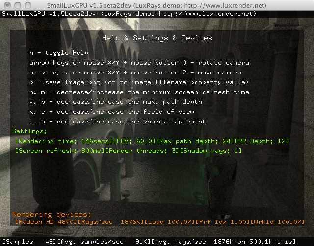

Boombeng Posted April 15, 2010 Share Posted April 15, 2010 Here we go, still gainward HD4850 GS and 10.6.3 Sponza Scene 640x480 Gpu only 3 threads : 91 kSamples/sec 1876 kRays/sec Link to comment Share on other sites More sharing options...
mitch_de Posted April 15, 2010 Author Share Posted April 15, 2010 Thanks ! 91 kSamples/sec ATI 4850 vs 16 kSamples/sec with Nvidia 8800GTX - RESPEKT Even more difference than in the benchmark mode, which does less complex scene luxxball as benchmark. My 8800GTX got only 16 kSamples/Sec = 5.7 times slower ! 8800GTX =59 sec in High Benchmark Mode vs 17 sec ATI 4850 = "only" 3.5 times slower Link to comment Share on other sites More sharing options...

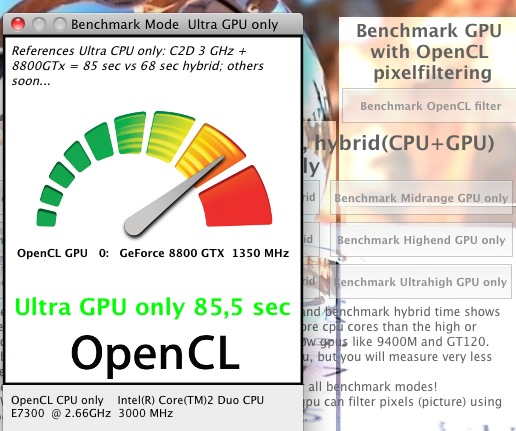

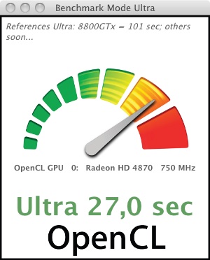

mitch_de Posted April 16, 2010 Author Share Posted April 16, 2010 Updated to 1.5.5. Added Ultra highend Benchmarkmode (diff to High: uses much more complex sponza scene than luxxball ) ! 8800 GTX = 101 sec GTX 285 (Mac) = 44,7 sec As before, any 48xx gpu will outperform that (pain for my 8800GTX ) Link to comment Share on other sites More sharing options...
Boombeng Posted April 16, 2010 Share Posted April 16, 2010 As expected... 1.5.5. Ultra high Benchmark Gainward HD4850 GS Link to comment Share on other sites More sharing options...

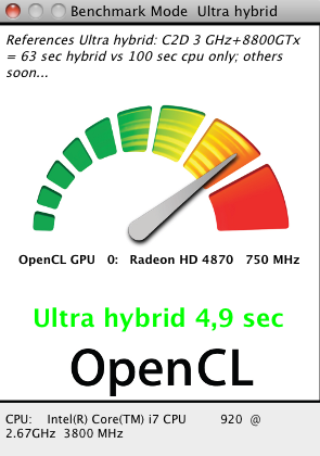

Pencs Posted May 5, 2010 Share Posted May 5, 2010 Not sure what's going on, because seeing everyone else's results, these seem a little far fetched.... I'm running a i7 920 @ 2.7ghz, with 12gb RAM and a Sapphire 4890. Link to comment Share on other sites More sharing options...

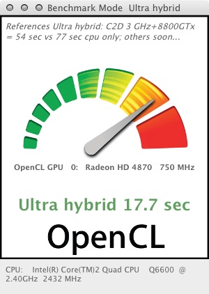

N00bishMacer Posted May 5, 2010 Share Posted May 5, 2010 Here is what l got with my Hackintosh Q6600, 4G Gskill, P35-DS3P and ASUS 4870: Link to comment Share on other sites More sharing options...

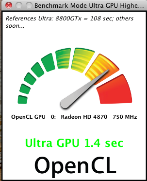

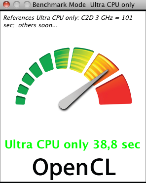

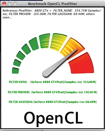

mitch_de Posted May 7, 2010 Author Share Posted May 7, 2010 Ultra High GPU only was an Bug. Now 1.6.0 available ! I added OpenCL Pixel Filter benches and cleanded up the gui. Now all gpu only benches ware beside cpu only and hybrid and use same settings. Before the gpu only benches had own settings compared to hybrid + cpu only. Now its more clear and should be bugfree. Ready to collect references again (will hold next versions). Att pixelfilter Mega Samples/Sec of 8800GTX and Ultra GPU only (4870 will perform much faster, but not anymore 1,6 sec ) Link to comment Share on other sites More sharing options...

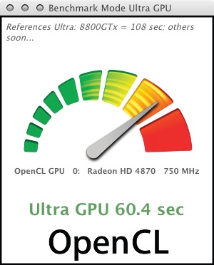

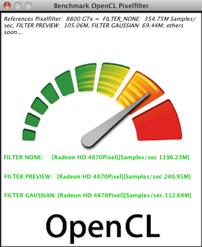

kerr Posted May 11, 2010 Share Posted May 11, 2010 Smallux 1.6.2 with OSX 10.6.3 Luxbals 800x600 Link to comment Share on other sites More sharing options...
mitch_de Posted May 12, 2010 Author Share Posted May 12, 2010 Thanks ! Really huge MegaSamples/Sec in the new pixelfilter bench ! I will use that 4870 values as reference for that model. 4850 is a bit slower, but as before much faster than 8800GTX or even GTX 260. PS: The scene or resolution settings havent any effect in all benchmarks. They all use fixed settings. Link to comment Share on other sites More sharing options...

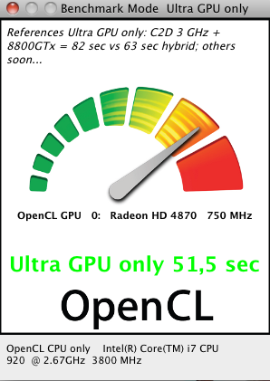

MaLd0n Posted May 29, 2010 Share Posted May 29, 2010 smallluxGPU 1.6.2 Link to comment Share on other sites More sharing options...

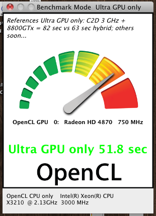

mitch_de Posted May 30, 2010 Author Share Posted May 30, 2010 Thanks for detailed results. Compared to the fastest Mac Nvidia GTX 280 comuting on GPU (by OpenCL) is much faster. But ATI OpenCL driver part of OpenCL pciture support isnt fast as the "normal" OpenCL driver part. GTX280 with a Core i5-750 2.66ghz CPU Only Ultra: 74.4sec Hybrid Ultra: 40.4sec GPU Only Ultra: 39.7sec (ATI 4870 near twice as fast) OpenCL pic filtering benchmark: (ATI is weak here, compared to normal OpenCL code speed) FILTER NONE: 875.99M FILTER PREVIEW: 272.68M FILTER GAUSSIAN: 142.42M (twice as fast ATI 4870! in complex picture OprnCL filtering) Link to comment Share on other sites More sharing options...
