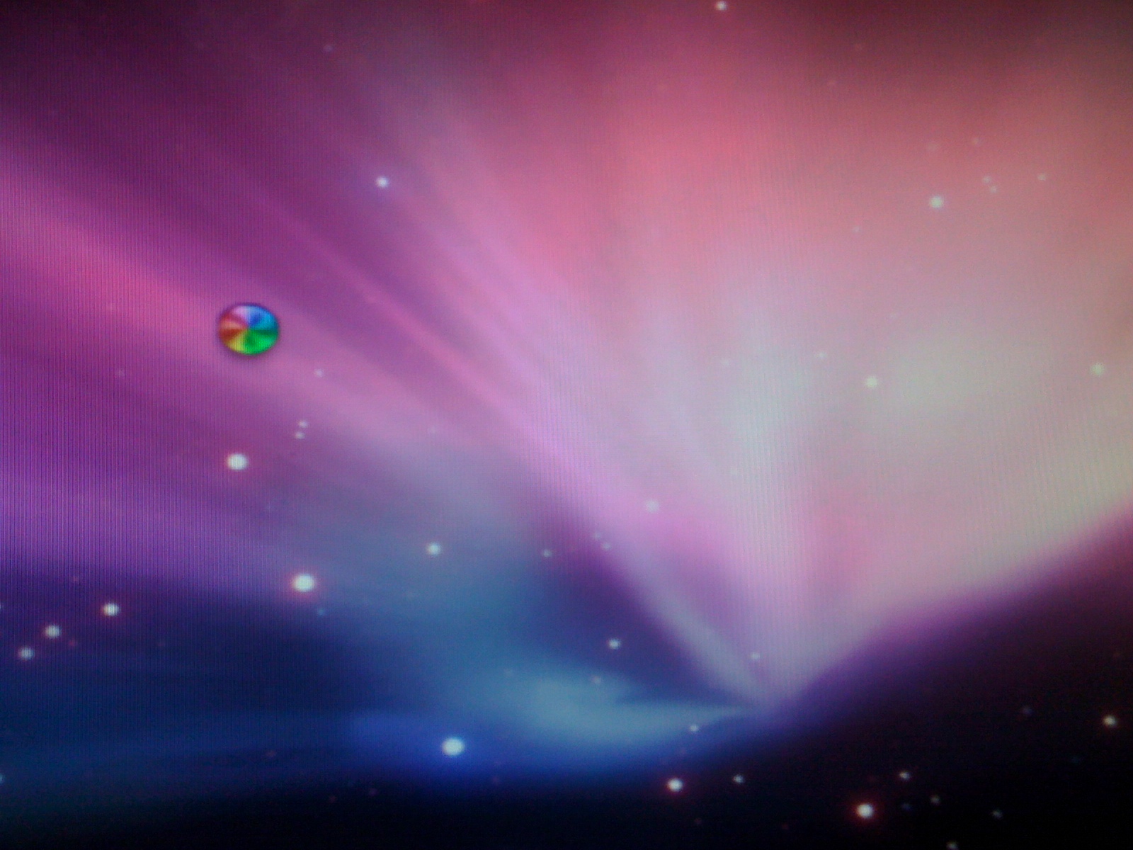

hotboi Posted April 4, 2010 Share Posted April 4, 2010 Got a P5Q-PRO running 10.5.7 with dual dvi ATI HD 3650. Tried your method and I only get the spinning beach ball. Tried with a USB and tried with a 50gb hard drive, same result. Booted with -v and saw some yellow text that said "failed" and then froze there. Booted with -x -v and saw same yellow text and froze at the spinning beach ball. Link to comment https://www.insanelymac.com/forum/topic/213336-guide-snow-leopard-retail-106x-on-p5q-series/page/2/#findComment-1441826 Share on other sites More sharing options...

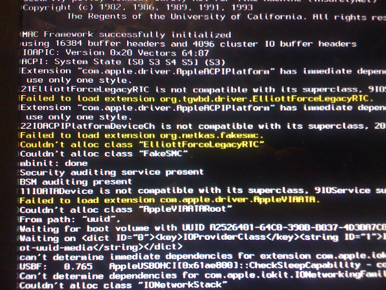

RoberT_XeS Posted April 4, 2010 Author Share Posted April 4, 2010 Which Motherboard are you using? Can you please provide me the details on the yellow message that you received.....so that I can help if possible.... If possible please post the screen shot of the error message that you received Also are you getting this error message before installing or after installing Snow Leopard.? Got a P5Q-PRO running 10.5.7 with dual dvi ATI HD 3650. Tried your method and I only get the spinning beach ball. Tried with a USB and tried with a 50gb hard drive, same result. Booted with -v and saw some yellow text that said "failed" and then froze there. Booted with -x -v and saw same yellow text and froze at the spinning beach ball. Link to comment https://www.insanelymac.com/forum/topic/213336-guide-snow-leopard-retail-106x-on-p5q-series/page/2/#findComment-1442005 Share on other sites More sharing options...
hotboi Posted April 4, 2010 Share Posted April 4, 2010 Which Motherboard are you using? Can you please provide me the details on the yellow message that you received.....so that I can help if possible.... If possible please post the screen shot of the error message that you received Also are you getting this error message before installing or after installing Snow Leopard.? My motherboard is a ASUS P5Q PRO. Bought it from newegg http://www.newegg.com/Product/Product.aspx...N82E16813131299 I'm getting this error msg b4 I install SL. I will post pics later. Thanks for all ur hard work. Edit: here's the pics Link to comment https://www.insanelymac.com/forum/topic/213336-guide-snow-leopard-retail-106x-on-p5q-series/page/2/#findComment-1442042 Share on other sites More sharing options...

gerryka Posted April 5, 2010 Share Posted April 5, 2010 Hi, Thanks for the awesome guide, tried it out today on my P5Q Deluxe. When booting from the USB drive with -v option, nothing tellling is displayed, but after it tries to switch the display-resolution for the main setup my screen stays black and my display goes to sleep. Any ideas what i could try? I already used various kext-configurations including NVenabler for 10.6 (got a Nvidia GTX285). Link to comment https://www.insanelymac.com/forum/topic/213336-guide-snow-leopard-retail-106x-on-p5q-series/page/2/#findComment-1442198 Share on other sites More sharing options...

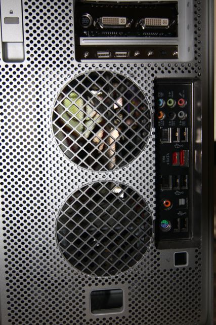

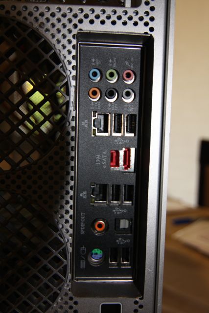

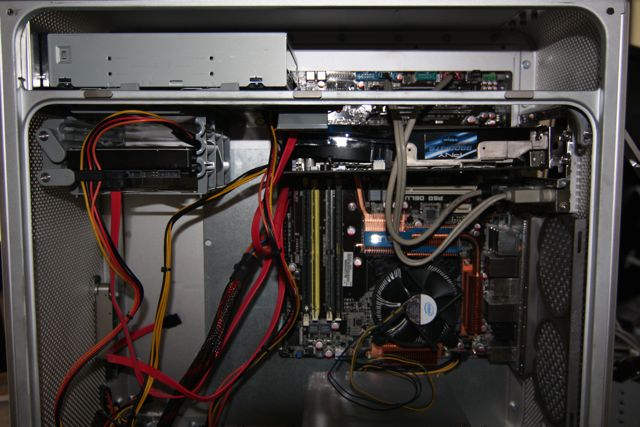

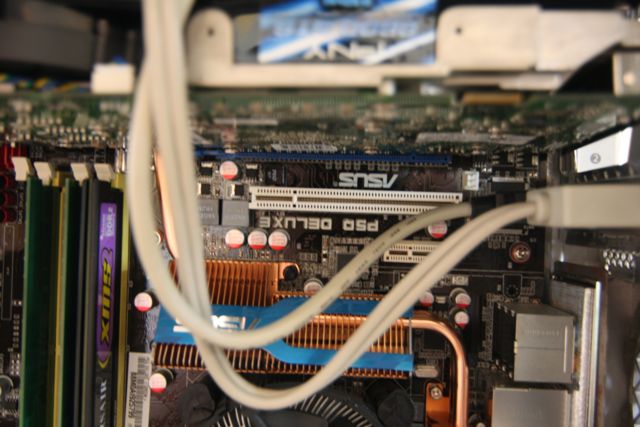

Digital1 Posted April 5, 2010 Share Posted April 5, 2010 I know this might be a dumb question but does your Vid Card have 2 outputs? DVI and VGA? Try switching them? Seems like your system is looking for another VCard or its the wrong Kext file. I am running at Nvidia 6800 GTX on my P5Q Deluxe and i never even had to use the NVenabler. The SL image i used was from a retail package that i bought. Link to comment https://www.insanelymac.com/forum/topic/213336-guide-snow-leopard-retail-106x-on-p5q-series/page/2/#findComment-1442202 Share on other sites More sharing options...

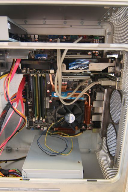

Digital1 Posted April 5, 2010 Share Posted April 5, 2010 As promised some pics of my system.. Link to comment https://www.insanelymac.com/forum/topic/213336-guide-snow-leopard-retail-106x-on-p5q-series/page/2/#findComment-1442209 Share on other sites More sharing options...

RoberT_XeS Posted April 5, 2010 Author Share Posted April 5, 2010 My motherboard is a ASUS P5Q PRO. Bought it from newegg http://www.newegg.com/Product/Product.aspx...N82E16813131299 I'm getting this error msg b4 I install SL. I will post pics later. Thanks for all ur hard work. Edit: here's the pics Remove the following kexts from the Extra > Extensions Folder ElliotForceLegacyRTC.kext and AppleVIAATA.kext and then try to install Snow Leopard and let us know....... Even then if it does not work then try using the FakeSMC from the myHackInstaller instead of the one that I included Hi,Thanks for the awesome guide, tried it out today on my P5Q Deluxe. When booting from the USB drive with -v option, nothing tellling is displayed, but after it tries to switch the display-resolution for the main setup my screen stays black and my display goes to sleep. Any ideas what i could try? I already used various kext-configurations including NVenabler for 10.6 (got a Nvidia GTX285). Did you try the -x option while booting? try it and then let us know what happens As promised some pics of my system.. Looks Good Hi, i want to install SL on a P5Q based board from asus (I have an asus V4-P5G45 barebone with a P5Q-EM-V-P5G45 board) but unfortunately I couldn't find any modified bios for that. Can someone please modify the latest bios (0405) for me or tell me how the bios can be modified. I look around but couldn't find any tutorial on modifying the bios. Thx in advance ak187 Request Shamux to modify the Bios for you Mine looks like this..... The Black one....I have added a White apple Logo to it....Looks like a Black Mac Link to comment https://www.insanelymac.com/forum/topic/213336-guide-snow-leopard-retail-106x-on-p5q-series/page/2/#findComment-1442586 Share on other sites More sharing options...
gerryka Posted April 6, 2010 Share Posted April 6, 2010 Did you try the -x option while booting? try it and then let us know what happens Thanks for the tip! Since the install runs through with the Graphics-disabler included in the Install-DVD Image I tried the -x option on the installed OS X. As soon as the desktop should come up.. display goes blank again. I suppose the myHack modifications are only used while booting to the setup. Once it's installed on the harddrive, the default options are used, without the Graphics-disabler... sounds strange to me but that's the only reason I can come up with. Correct me if i'm wrong please. Link to comment https://www.insanelymac.com/forum/topic/213336-guide-snow-leopard-retail-106x-on-p5q-series/page/2/#findComment-1442803 Share on other sites More sharing options...
