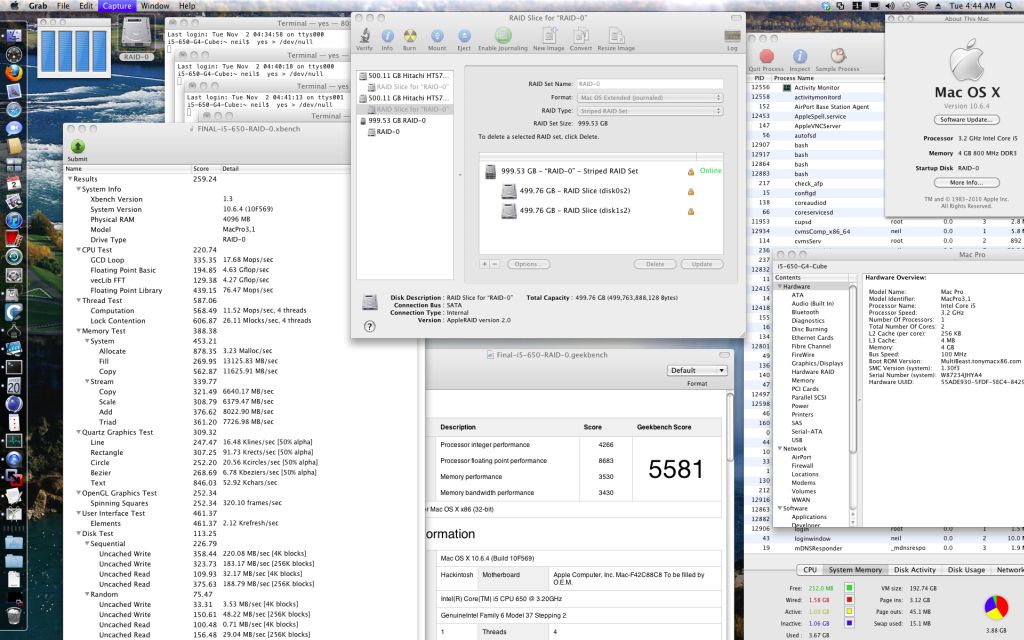

neil43 Posted November 7, 2010 Share Posted November 7, 2010 Another G4 Cube Hackintosh. Just to document that it has been done with the Zotac H55ITX-A-E mother board, 4GB memory, an i5-650, 2 SATA 500GB HDDs in RAID 0 and a GeForce 8400 GS. OS X install retail 10.6.3 upgraded to 10.6.4 with all updates using TonyMacX86’s [url="http://www.insanelymac.com/forum/topic/279450-why-insanelymac-does-not-support-tonymacx86/"]#####[/url] Supported and [url="http://www.insanelymac.com/forum/topic/279450-why-insanelymac-does-not-support-tonymacx86/"]#####[/url] tool set. Board Stack I did this because I own the mother board and it is a good hack. However it is not the best suited MB for this conversion. As you will see in the photos the 24 pin power connector is not in the best location. I elected to use the PICO 160 Watt PSU with an outboard power brick. The PSU module deflects the memory module when the PSU module is installed directly into the MB power connector. This drove me to use a power extension cable and mount the PSU in the location shown. The MB size is a little wider then the stock bottom panel. Grinding down the central rib on the panel at the point of contact provides a very close contacting fit. The OS X non-support of the Intel HD Graphics dictates selecting a video card that would fit within the space available. I used a GeForce 8400 GS. Using an external graphics card drives using a PCIE extender of some sort (because the PCIE slot location prohibits standard slot mount of the card in the form factor). I located a flat cabled extender (from China) via a Canadian reseller. As you can see I located the card below the MB and the space allocated is for a video card with a taller fan then used in the final form. I cut way a good portion of the bottom panel and did away for the stock side rails, latch handle, and original mounting bracket. The core module is secured to the outer can by two long stand-off parts and thumb screw at the bottom. CPU Selection: Wanting to run a i7-860 drove a search for a CPU Cooler that could do the job in a very confined space and even then I felt it necessary to add a pair of exhaust fans (again see the photos). The CPU cooler is a Zalman CNPS8000A which comes with an adjustable fan speed controller (see black knob on the bottom panel). With the i7-860, the hack idled in the low 40's and under full load would get up into the mid to high 80's C with system fully panel and setting in the upright orientation. Unfortunately, the system was not stable and would go into a thermal shutdown. With the i7-860 the input AC to the power brick was 68 to 70 watts idle and over 200+ watts with the 8 threads running 100% load. It is not clear if the PSU folded back or if the CPU initiated the thermal shutdown. Never the less these conditions dictated moving to a lower power CPU. I used an i5-650 previously purchased for another project. The idle input power is 57 to 60 watts and fully loaded runs about 102 watts. The CPU idle temp is 33 to 35 degrees C, and after an hour run with 4 threads at full 100% load the CPU loaded temp was stable at 80 to 81 degrees C. Drive Stack I wanted to reuse the original optical dirve in the Hack and this drove finding an IDE to SATA adapter. I used a Vantek device and made up a 90 degree connector. OBW this drive will not read dual layer DVDs. Below the optical drive are two 500GB 7200 RPM 2 1/2 drives (running a SW RAID 0 configuration). For convenience I wired in an extra SATA power cable/connector (so that I can patch in a maintenance hard drive or optical drive). Chassis I retained the top and bottom panels, corner rails, drive frame, outer can and the clear housing. I modified each part as needed. The corner rails are about the only part that did not get tweaked. As mentioned above, I added two 40mm exhaust fans mounted to the top panel. I cut down the thickness of the stock top center vent piece and undercut the center ribs to clear the fan. I removed the end rib on each end and added a Power LED, a HDD LED, Audio ports, an USB port and a Power Button. I retained the original colors with exception of the center vent piece and the bottom panel (painted semi-gloss black). I have played with the original proximity switch and my initial effort did not work out. I located another guide that may give better results but requires fine pitch soldering skills (not my best skill). So that is a work in progress which I will document at a later date should I have success. Parts List: Case - G4 Cube – source craigslist Mother Board – Zotac H55ITX-A-E - source NewEgg Video Card – BFG 8400GS D512M - source Fry’s Electronics Memory – Patriot DDR3 [2x2GB] 1333MHz, PSD34G1333K - source Fry’s Electronics PSU – picoPSU-160-XT source Mini-Box.com PCIE Extender – PCI-E PCI-Express 16x Riser Card Extender, EG0665 - source 9Mart.com IDE to SATA - Vantek CB-IS100, source Fry’s Electronics ABS sheets – source Tap Plastics ABS Glue – source OSH Black Oxide Screws – source McMaster Carr Threaded stand-offs – source McMaster Carr Steel sheet – source McMaster Carr Black Paint – Semi-Gloss Black Rust-Oleum – source OSH 40mm Fans – SilenX IXtreama Pro 40mm Case Fan IXP-11-14 – source Fry’s Electronics 12” SATA Cables – source Micro Center CPU – Intel i5-650 – source Micro Center CPU Cooler – Zalman CNPS8000A – source Central Computers Hard Disk - Hitachi Travelstar 500GB 7200 RPM HD20500IDK/7K – source Fry’s Electronics Power switch, Audio ports, USB socket, LEDs, DC cable and connectors – source recycled salvage parts Case Polish – used to recover clear outer cover – Tap Plastics Plastic Ties – source Fry’s Electronics I had high hopes that the i7-860 CPU would be usable in this hack. The plus 200 watt input load was apparently just too much for the PSU which is rated at 160 watts with peaks to 200. Also I had intended to use a XFX GT 240 video card which gave me major integration problems and instability in this system. With the current configuration described the system is stable and runs 24/7 without issue. Fan noise: I have the Zalman cooler fan at the low speed position and the two exhaust fans can be heard in a quite room. I am thinking of removing the exhaust fans in the future as they appear to not be needed with the i5-650 (I have blocked the fans for short periods and do not see much increase in the system temps). Photos follow: That's it for now. Here is a system window shot: Running 4 threads @ 100%. Link to comment https://www.insanelymac.com/forum/topic/211764-g4-cube-plans/page/2/#findComment-1578385 Share on other sites More sharing options...

Polytonic Posted November 22, 2010 Share Posted November 22, 2010 Why were you unable to put in the GT240? Was it a wattage limitation, or was it because the XFX GT240 is a slot and a half wide? I was planning to do almost exactly the same build, except with an i3, the Gigabyte H55N, and the EVGA GT240 (single-slot). Edit: Rather than using Grab, you can also use Shift-Cmd-4. Link to comment https://www.insanelymac.com/forum/topic/211764-g4-cube-plans/page/2/#findComment-1589182 Share on other sites More sharing options...
neil43 Posted November 23, 2010 Share Posted November 23, 2010 Why were you unable to put in the GT240? Was it a wattage limitation, or was it because the XFX GT240 is a slot and a half wide? I was planning to do almost exactly the same build, except with an i3, the Gigabyte H55N, and the EVGA GT240 (single-slot). Edit: Rather than using Grab, you can also use Shift-Cmd-4. The XFX GT240 was chosen for it overall length which is less then 6.75 inches and does fit within the space available. The GT240 just would not run (in a stable fashion) on the cable riser card assembly. It would run plugged directly into the MB and it seemed stable and fast. A shorter path might resolve the issues. Anyway, time goes and I have pulled the Zotac MB and swapped in an ECS H55H-I card (which is very similar in layout to the Gigabyte H55N). There are still problems due to layout. The Pico PSU won't fit directly into the power slot.. components hang outside of the space allowed. This caused me to make up a three inch power extender cable to get around that issue. And with the memory on the very back edge of the MB (which becomes the top when in G4 Cube orientation) caused me to re-build my top panel (and left off the exhaust fans). The system runs well on Apple OSX 10.6.5 with the i5-650. With the MB swap I did loose the AirPort WiFi and am running a USB WiFi dongle. The ECS MB was $80 compared to the Zotac at $130. I am not entirely happy with the ECS MB in that I have yet to sort out the internal USB headers, also have a problem where the system is not seen by other OS X machines on the network (no sharing). But then if things were simple I would be bored. neil Link to comment https://www.insanelymac.com/forum/topic/211764-g4-cube-plans/page/2/#findComment-1589623 Share on other sites More sharing options...
