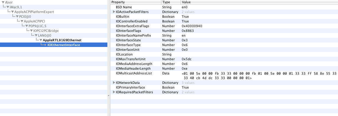

flAked Posted June 12, 2011 Share Posted June 12, 2011 I found out that Chameleons GraphicsEnabler creates quite a different definition for my card which works with the method described here (using gfxutil to convert the plist). I took the opportunity and added the built-in attribute for ethernet, but it doesn't show in IOReg, can someone confirm please? mrmojo? It seems that even on the MBP8 built-in shows 0 for the ethernet device, but IOBuiltin = Yes for the actual IOEthernetInterface. Link to comment https://www.insanelymac.com/forum/topic/208807-how-to-boost-the-os-x-boot-process/page/41/#findComment-1696735 Share on other sites More sharing options...
mrmojorisin17 Posted June 13, 2011 Share Posted June 13, 2011 I took the opportunity and added the built-in attribute for ethernet, but it doesn't show in IOReg, can someone confirm please? mrmojo? Confirm. I also tried with one of the lastest Chameleon rev and this on my c.a.b.p.: <key>EthernetBuiltIn</key> <string>Yes</string> Doesn't work. Link to comment https://www.insanelymac.com/forum/topic/208807-how-to-boost-the-os-x-boot-process/page/41/#findComment-1697254 Share on other sites More sharing options...
FKA Posted June 16, 2011 Share Posted June 16, 2011 Confirm.I also tried with one of the lastest Chameleon rev and this on my c.a.b.p.: <key>EthernetBuiltIn</key> <string>Yes</string> Doesn't work. I've had some problems with ethernet not showing as built-in also: With my network card sitting under - Device (P0P9) I originally had this in my dsdt: Device (P0P9) { Name (_ADR, 0x001C0005) Method (_PRW, 0, NotSerialized) { Return (GPRW (0x09, 0x04)) } Method (_PRT, 0, NotSerialized) { If (PICM) { Return (AR09) } Return (PR09) } } Device (LAN0) { Name (_ADR, Zero) Method (_DSM, 4, NotSerialized) { Store (Package (0x08) { "location", Buffer (0x02) { "1" }, "built-in", Buffer (0x02) { 0x01 }, "device_type", Buffer (0x09) { "ethernet" }, "name", Buffer (0x24) { "Realtek RTL8111/8168B PCI-E Gigabit" } }, Local0) DTGP (Arg0, Arg1, Arg2, Arg3, RefOf (Local0)) Return (Local0) } } } In IORegExplorer his simply showed LAN0 as a device under PCI0 (not P0P9) and had no kext associated with it. My actual ethernet device sat under P0P9 but with none of the edits I'd made to DSDT. I'm now using the code bellow and en0 is shown now in ioreg under LAN0 and is shown as 'built-in' Device (P0P9) { Name (_ADR, 0x001C0005) Device (LAN0) { Name (_ADR, Zero) Method (_PRW, 0, NotSerialized) { Return (GPRW (0x09, 0x04)) } Method (_PRT, 0, NotSerialized) { If (PICM) { Return (AR09) } Return (PR09) } } Method (_DSM, 4, NotSerialized) { Store (Package (0x08) { "location", Buffer (0x02) { "1" }, "built-in", Buffer (0x02) { 0x01 }, "device_type", Buffer (0x09) { "ethernet" }, "name", Buffer (0x24) { "Realtek RTL8111/8168B PCI-E Gigabit" } }, Local0) DTGP (Arg0, Arg1, Arg2, Arg3, RefOf (Local0)) Return (Local0) } } } Hope this helps D Link to comment https://www.insanelymac.com/forum/topic/208807-how-to-boost-the-os-x-boot-process/page/41/#findComment-1698707 Share on other sites More sharing options...
