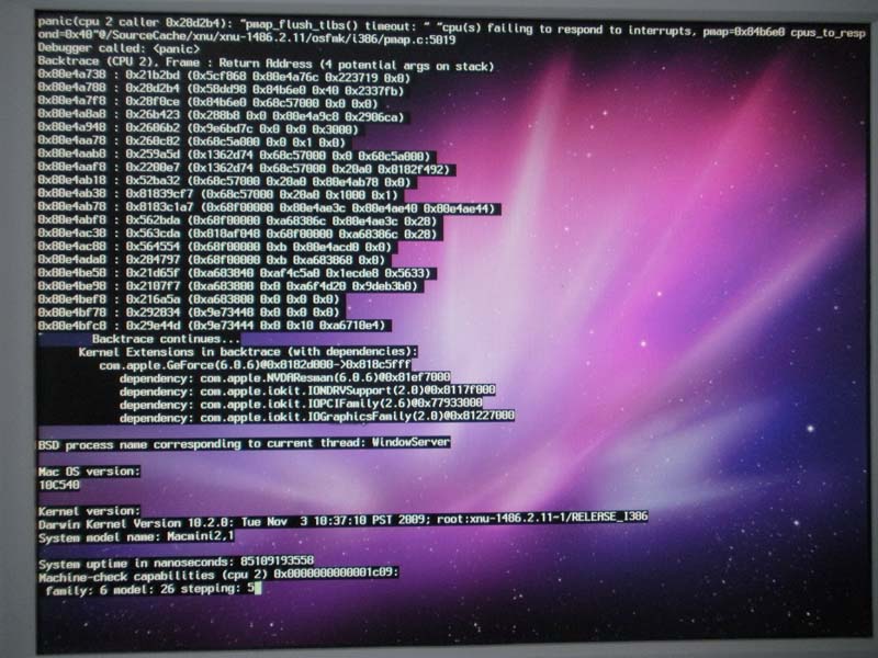

mrhiyuck Posted December 28, 2009 Share Posted December 28, 2009 I can't get this to work. I have a Gigabyte GA-EX58-UD5 at 10.6.2 and it doesn't recognize the card by default. I installed the the atheros fix - nothing. I also installed the IO80211Family.kext and then it sees the card. It seems fine but when I connect to our network I get a kernel panic. Any suggestions? The router is a linksys WRT54G. I would think it would be OK, but connecting gives the panics, so... Link to comment https://www.insanelymac.com/forum/topic/201024-tp-link-tl-wn951n-with-snow-leopard-working/page/2/#findComment-1370900 Share on other sites More sharing options...
Jursis Posted December 28, 2009 Author Share Posted December 28, 2009 I can't get this to work. I have a Gigabyte GA-EX58-UD5 at 10.6.2 and it doesn't recognize the card by default. I installed the the atheros fix - nothing. I also installed the IO80211Family.kext and then it sees the card. It seems fine but when I connect to our network I get a kernel panic. Any suggestions? The router is a linksys WRT54G. I would think it would be OK, but connecting gives the panics, so... errmm.. can you say what error you getting with KP boot with debug=0x100 and take photo of your kernel panic Link to comment https://www.insanelymac.com/forum/topic/201024-tp-link-tl-wn951n-with-snow-leopard-working/page/2/#findComment-1370907 Share on other sites More sharing options...
mrhiyuck Posted December 28, 2009 Share Posted December 28, 2009 Sorry for the delay... tried fixing it and needed work to find the card again. Here is the picture of the panic. Link to comment https://www.insanelymac.com/forum/topic/201024-tp-link-tl-wn951n-with-snow-leopard-working/page/2/#findComment-1370941 Share on other sites More sharing options...
Jursis Posted December 29, 2009 Author Share Posted December 29, 2009 Sorry for the delay... tried fixing it and needed work to find the card again. Here is the picture of the panic. ok .. looks like some problem with pci, but not sure. try to put your card in different pci slot if possible. Link to comment https://www.insanelymac.com/forum/topic/201024-tp-link-tl-wn951n-with-snow-leopard-working/page/2/#findComment-1371308 Share on other sites More sharing options...
mrhiyuck Posted December 29, 2009 Share Posted December 29, 2009 So very frustrating... I tried to switch PCI slots, with no result. I've tried a reinstall with nothing but the two kexts listed above, and that is no help as well. The moment I try to connect to the network it panics. I used myHack installer... would that matter? Other then that, I can think of no hindrance to the airport card other then the motherboard. Any ideas? Link to comment https://www.insanelymac.com/forum/topic/201024-tp-link-tl-wn951n-with-snow-leopard-working/page/2/#findComment-1371423 Share on other sites More sharing options...
