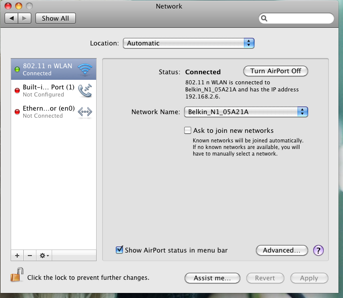

Jursis Posted December 5, 2009 Share Posted December 5, 2009 Hello guys! I just got this card in the morning TL-WN951N And it's working perfectly with Snow Leopard 10.6.2! This wifi card works OOTB with 32bit Snow Leopard. Thanks to mm67 for help -------------------------------------- 32bit ONLY Ok so to make it working follow this easy guide: 1. Install card in your computer (easy yeah?) 64Bit To make this card working in 64bit you need to have AtherosFix.kext installed. This kext has TL-WN951N id in it, so just put it in E/E and run Kext Utility AtherosFix.kext with TL-WN951N id in it. i5/i7 CPUs it seems any i5/i7 hackintosh gets kernel panics with PCI based atheros ethernet devices. I have a dlink DWA547 and it does the exact same thing. The same hardware and system disk did not KP when it was running with a P45 chipset and E8400 processor. Upgraded to an i7 and now it crashes. Setting Hyperthreading off and CPUS=1 stops it crashing but screws performance. Suspect we need 10.6.3 to fix it as the i7 iMacs have a different build of OSX than 10.6.2 If this doesn't work for you, try this: OK I got this to work in 64 bit with 10.6.1 In addition to the AtherosFix.kext I also needed to use a new IO80211Family.kext which was posted by himac59 over in the "Snow Leopard + DWA 552/556" thread. With the (Netkas) Atheros21, 32/64bits, see www.netkas.com its from beta 10.6.2 IO80211Family.kext Once these two were installed my card was recognized and I was able to configure it in the network preferences. I apologize if I didn't post and credit properly but this actually works and I can get rid of my Edimax USB adapter that kept on disconnecting. Thanks to rotkiv. -------------------------------------- Good luck! AtherosFix.kext.zip Link to comment https://www.insanelymac.com/forum/topic/201024-tp-link-tl-wn951n-with-snow-leopard-working/ Share on other sites More sharing options...

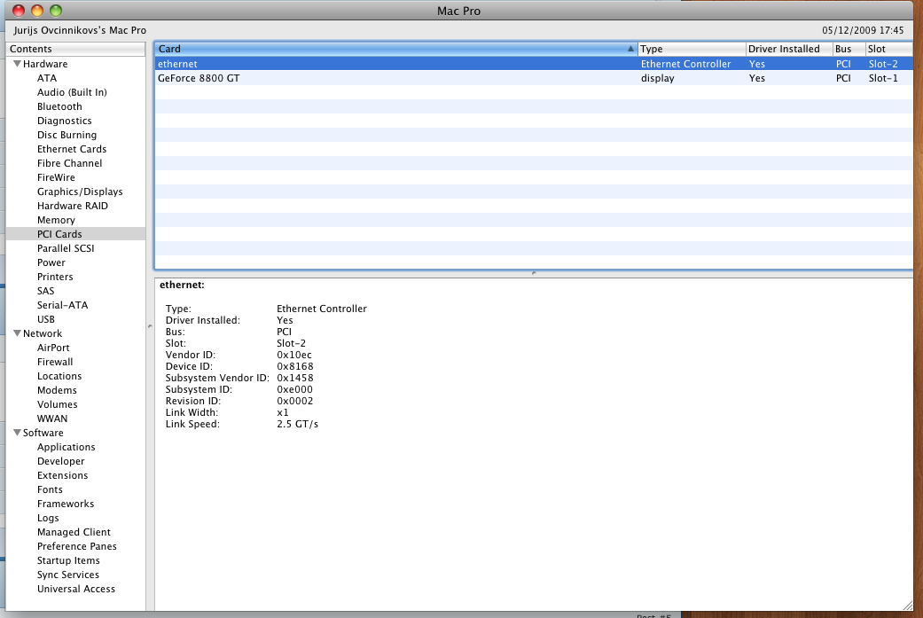

jinnggoff Posted December 5, 2009 Share Posted December 5, 2009 Add this <string>pci10ec,8168</string> here: Are you sure add that divece id?, coz thats seems like realtek ethernet device Link to comment https://www.insanelymac.com/forum/topic/201024-tp-link-tl-wn951n-with-snow-leopard-working/#findComment-1351492 Share on other sites More sharing options...
mm67 Posted December 5, 2009 Share Posted December 5, 2009 I have no idea why one would add Realtek's device-id since this boards device-id is 168c:0023, same as for example Linksys WMP300N ver.2 or D-Link DWA-547. Also the functionality is same, if you use Leopard or SL 32-bit then everything works out of the box. If you want to use SL in 64-bit mode then you can use AtherosFix.kext by Netkas or do that same device-id injection in dsdt like I do. Link to comment https://www.insanelymac.com/forum/topic/201024-tp-link-tl-wn951n-with-snow-leopard-working/#findComment-1351516 Share on other sites More sharing options...

Jursis Posted December 5, 2009 Author Share Posted December 5, 2009 Are you sure add that divece id?, coz thats seems like realtek ethernet device yeah I'm sure. I went to System Profiler PCI Cards and there is id Do you run Snow Leopard in 64-bit mode? It is important for me as I seek to buy a wireless card that works seamlessly in 10.6.x 64-bit As @mm67 said: "If you want to use SL in 64-bit mode then you can use AtherosFix.kext by Netkas" So yeah think should work fine. AtherosFix.kext.zip Link to comment https://www.insanelymac.com/forum/topic/201024-tp-link-tl-wn951n-with-snow-leopard-working/#findComment-1351566 Share on other sites More sharing options...
mm67 Posted December 5, 2009 Share Posted December 5, 2009 yeah I'm sure.I went to System Profiler PCI Cards and there is id Yes, that is your onboard Realtek ethernet Go to ethernet cards in System profiler and you will see also your WLAN card Link to comment https://www.insanelymac.com/forum/topic/201024-tp-link-tl-wn951n-with-snow-leopard-working/#findComment-1351569 Share on other sites More sharing options...
Jursis Posted December 5, 2009 Author Share Posted December 5, 2009 Yes, that is your onboard Realtek ethernet Go to ethernet cards in System profiler and you will see also your WLAN card ohh yeah u right (thanks for poiting that out) but how the f... it's working if I added my onboard card there ? i'm lost... Link to comment https://www.insanelymac.com/forum/topic/201024-tp-link-tl-wn951n-with-snow-leopard-working/#findComment-1351575 Share on other sites More sharing options...
mm67 Posted December 5, 2009 Share Posted December 5, 2009 ohh yeah u right (thanks for poiting that out) but how the f... it's working if I added my onboard card there ? i'm lost... As I said, it works out of the box if you are running 32-bit, you don't need to do anything. What you did do may have made your onboard ethernet non working, if I were you I would be undoing those modifications right now. Link to comment https://www.insanelymac.com/forum/topic/201024-tp-link-tl-wn951n-with-snow-leopard-working/#findComment-1351581 Share on other sites More sharing options...
Jursis Posted December 5, 2009 Author Share Posted December 5, 2009 As I said, it works out of the box if you are running 32-bit, you don't need to do anything. What you did do may have made your onboard ethernet non working, if I were you I would be undoing those modifications right now. yes you was right.. id of my wifi card was already there.. so to make it working in 64bit you need to have AtherosFix.kext with card id in it right? Link to comment https://www.insanelymac.com/forum/topic/201024-tp-link-tl-wn951n-with-snow-leopard-working/#findComment-1351590 Share on other sites More sharing options...
mm67 Posted December 5, 2009 Share Posted December 5, 2009 yes you was right.. id of my wifi card was already there.. so to make it working in 64bit you need to have AtherosFix.kext with card id in it right? Yes, that is how it works. Link to comment https://www.insanelymac.com/forum/topic/201024-tp-link-tl-wn951n-with-snow-leopard-working/#findComment-1351602 Share on other sites More sharing options...

Jursis Posted December 5, 2009 Author Share Posted December 5, 2009 @ jursis: How should you evaluate this card? Would you recommend it? I know you only very recently have it, but do you notice speed drops, packet loss, disconnections? (I'm having severe ones with the Asus Wl-138g) i know that i just got it today, but can say everything is rock solid works on Mac , windows seven. was playing MW2 just, everything is fine. Can recommend you to get this card Link to comment https://www.insanelymac.com/forum/topic/201024-tp-link-tl-wn951n-with-snow-leopard-working/#findComment-1351763 Share on other sites More sharing options...
LH418 Posted December 6, 2009 Share Posted December 6, 2009 I got that card too since Dec 2nd. I can only second Jursis. That card is running like a dream. Under Mac OS, and under Windows 7. It's a cheap, good working card ... so don't hesitate to buy it By the way ... TP-LINK products are quite good ... already got a USB WLAN stick and a router from them ... never had any probs with these items Link to comment https://www.insanelymac.com/forum/topic/201024-tp-link-tl-wn951n-with-snow-leopard-working/#findComment-1352524 Share on other sites More sharing options...
