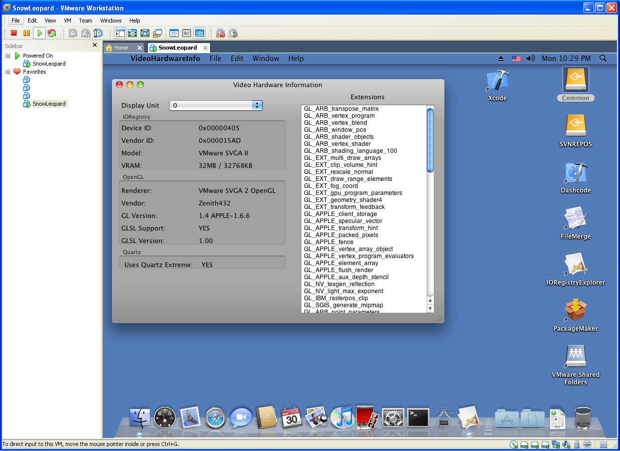

Just to clarify, the status is still work in progress. You guys have no idea how hard it was just to get the WindowServer to complete the initialization sequence for QE. There are still an unknown number of functions that have to be implemented before I can incorporate this into a production driver. I'm surprised the screen is not completely blank at the current stage. I think that menu bar is supposed to be semi-transparent, not fully-transparent :-) I can't get System Preferences to change background image.
This only works on Snowy for now as well. It needs to be adapted back to Leopard because Apple made changes between the two.
To summarize - lots of work still left to do.

FYI, I've resumed work on the OpenGL support in VMsvga2, and I've got VLC video player and Preview [OS 10.6 variant] working. [both these Apps require a hardware GL driver].

  8. The WindowServer's GLCompositor (aka QuartzExtreme) - not even close. The screen is all-black. It's also quite a stress test, as it creates about 50 textures right off the bat. The system responds to keystrokes and mouse clicks, so it can be shut down safely if you know the sequence. QE also uses a couple of untested texture types, and whatnot. A lot of work still to do for that.

  • "-vmw_qe" enables QuartzExtreme. QE doesn't work, but if you want to see for yourself :D
This driver is still a work in progress. There are many unimplemented GL features - FBOs, pipeline fences, mipmapping, cube-maps, volume textures, fog, misc render states, pixel shaders, etc. If an application attempts to use them, it may fail in part or in whole. The driver hasn't been fully optimized yet either, so some things don't work as efficiently as they can be made to.
