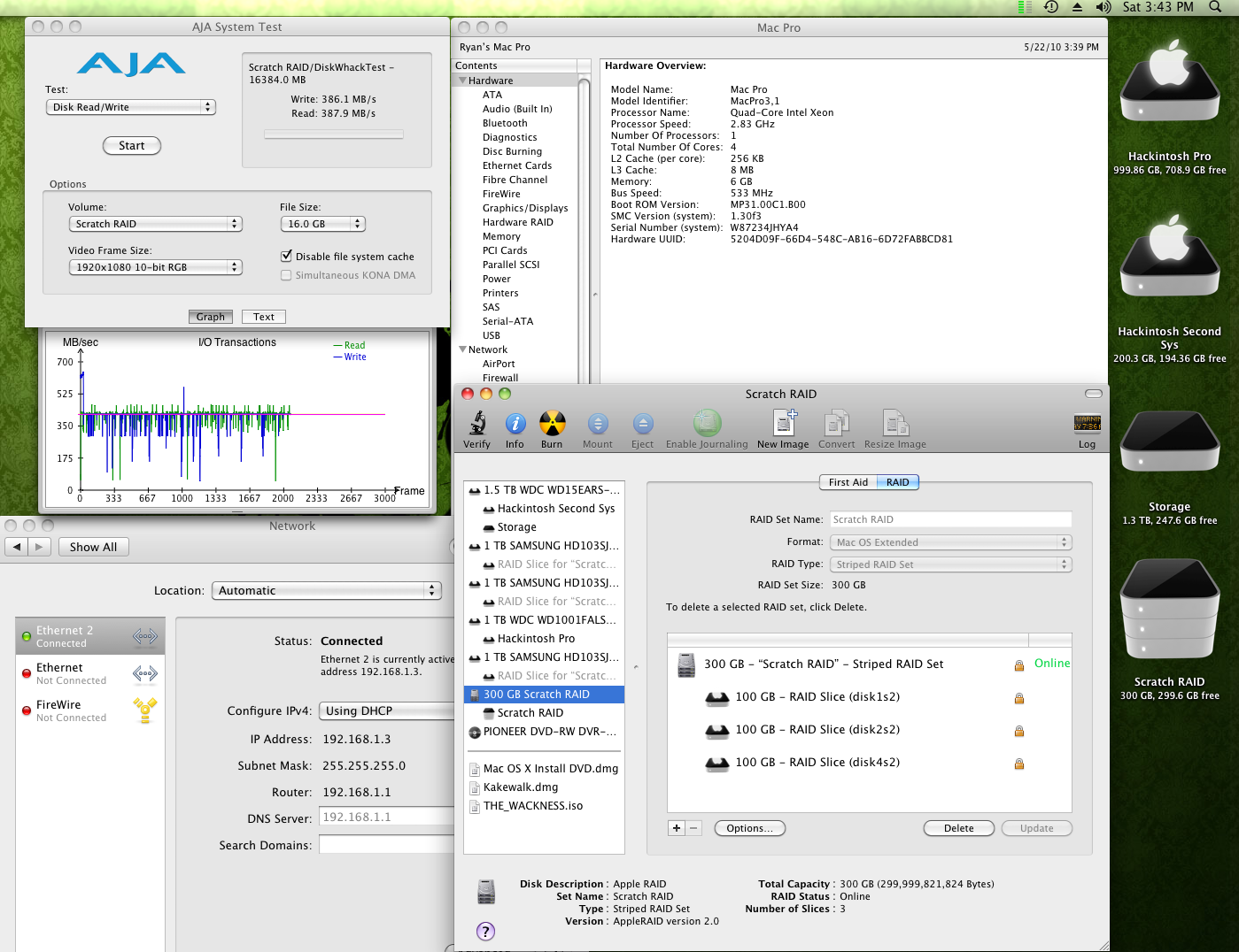

I finally finished my Hackintosh build and wanted to share the specs with the thread. It's built as a low-mid-budget, high-powered Photoshop machine. I think the final cost was under $1600 (not including failed wireless network attempts). My goal was to have a well-ventilated machine for handling >200GB of Photoshop scratch in a 64-bit MAC OS-X environment for Photoshop CS5 and going online and watching HD movies... and I wanted to do it easily without a lot of hacking. I can now work on >60GB files with no lag whatsoever, browse the web thru my apartment's wireless-n router, and play HD video all at the same time on 2 monitors (I was given the Viewsonic monitor a couple years ago from a friend and it's not in the best shape but works for a utility monitor, so I did not include that in my estimate).
Specs are in my signature, but I've posted screenshot that should give you a pretty good overview. I can't run ethernet cable in my apartment, so I use an ethernet to wireless-n gaming adapter. Sound works perfect, HD Video hardly taxes the system, and I can play it on my second monitor while Photoshopping on the primary or vice versa. And the shining jewel, 386 MB/s Up/Down large-file throughput for my Photoshop scratch and the hard drives stay a chilly 28-30 degrees Centigrade...
