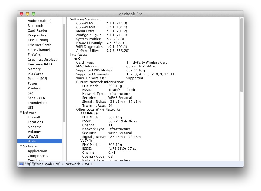

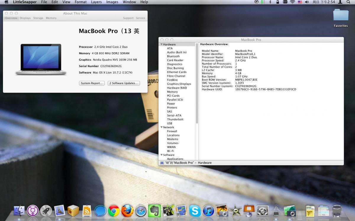

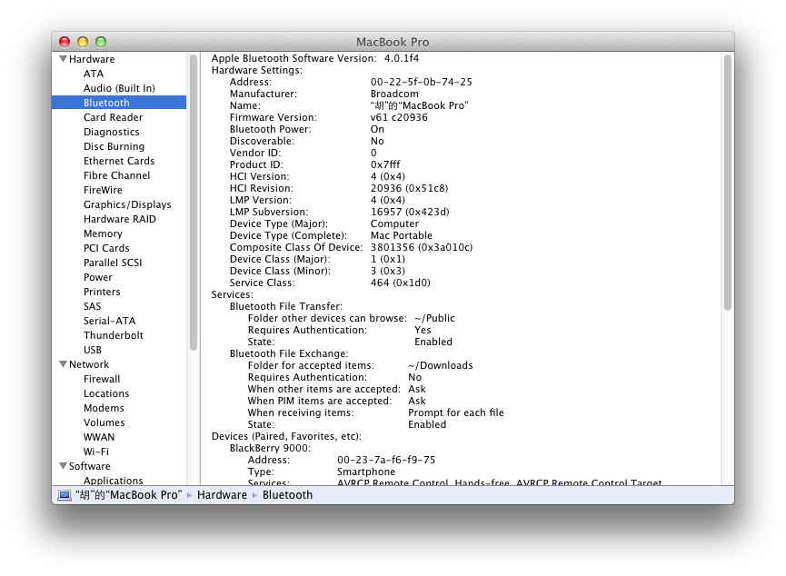

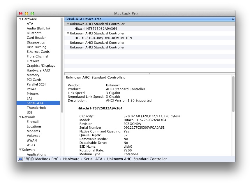

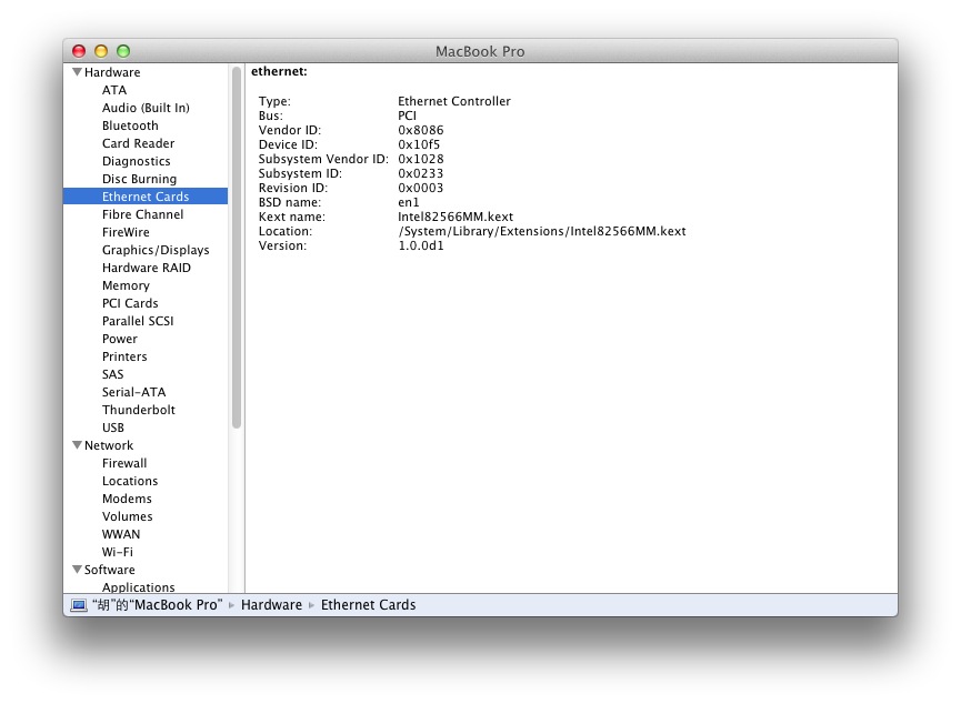

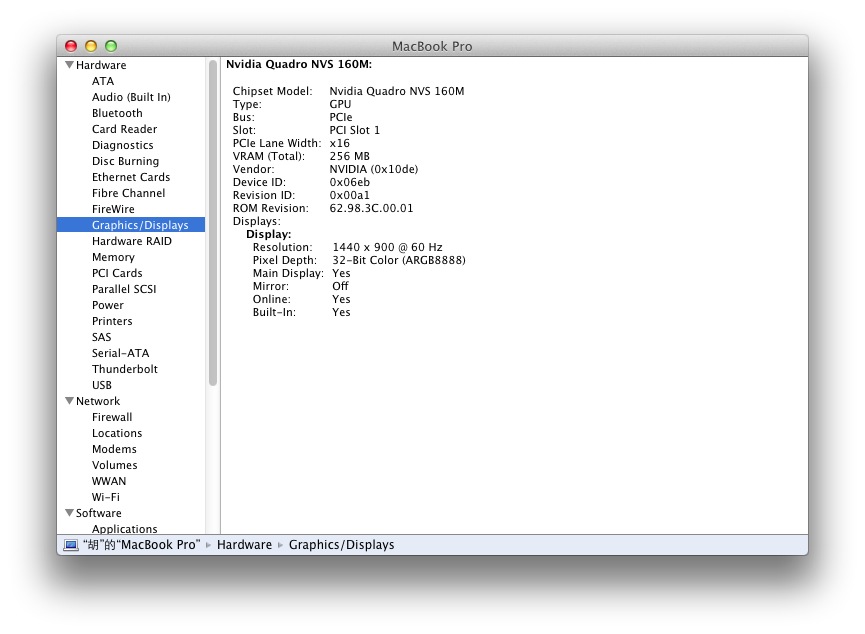

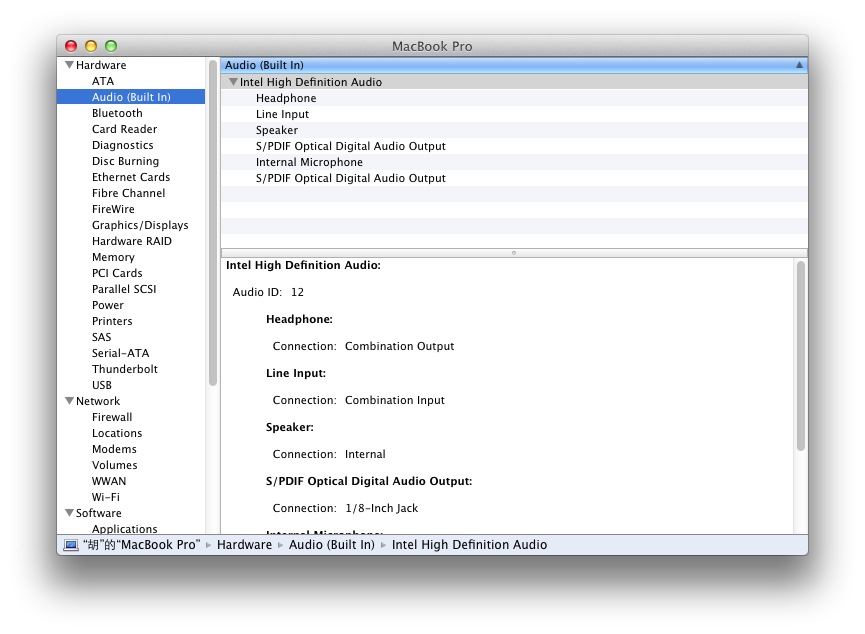

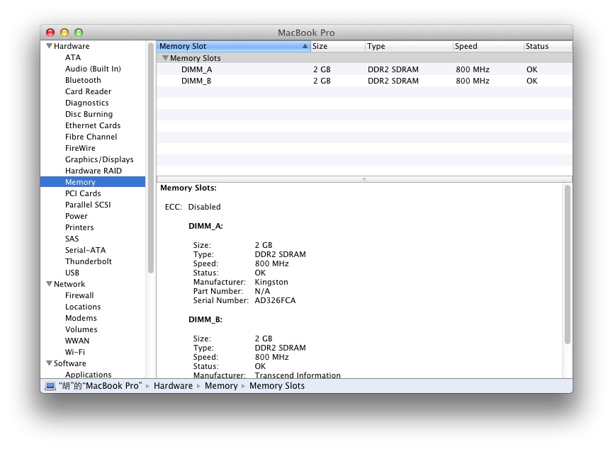

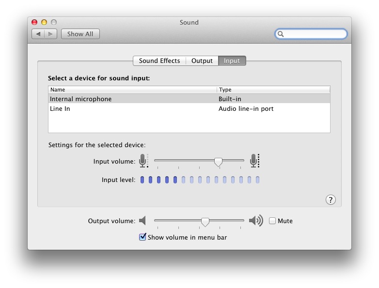

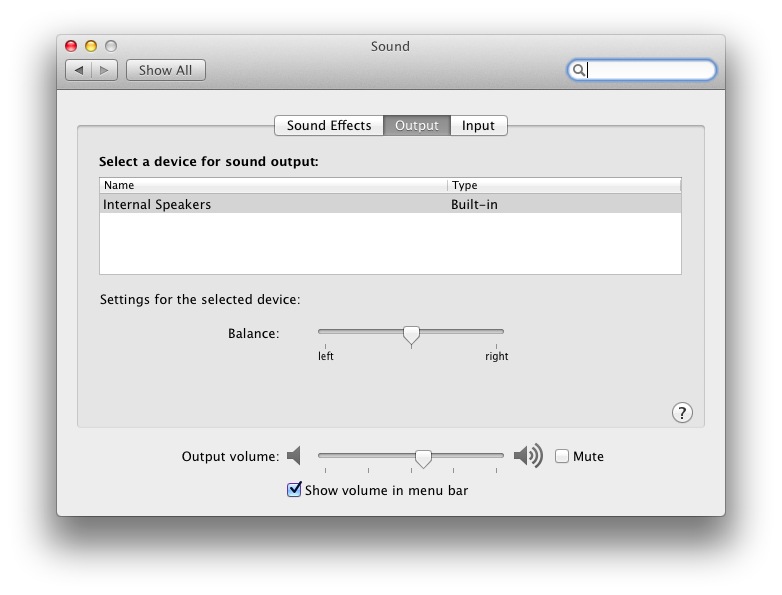

jackhu Posted February 12, 2012 Share Posted February 12, 2012 Hi guys,I think I've been able to get most of my E6400's hardwares working normally on Lion 10.7.2,and I've attached some fresh snapshots. 1 Link to comment https://www.insanelymac.com/forum/topic/194738-installguide-snow-leopard-on-dell-e6500e6400-in-8-simple-steps-dual-boot-windows-7-instruction-included/page/7/#findComment-1795383 Share on other sites More sharing options...
jar50972 Posted February 13, 2012 Share Posted February 13, 2012 Hi guys,I think I've been able to get most of my E6400's hardwares working normally on Lion 10.7.2,and I've attached some fresh snapshots. Amazing! Can you please help me if you have anytime. I have a fresh, untouched SNow Leopard 10.6.3 install. Link to comment https://www.insanelymac.com/forum/topic/194738-installguide-snow-leopard-on-dell-e6500e6400-in-8-simple-steps-dual-boot-windows-7-instruction-included/page/7/#findComment-1795771 Share on other sites More sharing options...
