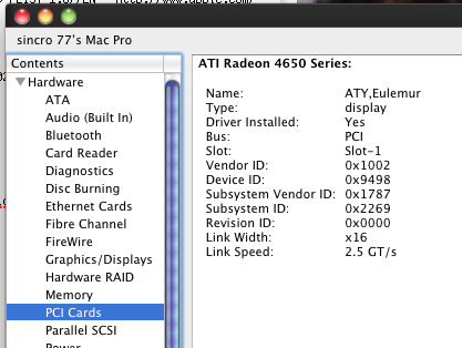

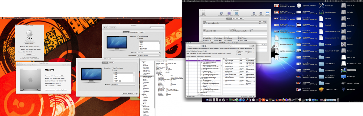

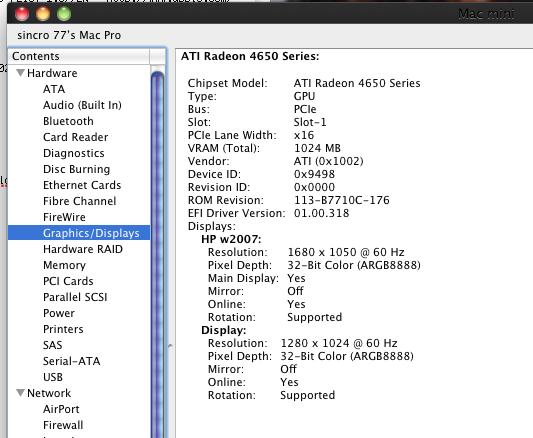

Guest sincro77 Posted March 25, 2011 Share Posted March 25, 2011 I *FINALLY* got my 4650 card working - QE/CI, resolution change, DVI/HDMI out... (well, only 1 port, but still!) Hope this helps somebody else: I added the card id (9498) to 4600Controller and X2000 - but the real trick was changing the framebuffer.... I used the current trunk of Chameleon, and changed the framebuffer to Flicker: { 0x10029498, "Flicker"} "MotMot" *kinda* worked - but I had to have 2 monitors plugged in, one to each DVI port, and even then only ONE worked, and no QE/CI.... I attached my boot file - don't forget GraphicsEnabler = Y -tronax This card has been totally solved. ) sincro77**** see post # 111.. cheers everybody..im using lion 10.7....yeehaw....uh huh uh huh !!!! Link to comment https://www.insanelymac.com/forum/topic/190288-ati-radeon-hd-4650-any-support-qeci/page/5/#findComment-1660633 Share on other sites More sharing options...

Guest sincro77 Posted March 29, 2011 Share Posted March 29, 2011 I couldnt say for sure.. my card is 1024 mb dual dvi and svid.. basically you just sudo re-edit the x2000 and radeon4600 kext info plist (desktop edit) to add your particular devide and vendor id.. install..repair perms.. reboot. use correct settings in boot.plist. ( graphics enabler =yes) use chameleon rc5 629 and it will boot dual screens with eulemur FB. other distros gave me Peregrine and Motmot or wouldnt work with chamrc5629 so i installed iatkos 10.6.3 and updated to 10.6.6. (AMD users DoNT update to 10.6.7yet..)we need a new kernel first) this card is solved on my end. I hope your 512 works similarly. cheers sincro77 **update** I have Lion osx 10.7 fully working now. Everything working including wireless on an ASUS p5wdh deluxe. 1 thing.. except it sees my 4 gig ram as 2 in activity monitor. but 4 in profiler....???? I have not tryed it yet due to i got a different video card but im thinking about building a second computer and using my ati 4650 512mb so sincro77 will your fix work on my card as well or just the 1gig version Link to comment https://www.insanelymac.com/forum/topic/190288-ati-radeon-hd-4650-any-support-qeci/page/5/#findComment-1662889 Share on other sites More sharing options...

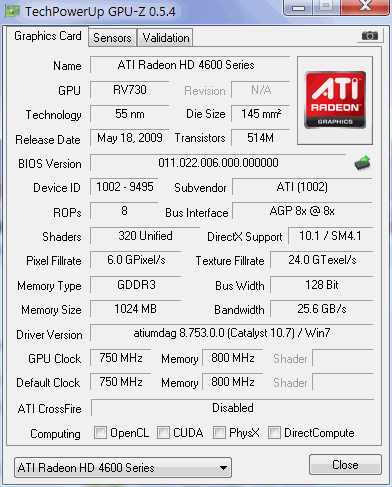

RobertX Posted August 18, 2011 Share Posted August 18, 2011 ...hi...HIS4670 IceQ 1GB DDR3 AGP(device id:9495 vendor id:1002) like the other agp poster....having issues here...i can reach desktop only if ATI4600Controller.kext doesn't load(no QE no res change no gfx acceleration) (added id to this kext and ATIx2000.kext) output ports from motherboard out are DVI-VGA-HDMI... ...different boot files tried/failed....ATY_Init.kext...EVoEnabler.kext...even ATIinject.kext...some combos of these resulted in black screen but active system...others give me light pink or white screen with vertical black lines....some just lock me up. Using 10.6.8 with Legacy_kernel modded by AndyV...smbios file for IMac11.1...also have a smbios file for macPro 3.1(this one does not invoke AppleGraphicsPowerManagement)on a P4P8X ASUS M/B(Prescott CPU) 8x AGP...hmmm...been from here to netkas to tonymacs to infinitemacos....not one working AGP Radeon HD4670...hoping to be the first...any hints?...leave them here....i'm off to read some more.... PS: i've had some success with 10.6.8 and video cards(x1600Pro AGP, x1650Pro AGP, and even a {censored} EVGA PCI 9400GT ...i'm no quitter... Link to comment https://www.insanelymac.com/forum/topic/190288-ati-radeon-hd-4650-any-support-qeci/page/5/#findComment-1736748 Share on other sites More sharing options...
