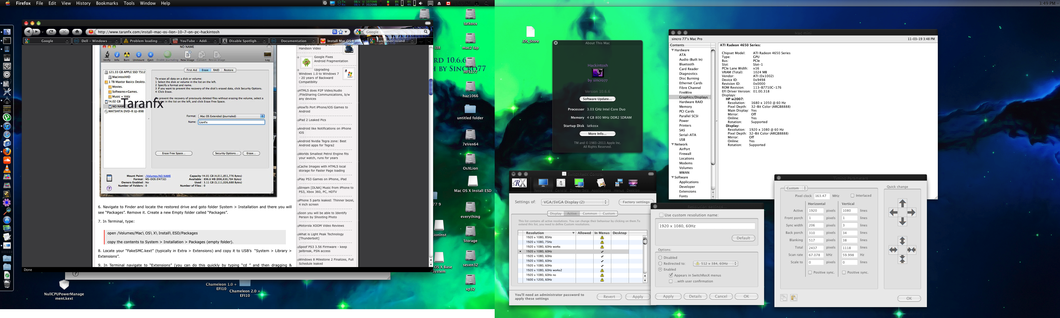

Guest sincro77 Posted March 19, 2011 Share Posted March 19, 2011 4650 SOLVED!!!!!!!!! check OUT the screenshot. screen1 1680x1050 screen2 1920x1080 qe ci. spanned.. using "secondbar" app. also Eulemur framebuffer. Cham rc5 629. patched DSDT ALC662 fully working with all ports in/out etc but as a 2 channel stereo device. also installed an audigy and use kx drivers 5.1 out ..sweeeet. on a ASUS m2n68-am plus AMDx2 5400+ \oc RAm/ clocking 3.2 using 13.5x238 bus/// 4gigz memory is 800 running at 933mhz/. not bAD 4650 windows users should use"amd gpu clock tool" and the settings 648 mhz and 504 mhz to oc this card and get another 15 -20 fps from it .. its very usable for its cost on the market.. it often still surprizes me. RESswitchX !!!!!! sincro77 look 3600x1080 mwhaaaahaaaahaaaaahahahahaaahaaaaaaa haa. Link to comment https://www.insanelymac.com/forum/topic/190288-ati-radeon-hd-4650-any-support-qeci/page/4/#findComment-1657707 Share on other sites More sharing options...
